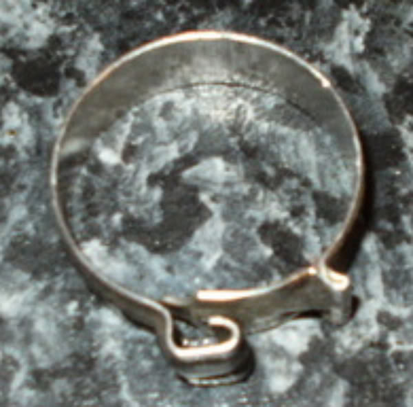

No, not a jubilee clip unfortunately but a big, strong and springy version of the crimp clip you find on rubber hoses all over the engine bay :( They are a pain and in fact, a repair replacement with screw clamps are available that look like mini exhaust clamps.
I normally use a long hard pointed scriber to spring them apart. The trick is to get the point in under the crimp, and lever up so that the clip pops apart. hard to explain but have a practice on a smaller version. I have a handy pair of pliers that look like a miniture version of a chippies nail removing pincers that works well to refit them.
To make a removal tool, get an old and otherwise useless long screwdriver and grind the end down to a tapering point.
As they say, a picture is worth a thousand words:
This shows where to insert the point of the tool and then you need to lift up and push sideways to pop the clip apart.

The hook clips over the knuckle when compressed. The knuckle has another lip (not seen) that aids the grasp. These are widely by Citroen (at least on the Xantia) but often replaced with jubilee clips for obvious reasons.
I've tried compressing these to aid releasing but they are generally already under full compression when locked. I did have some success using a thin long screwdriver and levering the gap in the hook, usually both sides need to be worked and forced up. The easiest method I have discovered is to insert one of the jaws of a pair of thin-nosed pliers straight into the hook gap and lever the hook up and off.
The EGR clips are slightly different than the above but the grasp is the same mechanism. The lack of access means I cannot get any leverage on the hook, even if I can get a purchase intially. A friend offered to break them off which I declined.... for now. :lol:

MikeT wrote:The EGR clips are slightly different than the above but the grasp is the same mechanism. The lack of access means I cannot get any leverage on the hook
That's it Mike. The difference is there is a "pip" on the EGR clip that locks the tab (which becomes a bent fork) when it is bent over. You can just see it in my picture. This is the reason for both needing to lift and push sideways at the same time in order to release them.
There is no harm in tapping the removal tool with a small hammer to help them apart. You won't damage either the EGR valve or the inlet manifold in doing so. Just a small hammer though :wink:

citrojim wrote: You can just see it in my picture.
Ok, where can I see your picture Jim?
citrojim wrote: There is no harm in tapping the removal tool with a small hammer to help them apart. You won't damage either the EGR valve or the inlet manifold in doing so. Just a small hammer though :wink:
I'm more worried about damaging the clip though - tight arse git I am, I doubt they can be replaced with a jubilee, I'd need to buy OEM? However, I'd sooner altogether not have to replace any of the EGR components!

Quite, a Jubilee clip won't do as it needs to be shaped to fit the cones on the EGR valve body and inlet manifold.
MikeT wrote:Ok, where can I see your picture Jim?
In the post immediately above your picture of a clip Mike :roll: Look slightly to the left of where the scriber is inserted and you'll see the little "pip" on the face of the hooked part of the clip.

citrojim wrote:Quite, a Jubilee clip won't do as it needs to be shaped to fit the cones on the EGR valve body and inlet manifold.
It wasn't there when I backtracked in case I missed it. Wasn't there when I posted my reply either, and even just now it wasn't viewable so I backtracked to the previous page - nope. Returned to reply and it downloaded! Right above my post :lol: I've not gone completely mad just yet! :wink:

MikeT wrote:Image
i find either a pair of side cuters, or what i have recently found is a pair of LIDLS nail pinchers which i have ground the inside faces of the jaws down,
so they get under the edge of the hook,
they also work on refitting

citronut wrote:i find either a pair of side cuters
I have a pair of those, I'll give them a try. Thanks Malcolm

Seeing as the engine bay is full of them I bought a set of the proper pliers from Halfords, they weren't any dearer than the indies.
Laser toos make them - http://www.lasertools.co.uk/item.aspx?item=756&cat=0

steelcityuk wrote:Seeing as the engine bay is full of them I bought a set of the proper pliers from Halfords, they weren't any dearer than the indies.
Steve.
They look like pliers for the spring clips (which are easily managed with mole grips), not for these clips in the pictures - though they probably would allow you to remove them. I suspect Citroen made a special tool because the clips are just as awkward to put back on, especially if they're large like those leak-off return pipe clamps on the hydraulic rams

Unread post by steelcityuk »
Definately the right tool for the job. The jaws are different sizes which means you need to get them the right way around depending on whether you are removing or refitting the clip. They saved me a lot of cursing whilst working on the 2.1 and 2.5. What you can't see in the picture is the notch cut out of the 'blades' which allow the pliers to sit snugly either side of the ridge on the EGR clip.
Steve.
