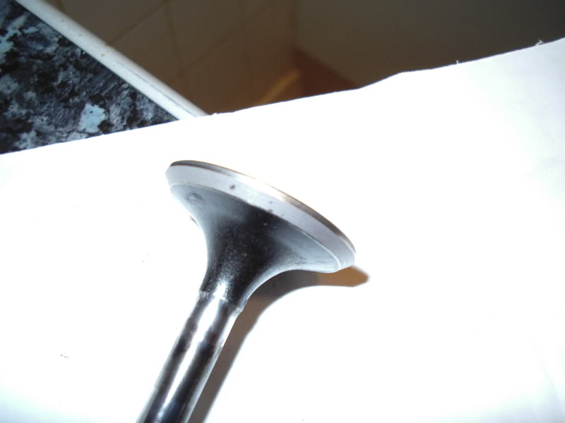

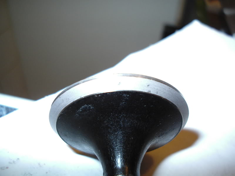

Eventually got round to cleaning the valves - tried the lazy route first - soaking in solvents which worked fine for all the exhaust valves and allowed two of the inlet valves to be wire-brushed clean but #'s 5 & 8 needed a chisel and a lot of forceful but careful scraping. Thankfully, none of them are burnt, though there are some discolourations on the undersides as well as some tiny pits on all the sealing faces (where the deposits were) as well as a few minute dents/distortions on the very edges of the piston side seat margin. One exhaust valve even has two small chunks missing from the edge of the centre "bunker" of the underside, if you know where I mean? Hopefully a light lapping should be adequate but it won't remove all the pitting for sure.

I relented and sent the head to a machine shop where it got a ~10 thou shave. I'm not overly impressed to be honest but at least it's flatter and cleaner than before and the prechamber cracks have gone too. :lol:
I'm now in the process of valve lapping. Just a minute or two of light lapping with the fine paste. Here's one I done earlier.

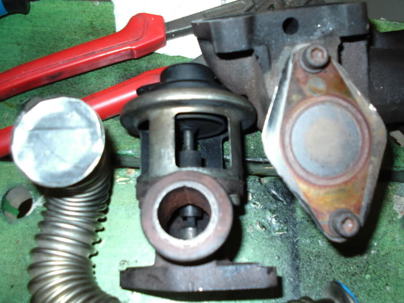

The EGR will blanked off as per John's (jgra) blog using sheet steel plates. Just as well, as it appears the valve wasn't seating fully allowing gases to pass at all times :roll: I've also added a temperature probe as a tuning aid should I eventually get this engine back together.

Thanks to jgra for this idea, I've fabricated sheet steel plates to ensure no exhaust gases enter the inlet nor boost pressure escaping to the exhaust as would have been the case with my leaking EGR. I'll also be diverting the breather so no oil mist enters the inlet either.

Mike,
Think of all those nasty Oxides of Nitrogen you are ejecting into the atmosphere through your deliberate disablement of the very fine EGR system on your engine :twisted:
Have you no feelings at all for this poor old planet of ours?
I tell you, as a result of this, there'll be acid rain fairly pouring it down in Christchurch. Trees will wilt, buildings will dissolve and all because you disabled your EGR.
Shame on you :twisted: :twisted:
(now were is the emoticon for tongue in cheek?) :roll: :?
Seriously Mike, good work :D I really must get round to disabling it on my 2.1. Sometimes I can actually hear the EGR valve fluttering :shock:
