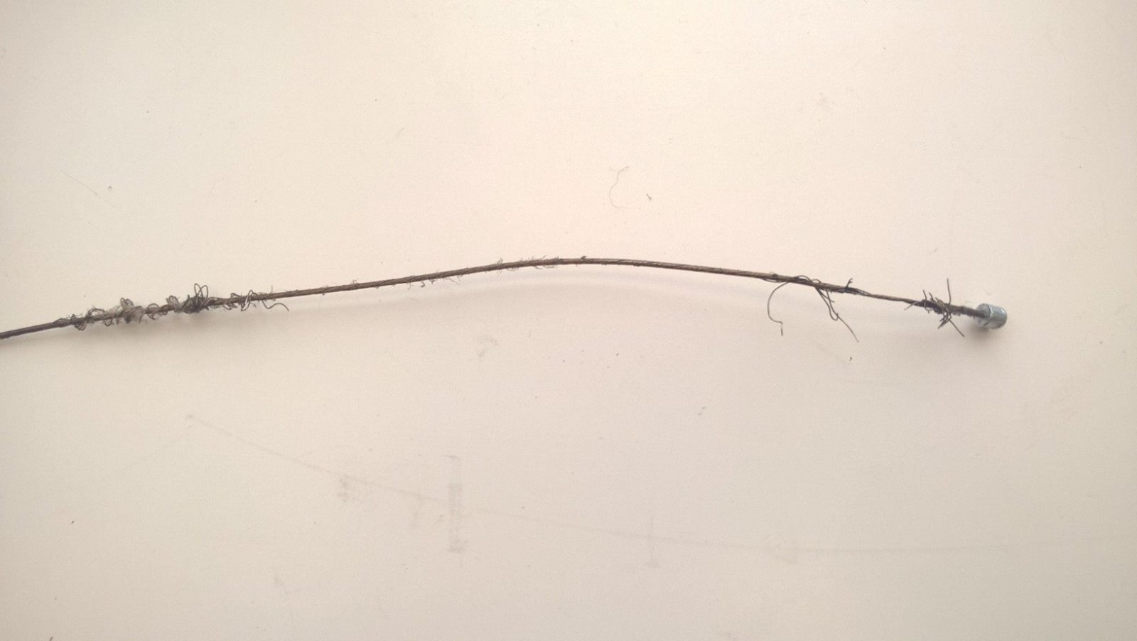

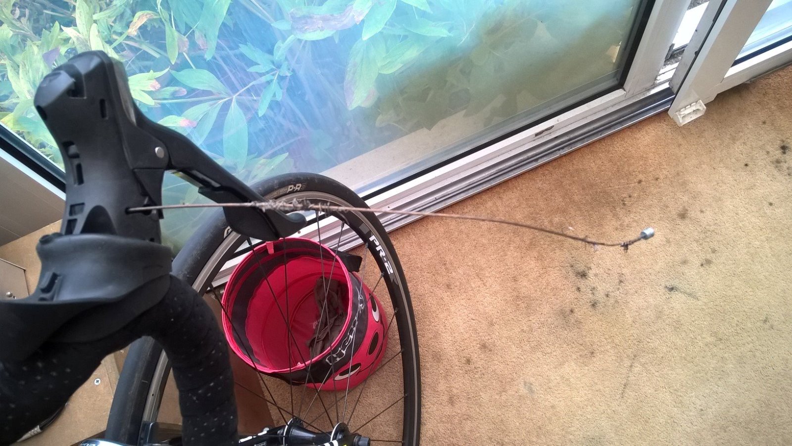

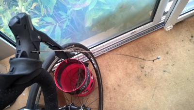

Had an interesting 'mechanical' on my daily rider bike the other day...
The gear selection on the rear derailleur was becoming rather vague and woolly and in the end I could only get 9 of the 11 gears on offer...
Investigations revealed a very work and frayed selector cable at the shifter end...
This is allegedly a common problem on Ultegra systems and is blamed on the tight radii the cable takes to get to the shifter selector drum.
Cable replaced and the gearchange is now transformed...
The replacement was not easy as the majority of the cable runs inside the frame and some clever 'fishing' is needed...
The pictures show how badly the old cable had gone. It had almost failed...
Own Work
Own Work
Own Work
Own Work
Good job I caught it when I did as had that happened out on the road I'd have been reduced to one gear - top gear!
