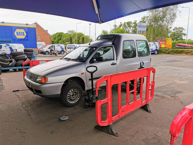

Turn of the Caddy for some TLC today, albeit just a bit of standard stuff.

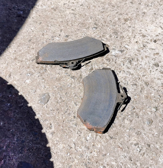

Just getting the tyres rotated. For less than £20 it's just not worth the hassle of hauling the jack, axle stands and torque wrench (once I've found it) out of the garage. Wheel alignment was checked while I was there as there's still some what to my mind is excessive wear on the shoulders of the front tyres. It was definitely out, albeit not massively.
We noted while the wheels were off that the brake pads are pretty much toast so will get those swapped out shortly.

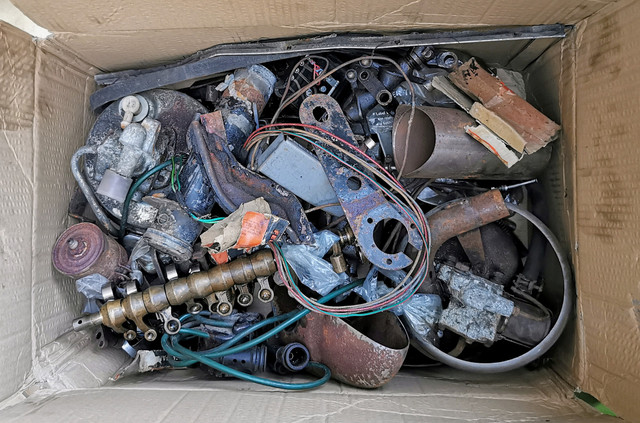

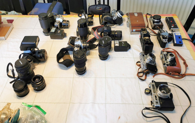

In other news, remember I mentioned a while ago I'd been given a bunch of old cameras, well here's what approximately 30kg of cameras looks like!
Probably nothing massively valuable there but looking forward to properly investigating it all when I get time. The fact that they won't just end up sitting in a box or on a shelf for the next 30 years.

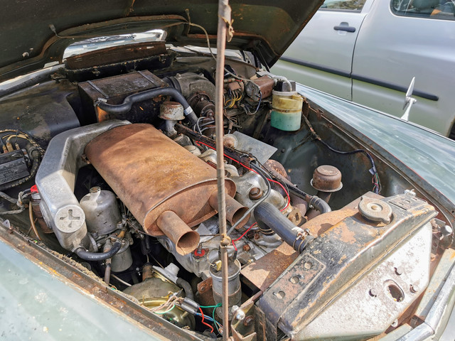

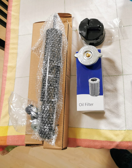

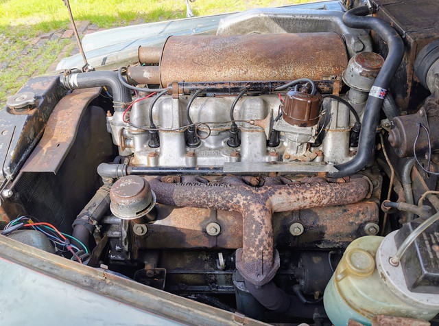

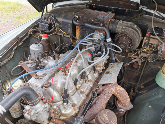

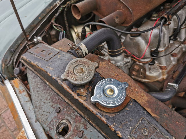

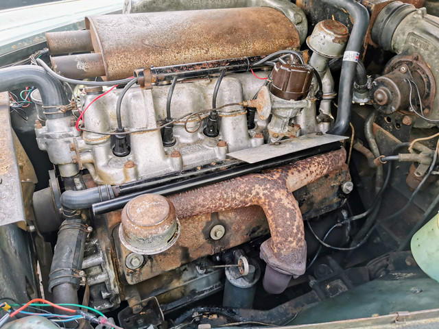

An absolutely huge box arrived this morning containing the gasket set for the Rover, so time to have a look at getting the inlet valve cover gasket swapped out.
Step one, get this lot out the way.
This vastly improves access in general.

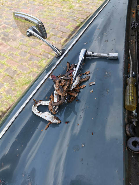

I then made "A Discovery."
Whoever fitted this gasket apparently felt the need to use some form of sealant between the head and the gasket. Fair enough, but what they apparently used was blue Loctite. This had essentially welded the gasket to the head. Nearly three hours later I had *most* of it removed.
If I ever come across who fitted that gasket, I would like to make them *eat* the remains of it. That should have been a 20 minute job.
It was definitely the source of A leak though - the entire section along the rear of the head literally wasn't in contact with anything at all - it was just sticking out the back. So definitely the source of at least one of our leaks.

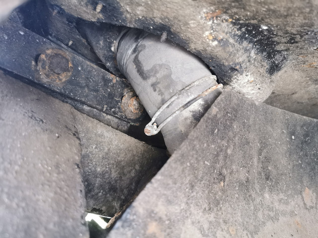

While I had things already partly stripped down and the weather was pleasant it seemed a good idea to swap the remaining coolant hoses. I'm planning to take this along to ConFuzzled at the weekend, so that's an hour's drive into Birmingham. Would be nice to have confidence in the cooling system for that run.

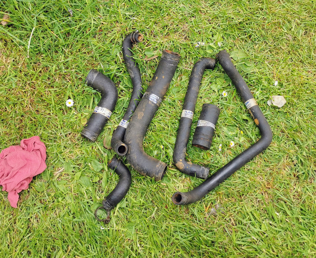

The original lines were quite crusty.
Though after 60 years, I don't think they owe us anything. I'm sure the replacements will have long turned to dust after that long. With the exception of two I had to change due to the new hoses being thicker, all of the original hose clips were reused as they came undone like they were put in place yesterday - and plainly are still fit for service.
Couple of hours later this lot had been evicted.
This one was moderately fiddly because of the position of the brake servo.
Though the winner of the award for causing the greatest contribution to the swear jar of the day went to the bottom radiator hose. Specifically trying to get the new hose onto the stub on the radiator.

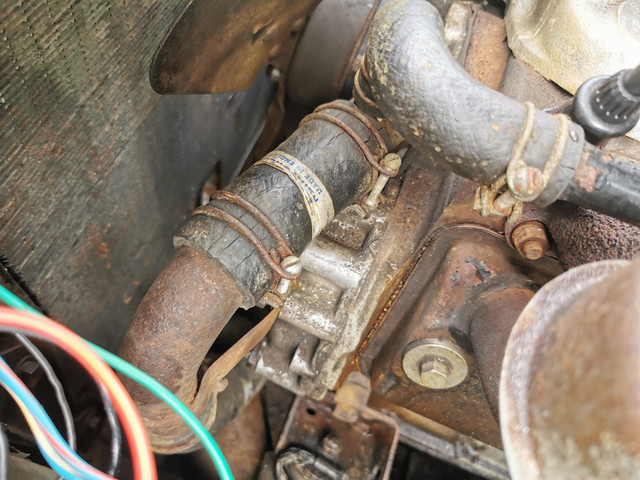

This involved a solid half hour of increasingly vocal swearing as the new hose is quite a snug fit. It's a long way down to the bottom of this engine bay so you can only use one hand, and are working right at the limit of your reach. All the while basically with your face buried in the top of the radiator and the fan trying to cut you to ribbons. Fun!

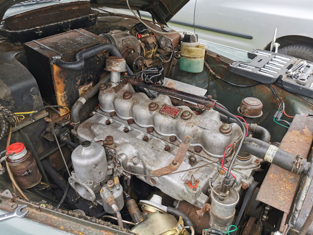

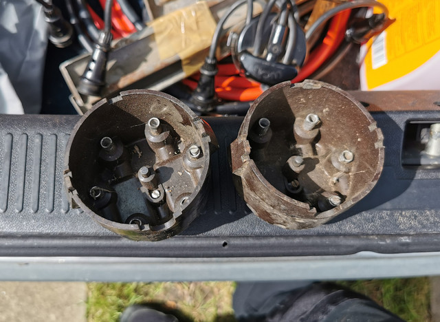

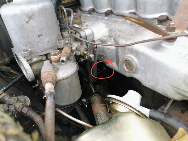

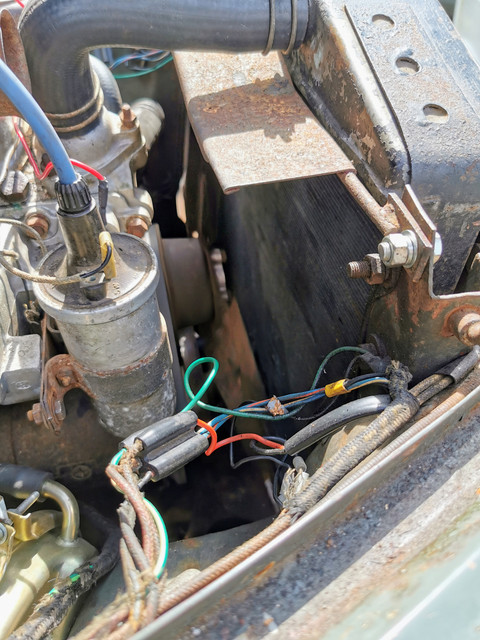

Progress then paused as I went to start her up to bleed the cooling system and she wasn't interested. A quick check soon revealed the cause.
Yeah...there's a distinct lack of centre post there. Which surprises me as she was running fine when parked up. I'm *hoping* this has just fatigued from the cap having been on and off so much lately. So I chucked on the modern cap and leads for testing.
Which also took me ten minutes to sort as I initially had the rotation direction wrong so had fouled up the firing order. My ears stopped ringing from the resulting backfire after about an hour.
I then had an abrupt reminder of something.
Mechanical cooling fans are purpose made to demonstrate to you exactly how much coolant you spilled over the radiator when changing the hoses by finely atomising it and blasting it in your face the first time you bring the engine off idle.

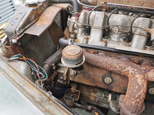

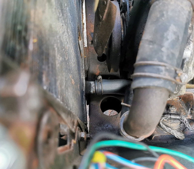

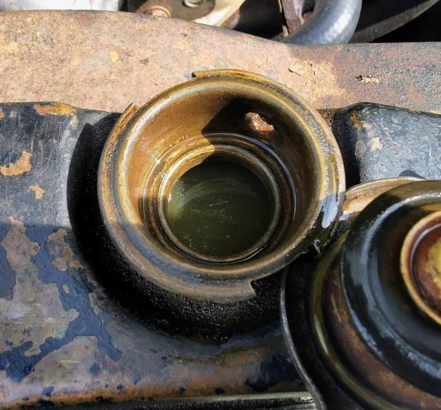

After a bit of faffing about bleeding the cooling system (there are no actual bleed valves on this car) we seemed to have a water tight cooling system. Nearly.
New leak from here. Not sure if this has been leaking there for ages and it's only just become visible, or if the pipe being manhandled while I was trying to get the hose that was well stuck to the front end of it off fatigued it. Hopefully it won't be too tricky to resolve that. It's about 1 drip every 15 seconds when the engine is cooling down, then seems to stop. So it needs sorting but isn't cause for immediate complete panic.
Took her out for a quick bumble round the neighborhood and we didn't lose any coolant. My perfectly clear blue coolant however had turned the same slightly muddy colour as what came out though.
I wasn't really looking there in detail though, I was looking down here (older photo).
I think we might have got it. I sat watching for a couple of minutes and didn't see a single drip, whereas we were getting one every second or two when I took that photo.
I left some cardboard there for about an hour and there were only one or two drops on it, which could well have mostly been there from beforehand given how much it had dumped down the side and back of the engine. I'll give the general vicinity a dousing with some degreaser if I get a chance in the next couple of days.

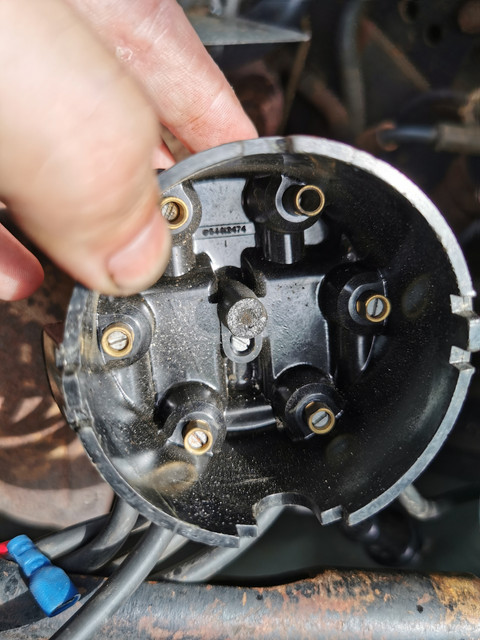

I did dig out one of the spare correct style distributor caps. Though they are both pretty worn. Hopefully these are still available.
It does look so much better than the modern style cap and leads in this engine bay though.
It doesn't really *look* like I've done much today!
Despite that there's pretty much a full afternoon of work in here!
Slightly concerned about the self destructing distributor cap - will definitely keep a spare in the car from here on just in case. However having the cooling system refreshed aside from that one bit of metal line will definitely help my peace of mind when driving the car now. I was definitely rather nervous that one of those hoses was going to let go before.

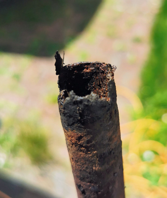

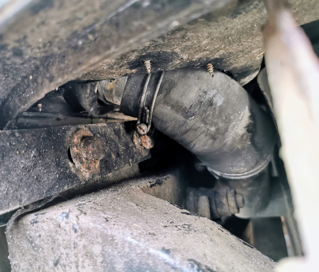

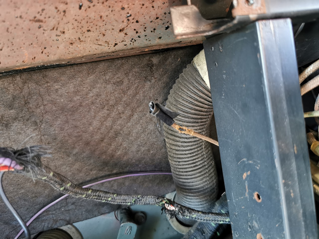

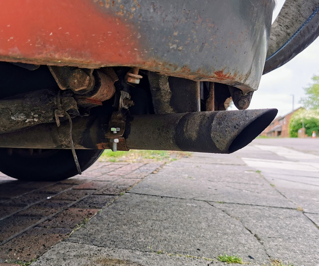

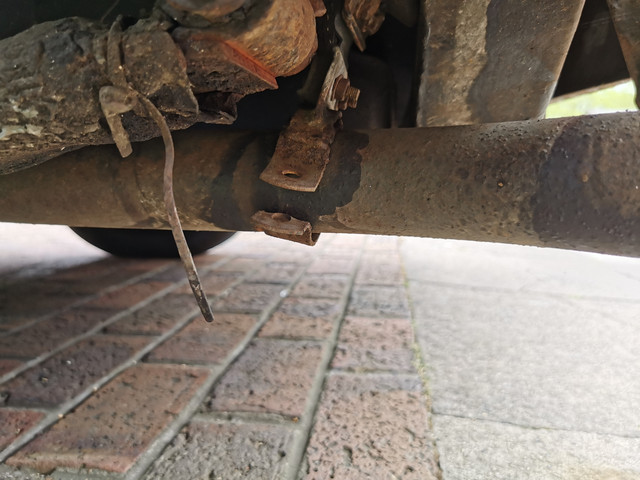

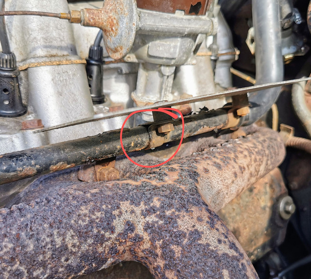

This afternoon I discovered why the ride has always felt quite on the bouncy side. Both rear shock absorbers being seized would do it! A replacement pair are now ordered.
That water pipe which has failed yesterday isn't helpfully a standard plumbing size, as I'd wondered if I could just stuff in a length of 22mm copper pipe. However that's a good 5mm too large so a bit of a stretch, especially as the front hose in particular is already a very snug fit.
Cue salvation presenting itself in the form of something in the "sure that will be handy one day" pile in the corner of the garage.
I'm not entirely sure what this originally was, but it's reasonably thick walled steel so will do for now at least. Helpfully already painted black like the original too.
Quick job to swap that over. Though I realise now I could have really done with cutting it an inch or two shorter.
It does sit slightly askew as the original pipe had a support bracket welded to it that was bolted to one of the exhaust studs - I'll ponder a solution to that at a later date. For now it's fine.
Coolant topped off and test run completed, everything seems to be happy.

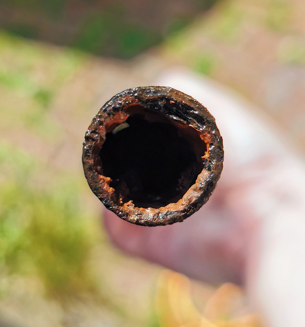

The old pipe definitely shows evidence of being 60 years old.
Having changed that the heater is probably going to be rather more effective too...
You can actually see daylight through here, but it's plenty restricted with rusty gunk for sure.
Been out running various errands in the car today and on no point did I come back to find any oil drips under the car. Think we can call out the inlet valve cover gasket as the main culprit for the leak then. Sure there are a thousand small leaks which will leave the odd drop, but I can deal with that. Engine oil dripping off the rear axle, not so much!
Quite happy with that result as with the location the drips were coming from and the sheer volume of it initially definitely had me worried that the rear main seal had failed.

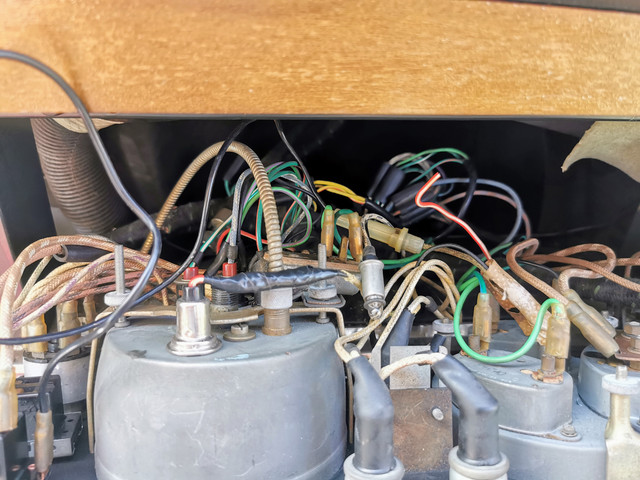

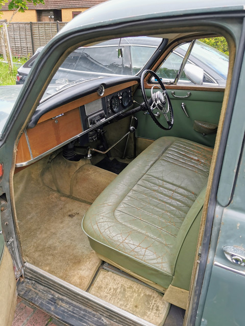

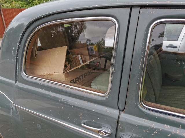

I will need to see if I can come up with even a temporary solution for a carpet in the back.

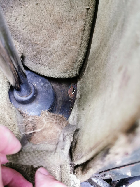

Did spot something less than ideal when cleaning the carpets though.
Don't think you should be able to see daylight through there! Not hugely surprising really but still not ideal. Shouldn't be a massive job to sort that when I've got a bit more time.

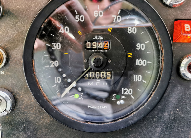

Did miss rolling over a mileage milestone on account of there being nowhere to pull over to grab a photo when it happened, so you'll have to take 5 miles later.

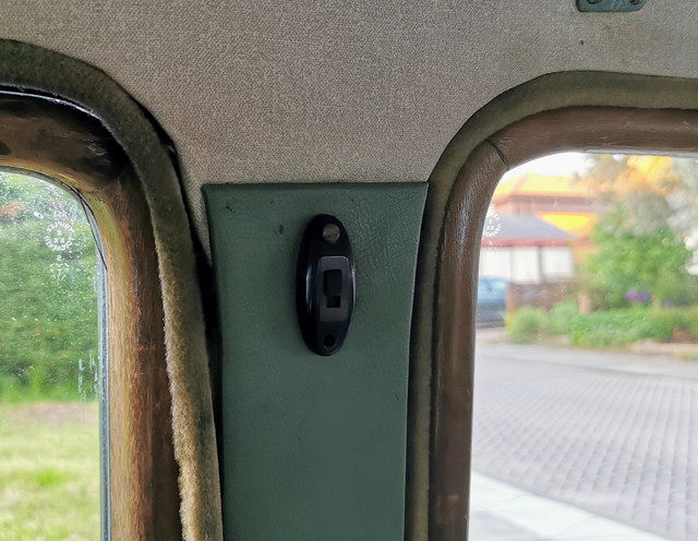

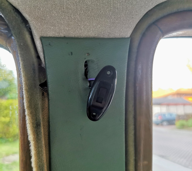

I did discover that I needed to do something about this today.
Mainly because I discovered that if I drive at speed with the window fully open it wiggled around on the cable making a fantastically irritating clicking noise right in my ear.

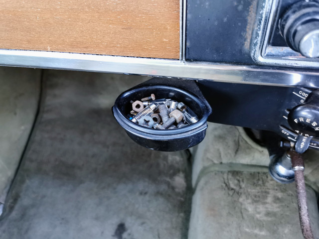

Had a dig around in the onboard miscellaneous parts store and found a screw that fit.
Only one rather than two, and it's not the *right* screw, but it has stopped it from ticking in my ear for now. I'll try to dig out the right fasteners after the weekend. Or in a few years when I next remember.

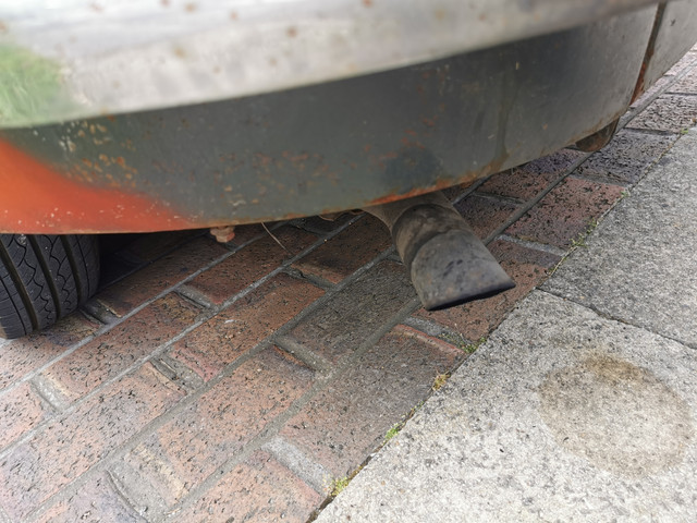

Unsurprisingly the Rover handled the 60-something mile run over to Birmingham just fine, despite the traffic being absolutely horrendous the whole way. I really do need to adjust the clutch as the pedal being so high gets really tiring in traffic really quickly.
Also noticed that we do clearly have some inlet valve stem seal leakage, you get a decent puff of blue smoke when you first put power back on after any long downhill stretch. Not anything I'm worried about even slightly though. It's not bad by any means and she doesn't smoke at all under any other circumstances. Given the age and mileage it's not even slightly unexpected at all.

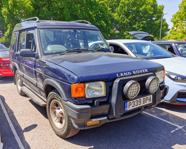

The one other vehicle from the 60s I did remember to photograph was this Land Rover. Which I get the feeling must have quite a story behind it.
Why? This is why.
How on earth did that find its way all the way to England? Sadly didn't have a chance to talk to the owner so that's something we'll need to wait till the future to find out.

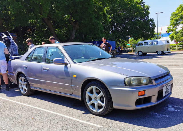

I'm far more used to seeing that generation of Skyline looking more like its companion one row over.
Not my taste, but if we all liked the same things the world would be a terribly boring place.

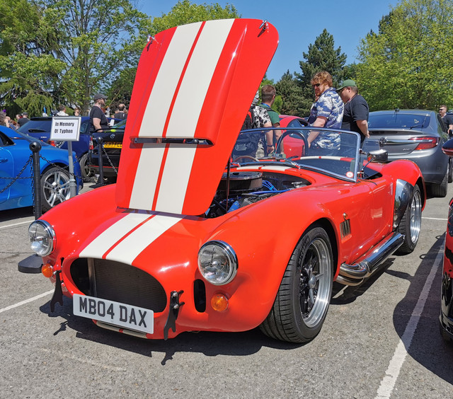

If I owned this there's one change I would immediately have to make.
Sticking a private plate on it which makes the age less obvious. Seeing an 04 plate on a car which looks like that is just so jarring at least to my brain! Would it have stopped me quite happily driving it home? Nope.

The first to get some attention was actually the Caddy. When I had the tyres rotated it was noted that the front brake pads were getting very low, particularly on the nearside. Given that The Garage over in Wolverton were asking less than £90 to change them including the costs of the pads and VAT and that I need that car to Just Work, I just got them to do it. Which I think was money well spent given that they found that one of the sliders on the offside was seized up. With the right tools and experience it took them all of about ten minutes to coerce it into freeing off, clean it up and lubricate it and get everything back together. That probably would have ended up taking me a fair old chunk of the afternoon to sort - plus at least an hour when you combined the time needed to get all the necessary tools etc out and to tidy up.
The pads were definitely pretty well shot though. Don't reckon it would have taken more than another couple of weeks for the one here to have ended up down to the metal given how hard MK is on brakes. Discs at least were still perfectly serviceable though.
Obviously will take a bit of time for the new pads to bed in, but the brakes already feel noticeably more positive.

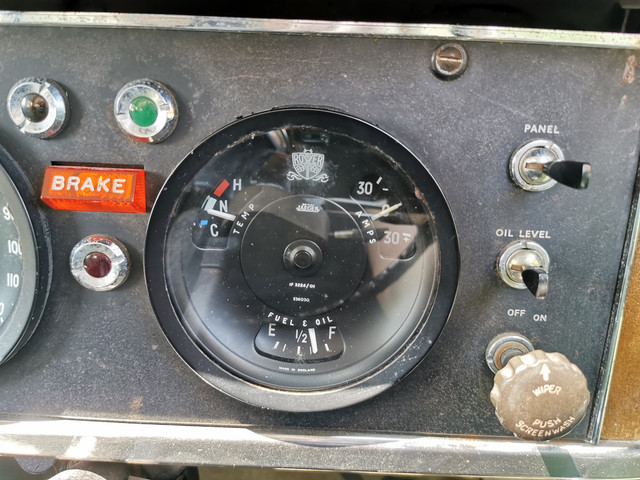

Saturday afternoon's entertainment was electrical in nature.
There were three targets here:
[] Radio.
[] Clock.
[] Warning light for handbrake/low brake fluid.

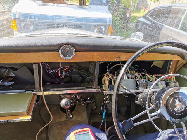

Quick disclaimer here. In the interests of preserving my own sanity, I am simply referring to "power" and "ground" with regards to the electrical system in this car. Power is the feed from the battery, ground is the body. I'm well aware that this car is positive earth...so "power" in this case just means -12V rather than positive 12V. Just using these terms just makes it way easier to keep track...If I start using positive, negative etc I'm just going to wind up confusing and second guessing myself.

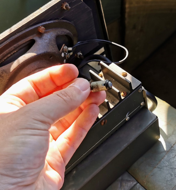

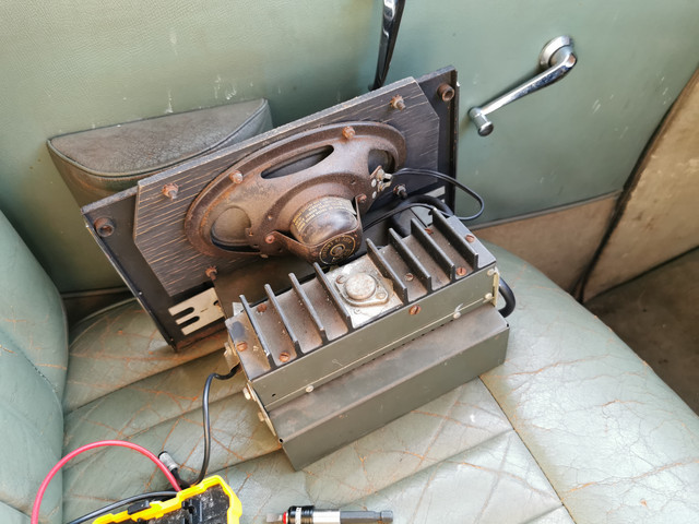

I won't say it's THE reason that the radio wasn't working, but what was definitely A reason the radio wasn't working quickly became apparent. The power lead not being connected to anything definitely would explain it.
That appears to be the end of an inline fuse holder, the other end of which I am *guessing* used to be attached to this taped up wire which was (very loosely) attached to one of the switched terminals on the ignition switch.
I'll reinstate the fuse holder before returning that to its rightful place. That's a ways down the road though as this will be having its day on the workbench before I even think about feeding it any power.
Unusual looking setup. As far as I can tell from the construction, they've used an entirely solid state power stage to drive the speaker, that's the big block on top with the heatsink and big transistor bolted in the middle of it (looks to be a Mullard OC26 - Oh joy, one of the ones which likes to short itself out by tin whisker growth if I remember rightly). The RF and small signal side of things is mostly valve based, though does use two transistors. Slightly unusual for a valve circuit though is that there's no high voltage present, the HT voltage simply being directly derived from the vehicle's 12V supply. Which is good for me, as it means one less component to fix. I'm hoping that this will be a simple re-cap and go job rather than a replay of the last valve based car radio I tried to get going which turned into a massive headache.
The clock is also going to need to be serviced. I've ascertained that it is indeed getting power and has a solid ground, so the mechanism itself is most likely gummed up with 60 years of gunk. That's a job for another day.
While looking at the clock though I did discover one wire that was just crudely stuffed into one of the butt connectors. Following that lead to a light fitting underneath the lip of the dash which I hadn't even realised was there before. Terminating the wire with a proper terminal to fit the connector and replacement of the missing bulb got us a working courtesy light.
I imagine this originally had a cover at some point, though given the location it would have had to have a very low profile to clear the lid of the glove box...so maybe not. Not as though you can see it unless you're sitting in the footwell anyway, and it works quite well to provide light where you need it.

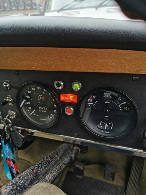

Investigating the wiring behind the instrument panel it was immediately obvious that I was far from the first person to be digging around in here.
The red wire with a white tracer that's just dangling in mid air is from the output of the dash lighting rheostat which has been mostly bypassed - with the panel lighting being just directly wired in. Except for the clock which is still plugged in correctly. I'm not sure why this is given that the rheostat seems to work perfectly...something I'll investigate at a later date. For now I've properly terminated that wire so it can't short on anything and left that well alone.

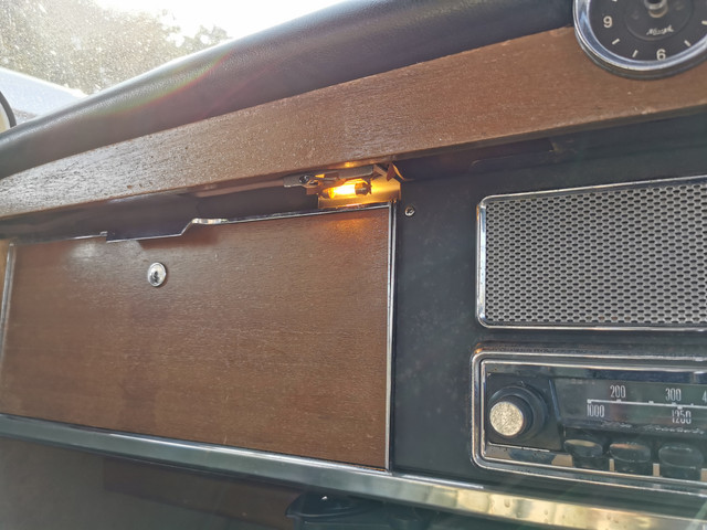

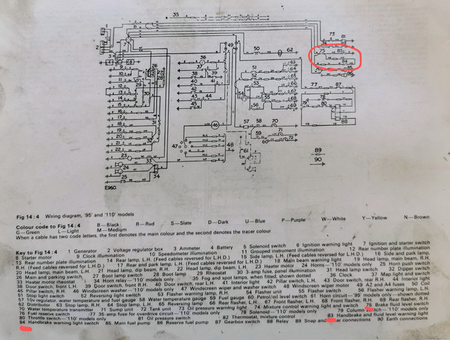

I pretty quickly established that I didn't have power getting to the brake warning light. This is where I ended up sending myself on a bit of a merry old dance because I hadn't looked at the circuit diagram first. I'd made the assumption that (as tends to be the case on most newer cars) that the lamp would always be powered and that the switches would provide the ground path. Turns out I was wrong.
Which explains why I couldn't find a likely source of power for it. The following day, armed with the knowledge of how it actually worked and about ten minutes of my time...
Both circuits pick up power from one of the terminals on the brake fluid reservoir, and it turned out that the wire providing the feed wasn't properly captive in the crimp. Once I replaced this with a new crimp terminal the light worked perfectly.
Given this car only has single circuit brakes, I really did want this to be working properly as I'd really rather know about any loss of fluid sooner than later!
It's definitely not a warning light you could miss. The lens is structured such that it really does concentrate the light into the driver's eyeline.
Plenty of cars wouldn't have had any warning for the braking system at all back when this was made, so it's a nice safety feature to have.
Last time I fuelled up I noticed that I had developed a not insubstantial leak from the filler neck area. I initially suspected that the rubber elbow there would have failed, but investigation revealed a far more simple solution. The upper hose clip wasn't in place, it was sitting several inches further down the pipe, presumably forgotten by whoever last had the filler neck apart.
Who knows how long this had been like that - I most likely disturbed it enough to break the seal when I bolted the filler neck back into place a couple of weeks ago. Was a simple matter of wrangling things back into their respective positions and tightening the clamp back up.
I've since filled the tank and noted no issues. You can clearly see both from a drip mark on the paving and witness marks on the exhaust from where it had been leaking before.
Glad that this is no longer an issue. The general smell of fuel both around that corner and in the car is vastly lessened now too. I did note that the rubber elbow is a little perished, not badly by any means but it is showing its age. Given that new ones are cheaply and readily available I'll order one with the next round of parts as that will be solid insurance I'm sure against it degrading any further at all.

On the Rover's wireless, no worries with tin whiskers on the OC26 audio output transistor. Thermal runaway is the biggest killer of those and there's a few reasons that could have happened, leaky old paper capacitors will be a prime cause... Fingers crossed that's not happened. Was the fuse intact? I'd not power the wireless until a lot of basic checks have been carried out to avoid any potential further damage...
The transistors that really suffer whiskers are the AF11x series of RF transistors... I'm not aware of any of the early power transistors suffering although some of the AC series small AF transistors are starting to show signs... Your wireless is likely too early to have any AF or AC series transistors... Any others in it will most probably be OC series...
As we discussed, the wireless is a pretty standard late hybrid using 'space charge' valves with a 12v HT... It shouldn't take much to get it working and it's unlikely any of the valves will be faulty... As said, check all capacitors, both paper and electrolytics...
If you need any assistance with the wireless, you know where I am...

Ah, got my transistor series switched in my head.
No evidence of the fuse holder whatsoever aside from the remains of the "bayonet" end attached to the wireless in the photo. The ignition end is just a bit of wire with some tape on the end.
It'll be getting treated just the same as a mains set really, any wax paper caps will be changed on sight, likewise any electrolytics (of which I think there are only two or three). Shouldn't be too bad I reckon provided that the Phantom Twiddler hasn't already been in there messing with it.
Looking at the service data shows our valve lineup to be 12AC6 (x2), 12AD6, 12AC6 and 12AE6 and an OC82 transistor. The output stage transistor is indeed an OC26.

A box of bits for the Rover arrived this morning.
The old radiator cap was definitely past it. While the rubber seal is intact (and in fact still pliable surprisingly) the spring has lost all of its tension so it doesn't hold any pressure at all. New one actually latches into place properly and feels like it's doing something. It is the correct pressure rating.
Bit of a shame that it's clearly of far lower quality than the original (which has gone back into the box of bits that came with the car), but functionality is key here rather than whether it looks original.
I'm actually not convinced of my accusation that was levelled at the rear shock absorbers now. There is movement in the rear suspension, visible if you rock the car from side to side - though it's far more stiff than it should be. For instance if I sit in the boot the ride height doesn't drop at all visibly and I can't "bounce" the rear corners of the car at all. It's just rock solid. I'm wondering if I'm actually on completely the wrong track, and it's actually just that the rear suspension needs to be properly lubricated. The springs (this has leaf springs on the rear) look absolutely bone dry where they're visible, and I clearly remember lubrication being a job that had to be done periodically on a couple of older vehicles with leaf springs before. They need to be able to slide against each other as they flex - otherwise they essentially just remain stuck together like one big block of metal. Which would definitely explain why the suspension spring rate seems to be all to pot. I know that the equipment we were generally dealing with (usually agricultural) used to get the springs thoroughly painted with hot oil annually, but I'm sure the correct solution would be to properly grease between the leaves on assembly - I'd assume with something graphite based so it wouldn't dry out (or rather so that even when it does dry out, the actual bits doing the lubrication stick around).
I'm very much inclined to go and thoroughly douse everything in that general area with penetrating oil in the meantime, followed by something with better long term lubricating properties. See if it makes any difference at all. At the end of the day it really all wants to come apart to be cleaned up, lubricated and be reassembled replacing the no doubt fossilised bushes and such along the way - but that's not a job that will be happening in the next couple of weeks. I can't see this approach hurting anything. If it does have any positive impact it pretty much proves I'm on the right track I think.
Something I should definitely do though before making any plans to refresh the rear suspension is measure the current ride height. I've no idea how old these springs are, and it's entirely possible that they're very very tired, in which case it may just make sense to replace them as a set while I'm taking everything apart anyway. They're not exactly cheap at £180 a side - but I can't really see me getting the existing springs re-tempered all that much cheaper than that (if I can even FIND anywhere to do that - I know a friend trying to get that done a few years back had an absolute nightmare of a time and they were in the trade)...assuming they're even in a fit state to be serviced of course and I don't just find myself with a collection of bits of spring once the hangers are undone. Though I don't think we've any broken leaves...or if we do they're identical on both sides as the car does sit perfectly level.
Externally the repro distributor cap doesn't look great, but I have to admit that the machining of the terminals in it looks decent, so I'm going to give it the benefit of the doubt. Will try to get that fitted tomorrow.
While I was crawling around under the back of the car I noticed something.
That may well explain the occasional hollow metallic rattle from the nearside rear corner. A quick rummage through the drawer of random fasteners (doesn't everyone have one) sourced a suitable nut and bolt. Couldn't find any washers the right size...but it's an exhaust clamp, it'll be fine. Especially as it's an exhaust clamp on a bit of exhaust that's probably going to be replaced in the not too distant future anyway as there's a big hole in the silencer.
So it squished rather than tightened up gracefully but it is securely gripping the pipe now. Sure enough, the rattle has gone! Wish all fixes were that simple.
Wondering what that random bolt in the rear valance used to do. Wonder if there were a set of mud flaps or something on there somewhere in the past?

Final job of the day was cleaning out the engine breathers.
I reckon they must both have been done pretty recently as there was very little grime that came out of them. There is another one buried down under the inlet manifold, I need to look up the procedure for getting into that and how often it's meant to be cleaned - though it's pretty clear that this engine has very little in the way of blow by. Which kind of confirms in my head that the power unit has been both looked after and has had a fair amount of work done over the years. At 150K miles if it hadn't been subject to a fair amount of love over the years I would have been expecting this engine to be feeling really pretty tired, which this to me at least doesn't.
