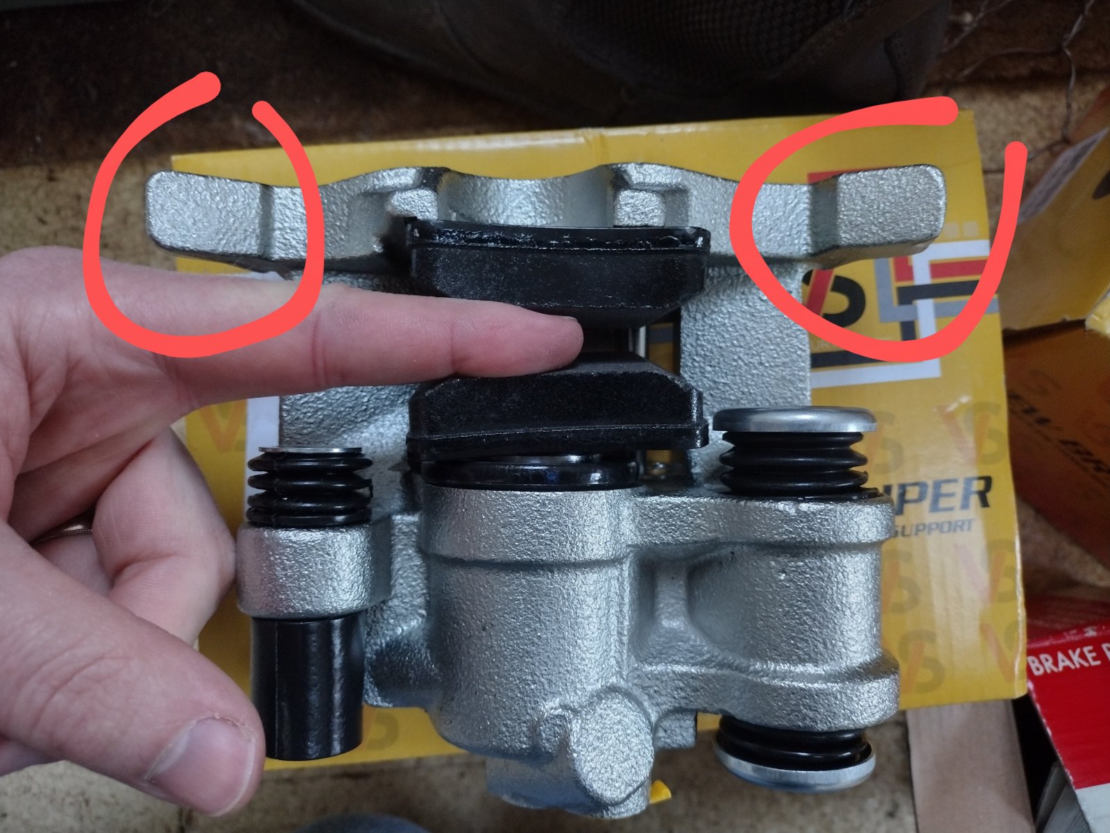

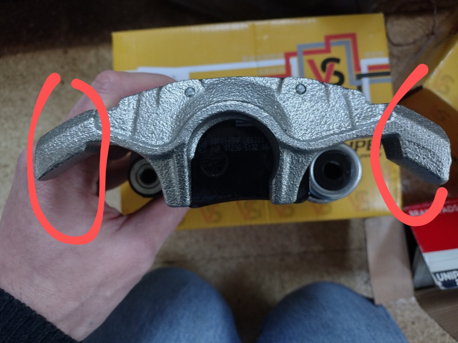

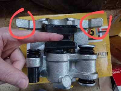

Just don't understand what these "ears" on the calipers are for!? (Old calipers are the same)
New calipers have been given a coat of clear lacquer (may as well try and keep them looking spangly new as long as I can!)
Busy with other jobs so rather loosing the light to make a start now.
Brake hoses have come too. Off next week so will be trying to make progress weather permitting
Posts: 6846
x 3566
Maybe a resonance thing ?

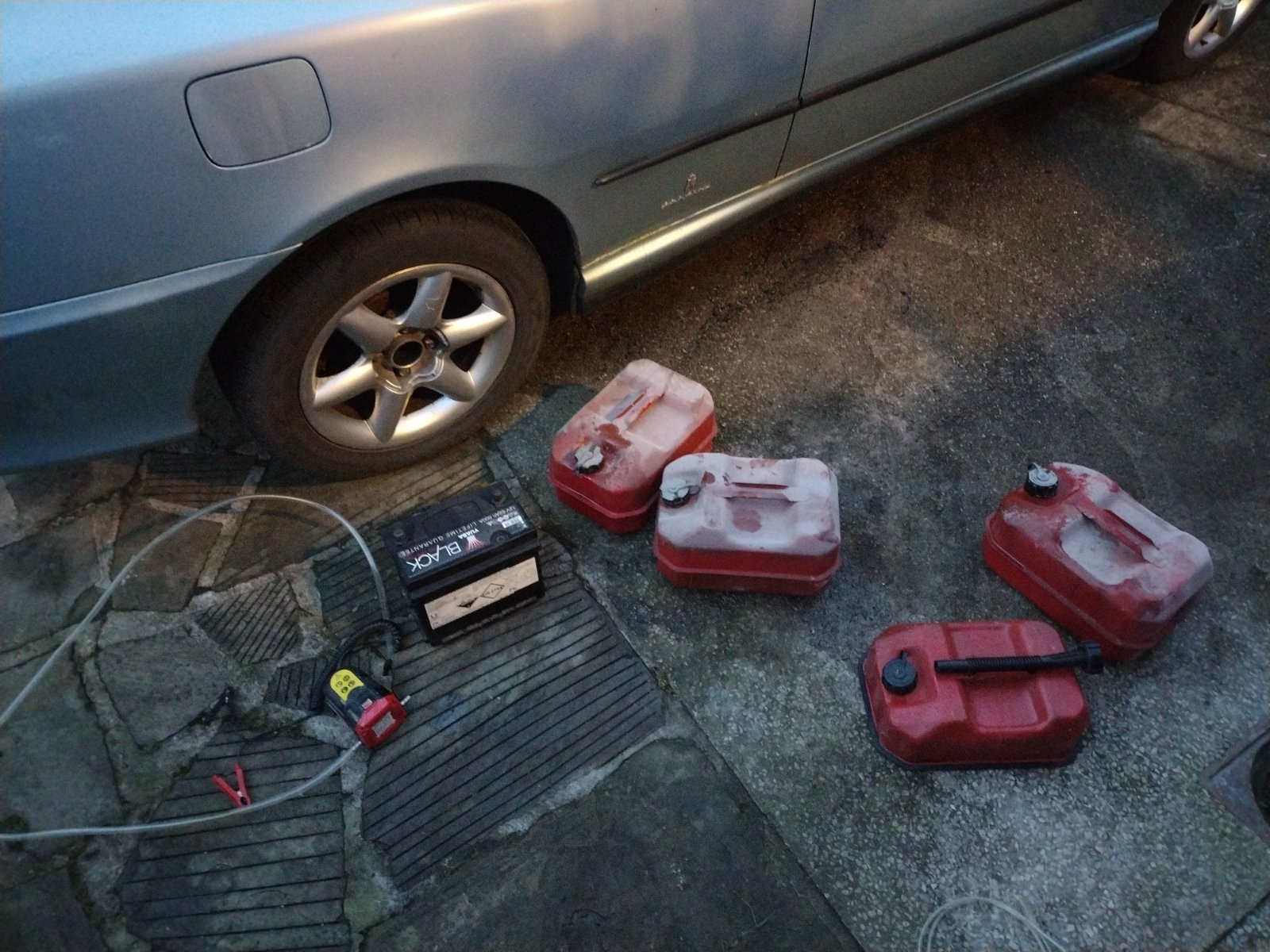

Posts: 5304
Joined: 25 Apr 2022, 09:03
x 2336
Unread post by MattBLancs »

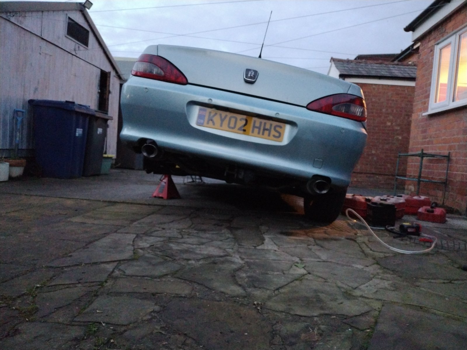

Annoying, seems this much angle:
Is too much for the tank to keep it's diesel contained.
I think this is likely an issue with the sender unit connection, big O-ring usually.
Add it to the list! :-D
Looks very severe on that picture, not as bad as that (phone mega wide angle lens at work)
Posts: 55020
x 8350
Up that high to attend to bodywork Matt? I did initially wonder, with all those petrol cans lying around it, if you were planning to torch it if it didn't start behaving ;) :lol:
CitroJim wrote: 17 Dec 2023, 17:11 Up that high to attend to bodywork Matt? I did initially wonder, with all those petrol cans lying around it, if you were planning to torch it if it didn't start behaving ;) :lol:
Yes that's the plan Jim, get a suspension arm unbolted (three bolts moved no problem this afternoon, the other end looks like the brake disk must come off to make access room, so on to the brakes next, then back to the welding (then other side rear up in the air for caliper and Flexi hose swap. then the front up for new bleed nipples and Flexi hoses, then get bleeding/flushing through fluid I've no history to confirm when last changed.
Still hoping not to drop the tank (even though I've just half emptied it) as is a good way from where the rust looks to finish.
Initial digging here, with slightly improved image.

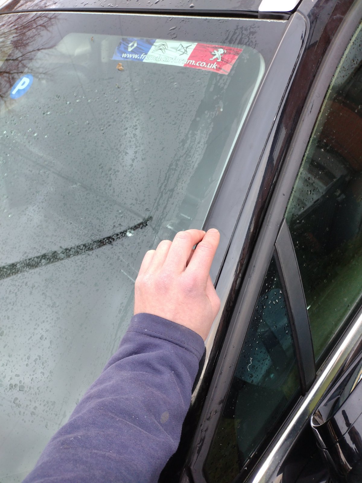

Brief C5 update:
MattBLancs wrote: 15 Jan 2023, 10:07
MattBLancs wrote: 14 Dec 2022, 20:45 Got on the motorway and passenger side windscreen trim decided to announce failure of its adhesive by dancing on and off the screen!
A gentle removal in the services took this off and into the car.
Today I shall be playing a game of "how long do I need to hold this to be sure the silicone has a good hold of it? And is it going to rain on me whilst I am stood here like a human statue...
This lasted just under 12 months! Driving to work this morning, tap-tap-tap noise I quickly recognised. Fortunately a couple of miles from the services have chance to nip out and pull it off again (only about a third of its length seemed to be stuck at this point, so think lucky I pulled it off when I did before it flew off!)
Will have another go when the weather warms up

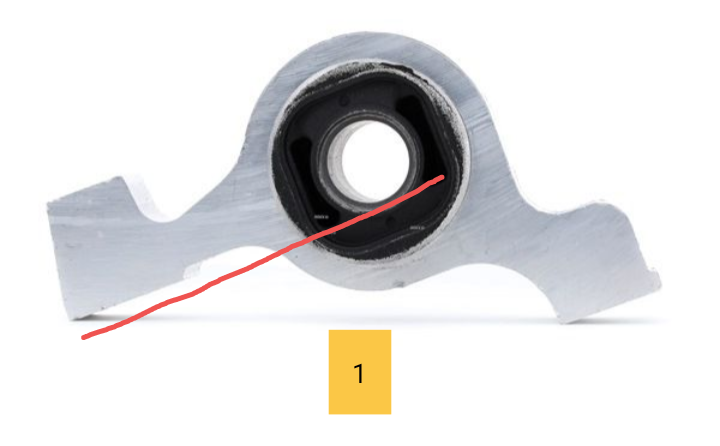

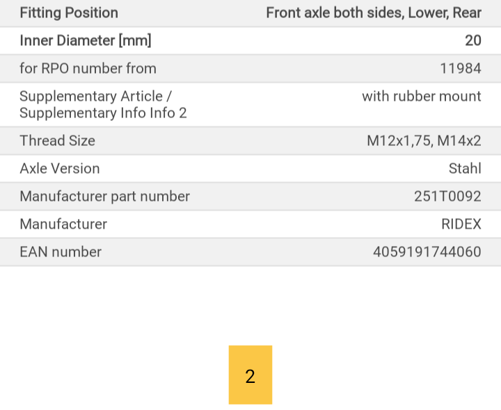

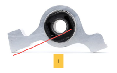

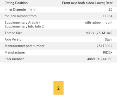

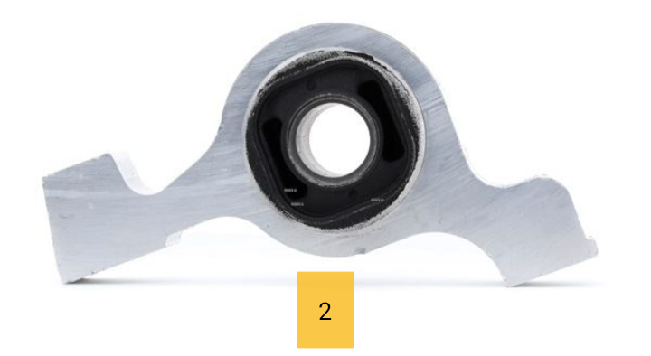

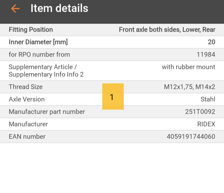

Long winded suspension bush question coming up!
I remember watching an Up N Down video on his C6, which despite my best efforts I've failed to find for a second time! In the video he described there being a difference between front lower wishbone bushes (the rear one of the two)
The aluminium bracket surrounding the bush had a different "height" of the centre of the bush relative to the flats which sat against the subframe.
Can anyone confirm this and, better yet confirm which of the two variants I should look for? (On the basis of the C5 X7 Exclusive being the same as the C6 in regard to these bushes)
Here's what Autodoc has and the description of each:
Type 1
Type 1
1 details
1 details
Vs
Type 2
Type 2
2 details
2 details
I've tried to get each in the same orientation, but it's not leaping out at me to be honest!

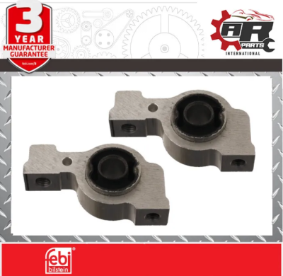

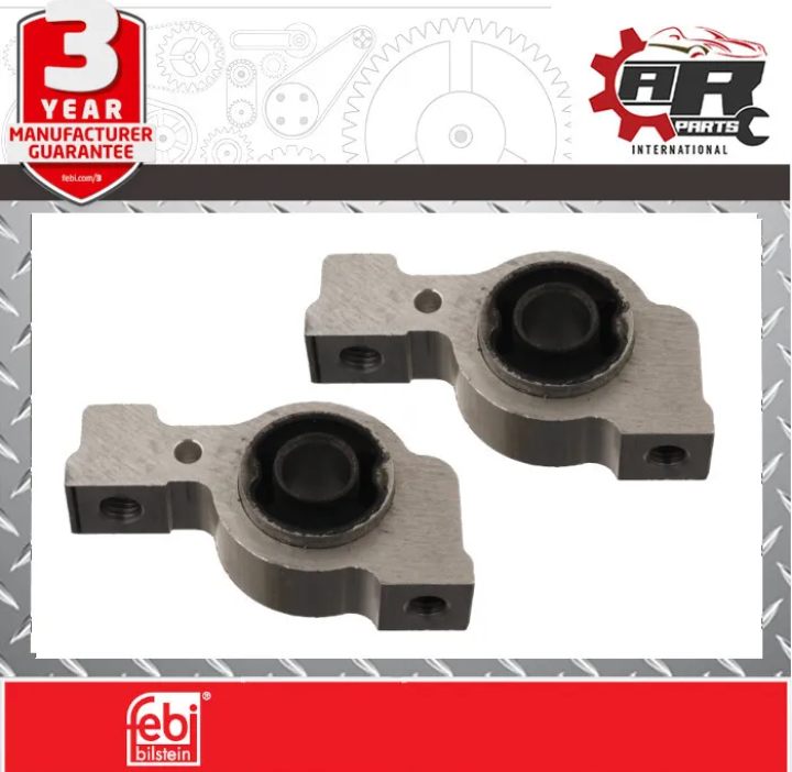

Fair to say these look quite different!
From eBay
From eBay
FEBI
Suspension Bush
x2
Front Suspension
Lower Wishbone
Rearmost Bush
L/R
suits:
Citroen
C5, C6
Peugeot
407, 508
replaces: 3520.N6, 3521.J6
https://www.ebay.co.uk/itm/295787060797?
Can't find many decent images , all just "plonked on a table" type views
Posts: 55020
x 8350
Those Autodoc ones look like they might fit but the right hand part looks a bit weak...
