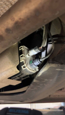

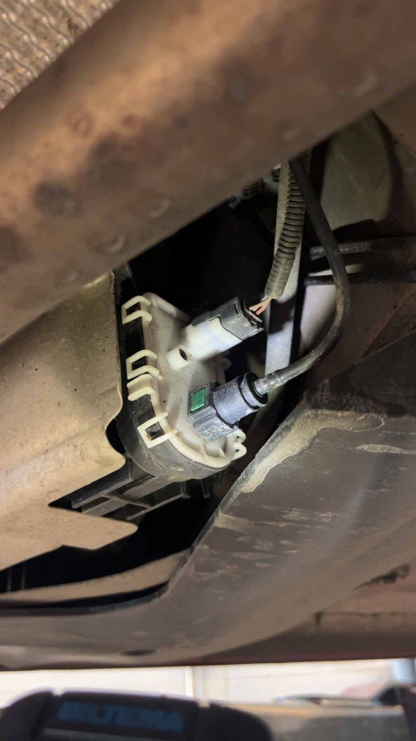

Are you shure for Powerflex. I have green conector
- x 6945
linksys11
- Posts: 6
- Joined: 18 Jan 2023, 15:05
Re: Eolys?
ok. So powerflex is ok.
I did another test of additive pump and its work ok an test says OK. If i test a pump,additive is pumped to diesel tank? Is this ok,or maybe to much additive in diesel
- x 6945
Re: Eolys?
You don't want to keep doing it, put it that way, as the amount injected into the fuel tank is metered based on the amount of fuel added.

Re: Eolys?
Hi,
Need to fill up Eolys, my vin is VF7**************[VIN obfuscated, can be read by forum staff] what eolys do I need?
- x 6945
Re: Eolys?
You need Powerflex Additive for this vehicle and build date.
flugan
- Posts: 4
- Joined: 12 Jan 2024, 10:47
Re: Eolys?
Thanks GiveMeABreak
, whats odd is that the clips are green, thougt they should be blue if it was powerflex?
What build date does it have?
- x 6945
Re: Eolys?
No that's not always the case. connectors are no indication of the Eolys type as there can be green or blue ones. Your build date code (RPO) is 12525 and you therefore require Powerflex.
