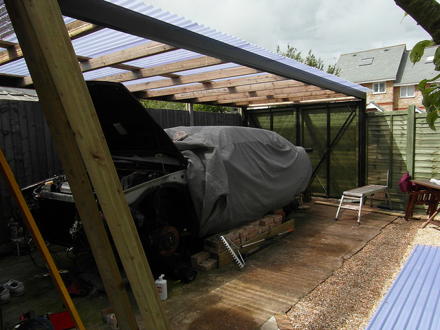

Brought it back today and got it all errected, even got my last fence panel cut down and put in place against it, tomorrow i start making the gates
Just got to decide what roofing im going to use, might go with unduline but its damn expensive...........
