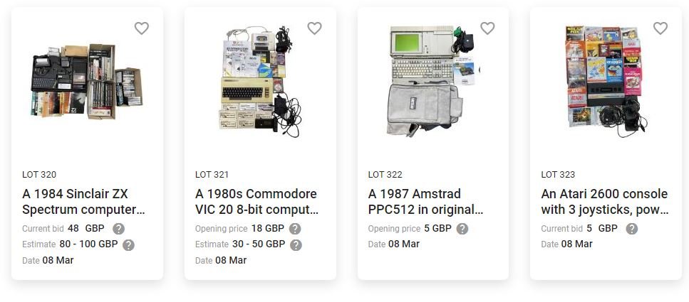

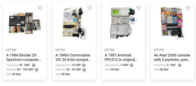

If any of these are of interest to you Zel you can find the listings at:
https://www.the-saleroom.com/en-gb/auct ... ta1&page=6
