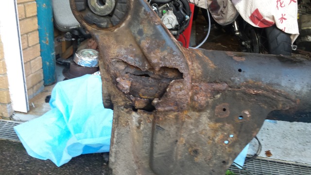

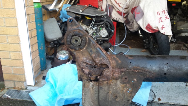

About a year and a half overdue for an update, and the same time overdue for getting the rear subframe done.
I thought that as the rear subframe had a fair amount of surface rust it would be good preventative maintenance to get it powder coated, I wasn't expecting the rot pictured that will require some welding before going off to be done!
Not sure if I should repair the wheel carrier before sending It off or wait to see what's left of it then do it.
Just goes to show that where you cant see there may be nasty surprises. The alloys are at a local place being refurbished and painted at the moment and fingers crossed ill be making it to the x-rally.

Cor, that subframe's rusty!
Bit not good that....

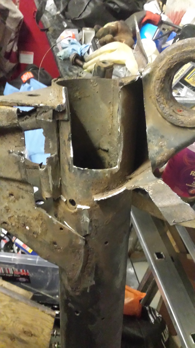

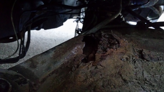

Well a bit more progress. Subframe is all stripped bar the mounts, if anyone has any advice on how to remove these it would be welcome!
Need to crack out the angle grinder and welder next.
This is the mounting that i'm unsure on how to remove or where to obtain a new one

Oooh, that's nasty looking.... Suspect that is not going to be easy to repair properly!
On the bushes they should *just* press out
If it's a MK2, then they are still available, albeit as a complete set of 4 (part no 513175) costing £175
However, the same mounts are used on Xantias (all variants) so it should be possible to pick some up cheaper eg This ended listing on e-bay for a set or This one for a single mount
MK1 has a different part number (95 030 525), is NFP, and not used on anything else (well, service.citroen thinks it is used on AX seat frames

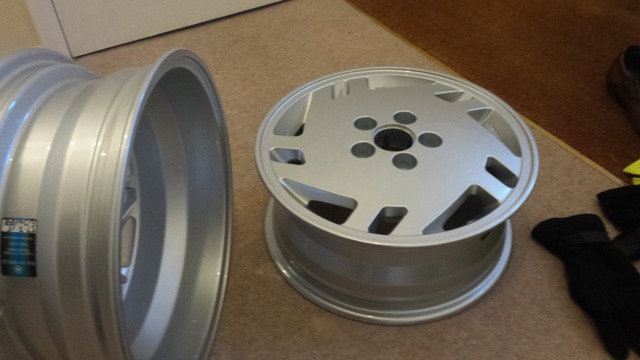

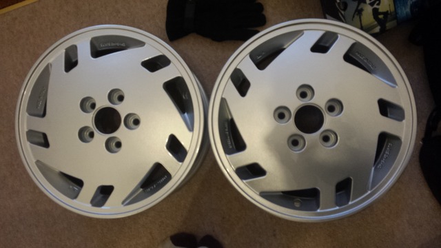

Thanks for the link, I managed to get them out and have started grinding away the rust.
Picked up my alloys today, they look better than new!

I do wish I could get a pair of 17inch ones for the C5 .....nice job

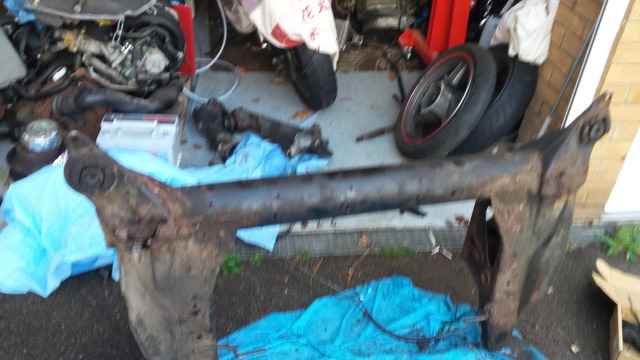

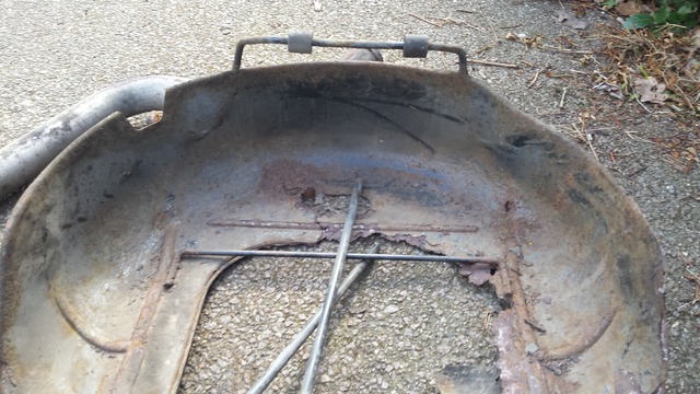

Well more grinding tonight.
If anyone has a subframe and/or a rear wheel carrier for sale now would be a good time to name your price as it is a lot more welding than I would like!

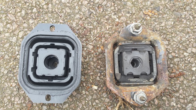

Talking to xmexclusive from club-xm about subframe mounts he cautioned me on the orientation of some rubber mounts that may look like they fit physically but would not be suitable due to the rubber orientation.
Picture shows more, on the left Is the new one I bought and on the right is the removed one.
Thankfully the one I removed is in excellent condition and with a bit of painting will give many years further service.

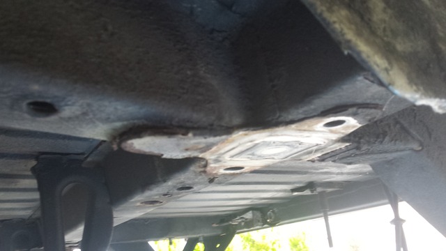

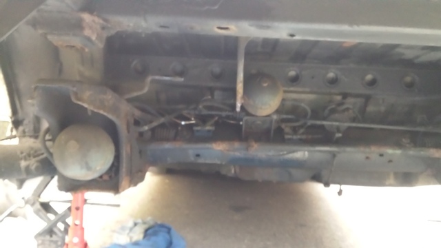

Below is the bit worrying me at the moment
There is one section that looks as though it needs welding beneath the support plate, but it seems pointless removing the whole support plate for one area of welding so I may just remove the offending flap, we shall see!

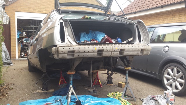

Excellent work Dave,
That'll be one fantastic XM at the end of it
