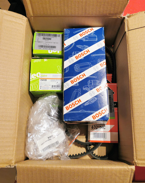

A box arrived for it this morning too.

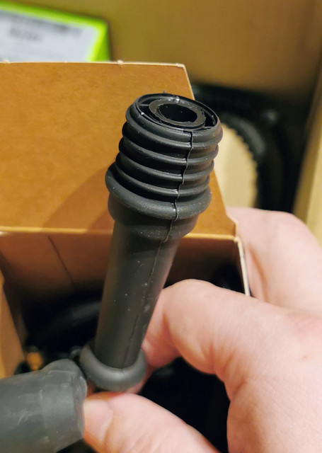

Quite a few things in there, but most notably at the moment are a new set of HT leads, new rotor arm, spark plugs and distributor cap. That will hopefully evict our occasional miss (which never appeared again today).
The HT leads are notable for having ends which are actually compliant...I actually thought the outer boots were plastic on those currently on the car.
The crankshaft position sensor and the tools necessary to change it will be living permanently in the car as I've had those fail without warning before. As it's easily accessible on this car for a change just keeping a spare on hand seems like easy insurance there.
The belts just look pretty tired so I figured for the sake of a couple of quid I'd just change them. One of them squeaks at idle too.

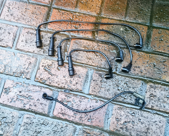

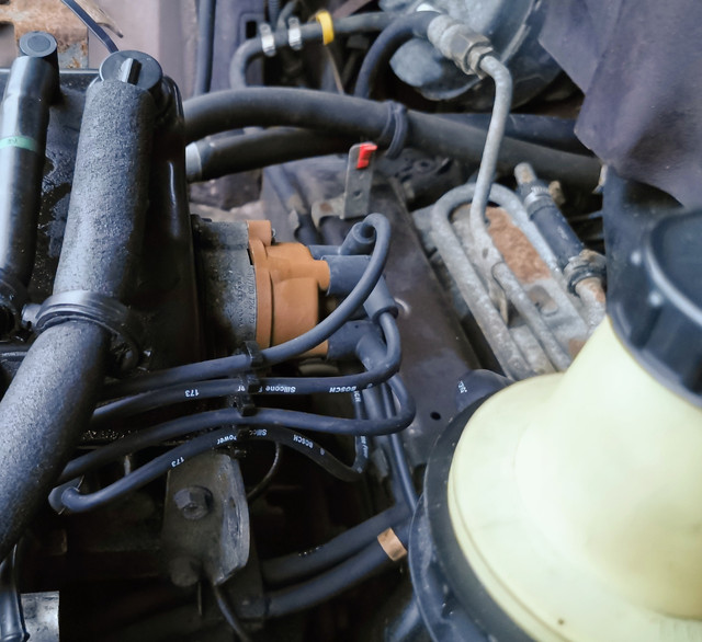

Spot the difference to earlier photos...

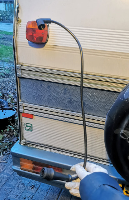

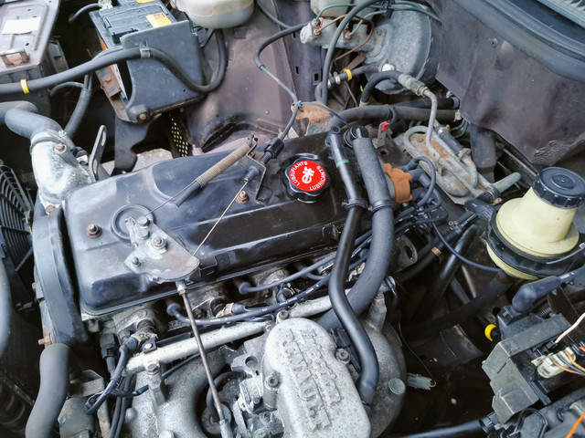

Not really obvious! New cap, rotor arm and HT leads are on.
The old leads are just a *little* past their best. I'm pretty sure these are supposed to be flexible...
That's just come off a warm engine too. Suspect you could probably use it as a hammer when cold. I know the insulation of at least one is seriously compromised based on the belt it gave me, so these will be going in the bin.
I suspect they may well be the originals, though I didn't spot any immediately obvious date code. I'll have a closer look when the wind isn't repeatedly having me chase things around the garden and trying to close the bonnet on my head.

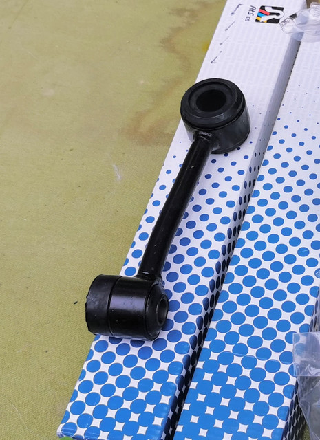

This evening's challenge: See if I can find anywhere that stocks the correct drop links.
On the car:
What I was sent:
The new one has a cranked link rather than totally straight and is about an inch too long. Time to do some digging. I'm guessing if it came down to it the bushings in the original one could be replaced...sure I'm not the first one to have this sort of problem.

I'm not suggesting using autodoc, but do the measurements for these match up ?
https://www.autodoc.co.uk/car-parts/oem/7700766869
7700766869 being the Renault p/n.

Useful to know. Showing a 131mm length rather than 154mm, so seems more hopeful! Less helpfully, not in stock.bobins wrote: 10 Jan 2023, 17:48 I'm not suggesting using autodoc, but do the measurements for these match up ?
Having the actual part number should be helpful at least.

That p/n is actually for one of your Renault 25 2.0L so it stands a good chance of being possibly the right part.

The first lot I got here were from there there system however reckons these fit.
Link.
Which quite obviously they don't. So far I've found three places with them in stock. Turkey, doesn't ship to the UK. Italy, doesn't ship to the UK, and Russia where obviously we aren't going to be getting anything from for a while. So I need to do some further digging.
At least looking at the design though it shouldn't be impossible to re-bush the originals if it comes to it. Which given these are consumables which it's pretty plainly obviously hard to get hold of and only going to get harder to find as time goes on may just be the more sensible way forward unless I stumble across someone with stock in the next couple of days.

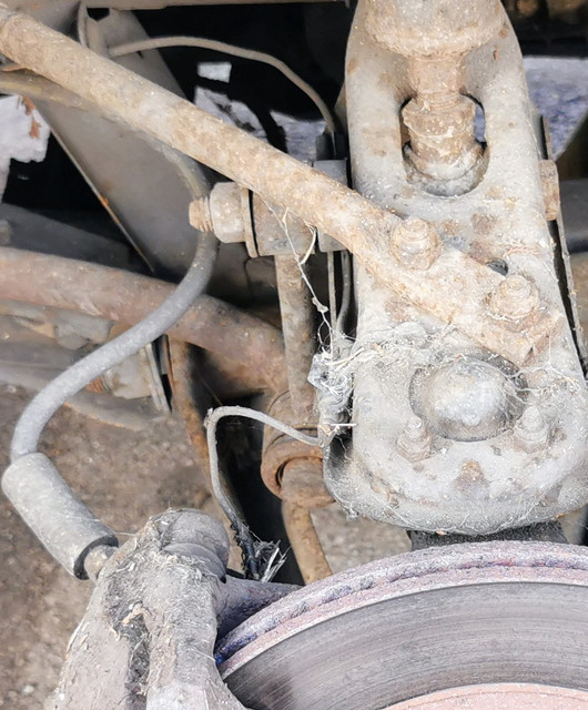

Zel, I wonder, if those too-long ones have the right bushes could an engineering firm shorten and re-profile them to make them correct?

I need to confirm if they are correct first. Vast majority of places seem to think the anti roll bar itself is 22mm, whereas the one on the car is 24mm, so the lower bush may well need to be cut slightly larger.CitroJim wrote: 11 Jan 2023, 04:50 Zel, I wonder, if those too-long ones have the right bushes could an engineering firm shorten and re-profile them to make them correct?
Thanks for the experiences with autodoc. The only issue I've had was with a AX dipstick that clearly wasn't!
Also I'd need to be very careful of falling foul of MOT rules regarding modifications to suspension components. I had a problem a good few years back where we had had the lower shock mounting lug welded back onto a wishbone after one of the tiny welds that had originally attached it had cracked. The result was far stronger than it had left the factory (bearing in mind I'd already replaced the wishbone once because of exactly this fault once) - yet it was failed as an unsafe modification. So I wound up having to replace the whole wishbone for a second time, which made me particularly grumpy as I couldn't find a second hand one so had to fork out north of £200 for a new one. I could see a cut and shut drop link getting picked up on similarly.
How to weld it together without cooking the bushes is another challenge to be overcome, so I reckon you'd probably need to strip it down far enough that (assuming it was possible) stuffing new bushes into the old ones probably would make more sense.

Ahh, I was unaware of the regulations surrounding the modification of suspension components Zel... Thanks for the education
In that case, re-stuffing the bushes may be best.. I'm wondering if a similar work-around to what I used to do with Activa ram bushes may work - turning up new bushes out of suitable nylon material on the lathe.... Thinking aloud here, having not seen the fine detail of them...

They don't look to be anything too special. Easier than a lot of cars as it's just a bolt and washer holding the top end on and looks to just be a friction fit around the anti roll bar at the bottom. A lot of cars have a ball joint on one or both ends of the link.CitroJim wrote: 11 Jan 2023, 17:41 Ahh, I was unaware of the regulations surrounding the modification of suspension components Zel... Thanks for the education
I imagine a polybush that will do the job at both ends probably exists, just a matter of finding the exact spec.

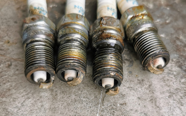

Only had about ten minutes to spare today between other jobs but threw the new spark plugs in. I hadn't seen until I started the job that they're taper seat plugs, so very glad they came out fine.
Obviously haven't been in there very long at all, but checking shows the ones which came out are the wrong heat range, so I'm glad to have replaced them.

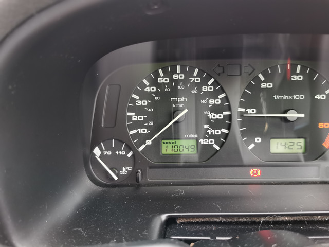

Had to run out for a few things today. Given the debacle with the driver's door on the Renault yesterday the sensible thing to do of course was to take the Caddy.
Yeah, we all knew that wasn't going to end up happening didn't we?
Door behaved itself perfectly today, though the speedometer only joined the party about 3/4 of the way through the trip. Investigation of that is already on the to do list though. Pretty sure it's a connection issue in the panel as the odometer and trip meter both keep working normally, so I don't think it's losing the speed signal from the pickup on the gearbox.
This is the horrible stuff I was talking about that's been slathered all over pretty much anything that's meant to move on this car, including the door locks.
I'm sure at some point it had lubricating properties, but it's like fully set candle wax now and can be removed in chunks with a screwdriver. Wouldn't surprise me in the slightest that if this is removed and replaced with something with actual lubricating properties that the door locks started working normally again.
I don't *think* getting the latches out is too difficult on this car. Hoping that's the case, after which point I'll probably pretend they're a carburettor and dump them in the ultrasonic cleaner to cook for an hour or so to get rid of the old grease.
