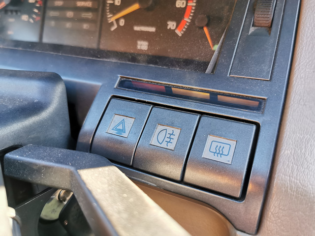

For once a simple job which was precisely as simple as it should be.

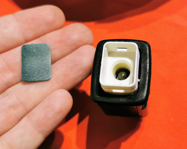

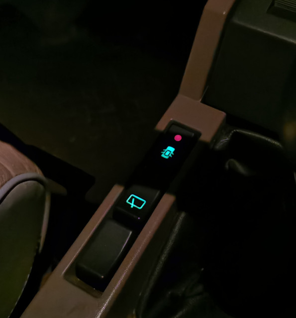

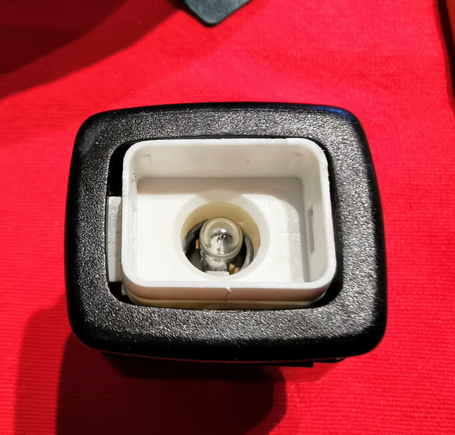

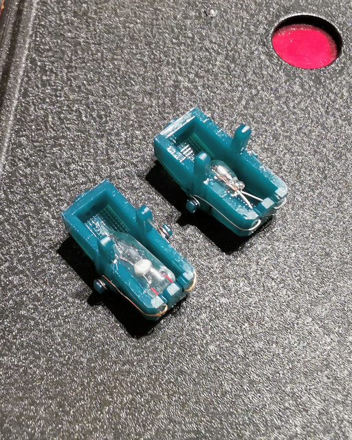

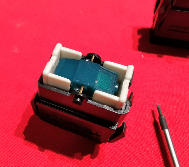

These two switches were lacking in working illumination.
Unlike a lot of switches these are actually dead easy to change the lamps in. Only proviso is that you need to have wire ended bulbs with leads of about an inch or so long on hand.

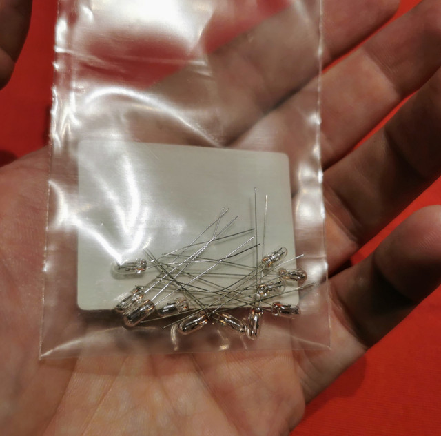

Stock number 360-7913 from RS will do just fine.

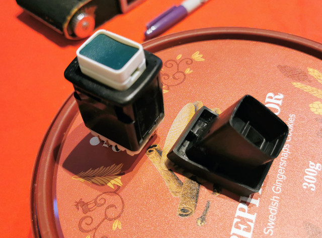

The cap pops off the switch easily (take note of which way around it goes!) After this point keep it upright or bits will fall out.
You're presented with the moving parts of the switch (white things at either end) and a combined lamp holder/diffuser (green thing in the middle).

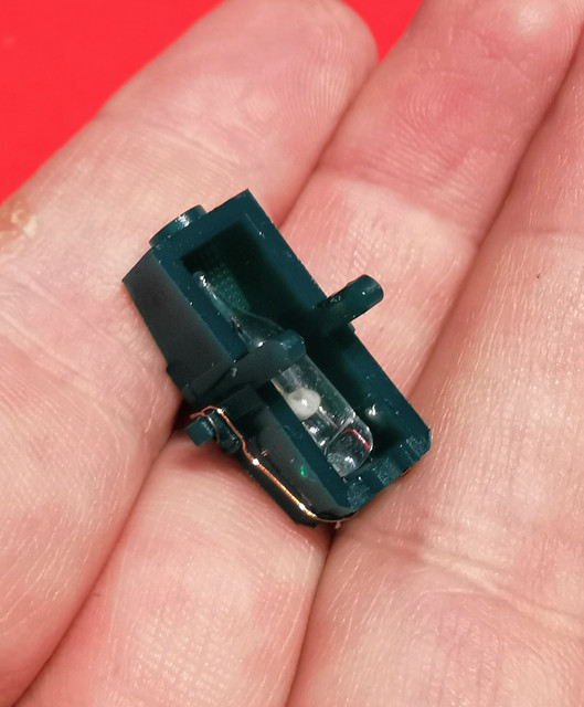

The lamp holder is a friction fit and should be pretty easy to lever out with a screwdriver or similar.
The lamp is simply held in place by two notches that the leads go through, and they're then wrapped around a post on the sides of the holder. These are held against a contact in the switch body so provide the electrical connection.
Replacing it is simply a matter of unwrapping the leads from the tabs on the holder and reversing the process with the new lamp. The new ones are a little smaller than the originals but that shouldn't be a problem in this application.
Should be plenty of room if you wanted to convert to LED illumination - though I figure the originals lasted probably 30 odd years and are so easy to change it's just not worth it here.
Then you just slot the lamp holder back into the switch body, clip the cap back on and put it back in the car.
Success!
Total time to replace the lamp in both of these: About 10 minutes.
Camera makes that look brighter and whiter than reality, the brightness matches the power window switches pretty much spot on.

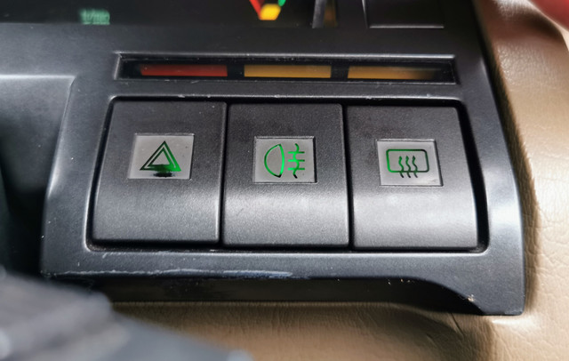

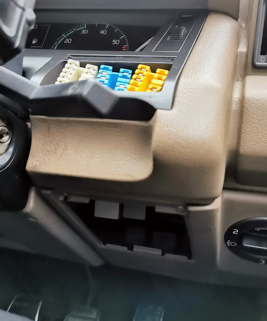

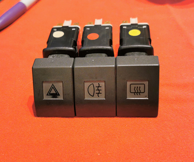

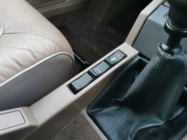

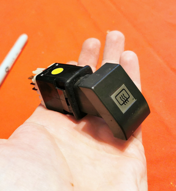

Following on a similar theme to yesterday I decided to have a closer look at the trio of push switches in the 25 which live to the right of the steering wheel. Only the fog light switch illumination worked reliably. The hazard switch would usually wake up if tapped, rear screen demister was dead.
I had visions of having to dismantle the dash to get these out, but no. Turns out if you remove the little storage cubby immediately below you can then easily push the switches out of the dash from behind.
Actually extracting the switches requires a little patience as the wiring connectors have a very firm hold. Especially the hazard switch which has about 38,274,619 pins.
Which allows you to retreat out of the torrential rain into the house to tackle these away from the weather.
I had no idea going in whether these were going to be an absolute pain to re-lamp, a lot can be. I think a lot of manufacturers just assume the lamps will last "the life of the vehicle" with no provision for replacement other than swapping the switch. PSA, I'm looking at you...the ones in Series 1 Xantias are a massive faff to re-lamp.
Turns out these just like the rocker switches are easy. A little more fiddly and you'll need a pair of tweezers. Not difficult though.
The switch cap can be pulled off easily. There are tabs at the top and bottom so wiggling it up/down while applying gentle tension will make them click free. Really not much force needed.
Poking a small screwdriver or similar in through the holes in the white body of the switch plunger will allow the diffuser/filter to pop out. It's just a friction fit.

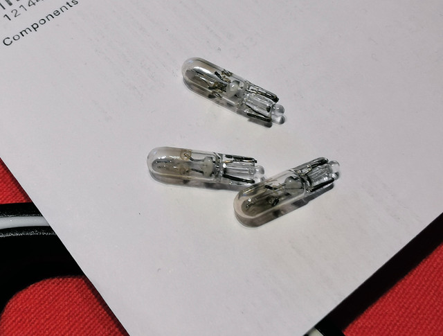

Now the fiddly bit. Actually getting the lamp out. This is especially a pain in the rear on the rear screen demister switch as it doesn't latch in, so you need to keep the white plastic portion pressed fully in while trying to fish the lamp out - and it fits quite firmly.
They take normal capless 1.2W 12V lamps.
New ones just slot in. Which is precisely as, if not more fiddly than getting the old ones out.
Then everything should just clip back together leaving you with a complete switch.
Which you can then refit to the car. I did test all these lamps before fitting them so was fairly confident they would work.
Success.
Sorted. Again, took about 10-15 minutes all in.
Quite pleasing to find a little thing like this that's actually easy to resolve. It's obvious that some thought has been given to ensuring that these are serviceable. Which was definitely not a given by the 80s.

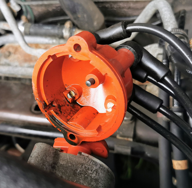

She's definitely still a bit cranky about the engine bay washing. I've got one cylinder dropping out under heavy throttle at lower revs, which to me says weak spark on it feels like just one cylinder. She started up initially off one so that tracks.
Looking at the distributor cap revealed two things.
1. I need to add "replace distributor shaft seal" to my to do list. No particular stranger to this issue from my Saab days.
2. This definitely won't have been helping our spark.
I'm not going to worry too much about that oil seal immediately. This thing has done so few miles over the last few years and the oil isn't great so I'll give it the benefit of the doubt. I've had oil leaks like this on long dormant engines vanish on their own once there's good oil in the engine and it's back in regular use. Not often, but it has happened! The oil I'm hopefully going to get changed tomorrow. It and a filter are in the boot.
I cleaned up the cap, left the HT leads off at the plug end while the engine was hot to hopefully help any moisture that might have been trapped between the boots and the head. It spluttered on me once today, but is 90% better.
Something which became immediately apparent when I took the distributor cap off was that the HT leads are completely and utterly petrified. I suspect they may well be the originals so have very much done their time. A new cap, rotor arm, HT lead set and fresh set of plugs has been ordered. Plus while I was poking around on Autodoc I found a few other things stocked that I didn't expect. Crankshaft position sensor, ignition coil, oil pressure sensor, both coolant temperature sensors and air intake temperature sensor. Given these are only going to get harder to find and we're only a few quid each for the sensors and £11 for the coil I just decided to order them on the spot. They can just live on the shelf as insurance that I won't need them. They're the sort of things that are likely to be a right pain to find in a reasonable time if I do come to want them. Especially the crankshaft position sensor - which is the one that provides the timing signal to which both the ignition and injection systems are referenced. So you lose that, you lose the lot. The spare for that will be living in the boot. At least it's dead easy to get to on this car, right on the top of the bell housing.

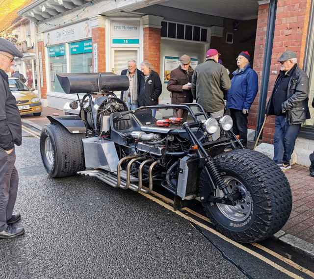

This...thing...definitely fitted the bill.
I mean...just look at it!
I was thoroughly expecting this to be something purely to be trailered to the odd show for amusement value only until I walked round the corner.
It's only road legal! Taxed and tested too.
Obviously built before the current IVA rules came into force which would render building something like this today totally impossible for road use. Though irrespective of when it was built I suspect using the rear engine on the road would be rather frowned upon!
Yes, that rear engine does appear to be functional, and if I'm not mistaken is a Rolls-Royce Gem - so about 1000hp worth. Something this small would shift...rather well I suspect with that much shove.
I'm not usually one for wacky one off things built just because they could be...but this one really appeals to me. It must be a royal handful to drive irrespective of power source, especially as there's no linkage between the bars and front wheel, so cornering lock is basically limited by how far you can lean - and with that size of a tyre up front with no small amount of weight on it I doubt it's light.
I am very jealous of the owner and slightly in awe of them if they do actually drive it more than a few miles a year. Irrespective, I really want a go!

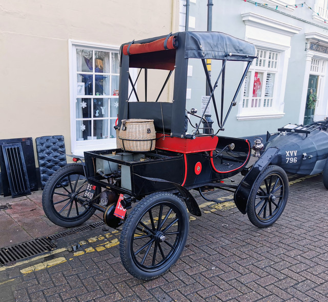

I'm really surprised how expensive Model-Ts aren't. Yes I know they're not exactly something you can use every day, but given the age of them and historic importance in the story of the car they just seem a lot cheaper than I'd expect. Always have done. If I had a decent sized covered storage space I'd really be tempted by something like that as a weekend toy.
The little details are so nicely thought out and so different to what we'd consider normal these days. Your temperature gauge for one.
I have been lucky enough to drive a Model-T, albeit only once. I thoroughly enjoyed it. Best advice to anyone else: Don't try to think "this is the equivalent to that control..." - Just try to forget everything you know already and listen to your tutor who is telling you "this control does..." And hopefully you should be fine. Around 40mph has never felt quite so fast though!
While I may be able to middle my way through driving a Model-T, I'm not totally sure where I'd start with this!

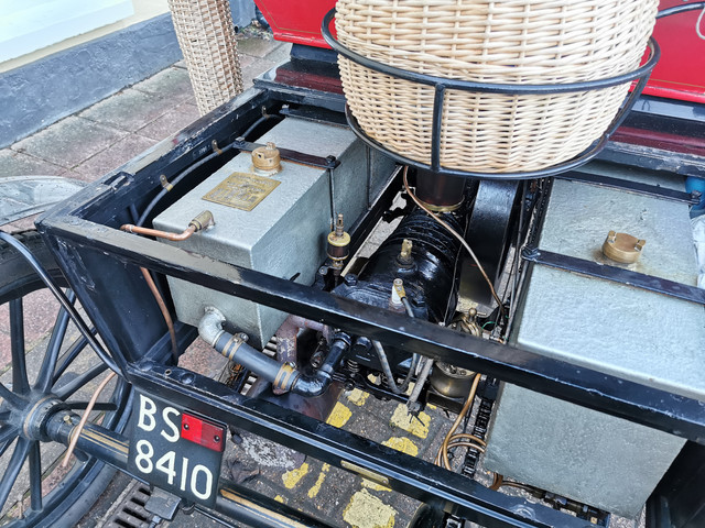

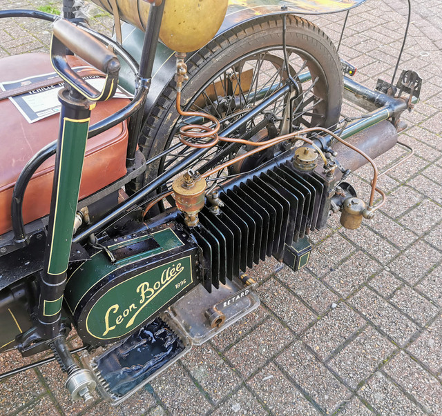

Dating from 1896 this really is from the dawn of the motor vehicle when most people would probably have still assumed steam was the way forward and that the new fangled internal combustion engine things would never catch on.
This thing is fascinating. Here's what the engine looks like.
I wouldn't even know where the heck to start driving this...looking at it just for a few minutes there are a bunch of controls I've no idea of the purpose of!
It's interesting to see that the Model-T above dates to 1915, this thing from 1896, and in the middle in 1903 Oldsmobile produced this.
Which very much ticks the "horseless carriage" description really. Underneath where the luggage rack normally would be there is an engine, albeit barely recognisable by today's standards.
I think looking at the controls though that I could figure out how to drive this though given a bit of time and a nice big area to experiment. I saw this pull in though and it sounded lovely. I know plenty of stuff built in the last ten years which don't run half as smooth - and given this only has a single cylinder that's saying a lot!

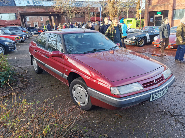

I swear I recognise this XM, the reg number just seems really familiar though I can't place it for the life of me.

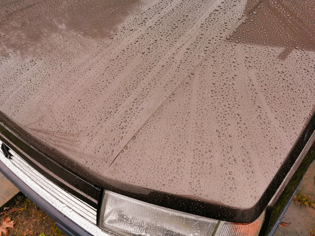

I only did the bonnet, but I wanted to see how the paint would take the a polish/wax. Still feels quite rough to the touch as there's so much ingrained crap still in there - really wants a good machine polish/clay treatment, but that doesn't surprise me in the slightest given how absolutely disgustingly filthy it was.
Does look better in the rain now though.
Have to wonder how many years it is since water actually ran off it like that.

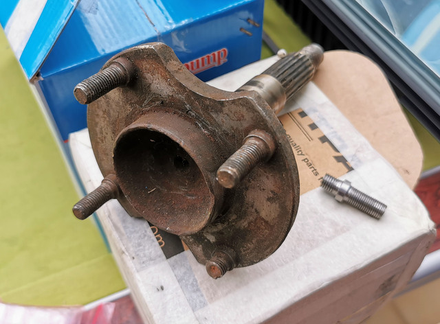

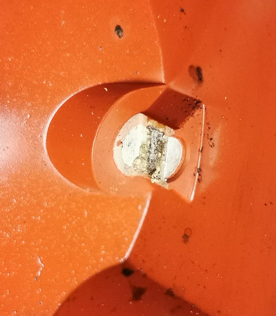

Some of you may recall back in September 2019 I had an issue with a snapped wheel stud. At which point I discovered that the studs on these hubs are not a standard off-the-shelf part. I then made my life even more difficult by making an utter hash of drilling out the remains of the one stud which refused to come out and damaged the hub itself. So I have wound up with one odd wheel bolt going in where I had to drill that one out larger - which I've never really been a fan of.
This spare hub has a broken stud in it - but I'm not about to make the same mistake as last time. This will be a good opportunity to check if our prototype replacement stud is a good fit.
First step will be to get the damaged one out - though I now know there's a blob of weld over the inner face, so I'll zap that off with the grinder before trying to wind it out this time!
Watch this space. We might actually have a properly sorted hub on the car soon, which will do a lot for my peace of mind.
