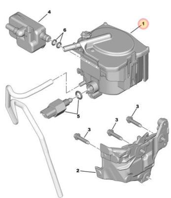

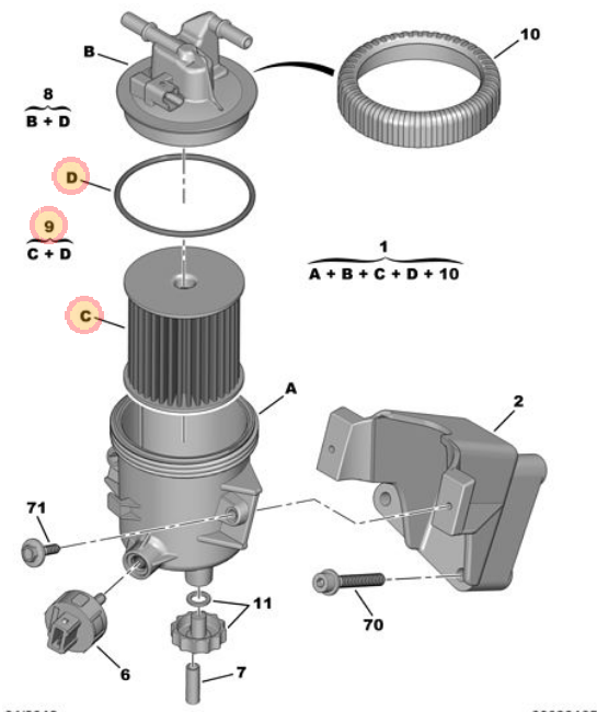

Diesel Filter
Filter and Seal Item (9)
OEM Original, Part: 1906A6 (100x80x80), £37.97
Peugeot Cheaper variant, part: E148135, £9.17

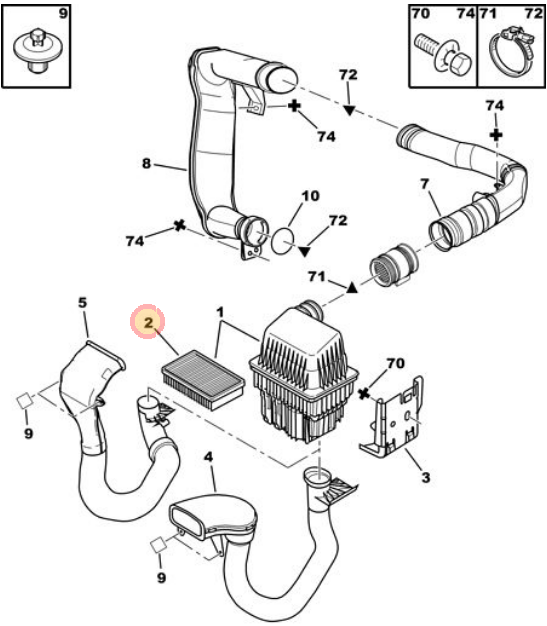

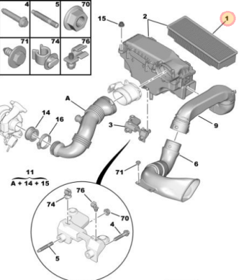

Air Filter
Item (2)
OEM Air Filter, Part: 1444TZ, £32.44
Cheaper Air Filter Part: E147241, £10.24

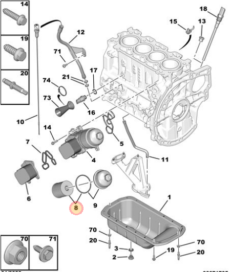

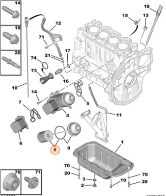

Oil Filter
Item (9)
OEM Oil Filter (Purflux), Part: 1109AL, £15.48
Cheaper version, Part: E149134, £7.01

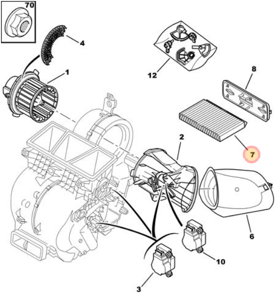

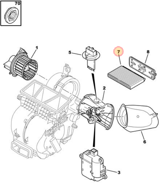

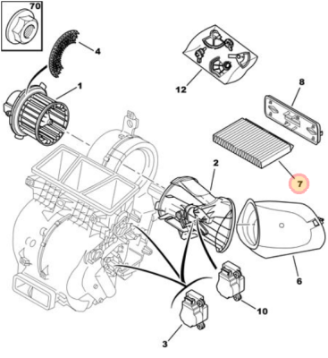

Pollen Filter
Note
There were 2 possibilities for the Air Puller Fan that could of been used: Either a Magneti Marelli system or a BEHR France system. Each have different Pollen filters. I can't advise as to which system you have fitted, so it may be worthwhile pulling out the old one to determine the original markings / identification first. I have provided both types here:
Option 1 Magneti Marelli System
Item (7)
OEM Pollen Filter, Part: 6479C2, £30.72
Cheaper Version: E146155, £8.72
BEHR France Version
Item (7)
Only one filter available, Part: E146177, £18.16

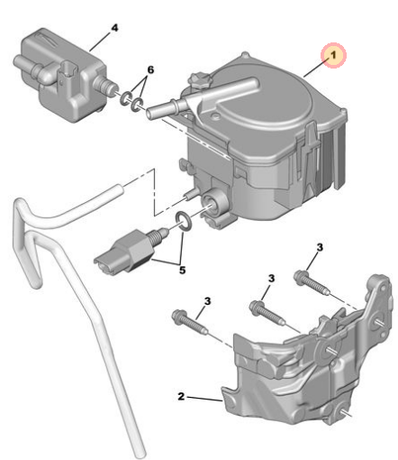

Fuel Filter
Item (1)
OEM Fuel Filter Part: 190195, £56.88
Cheaper Filter, Part: E148068 £36.16

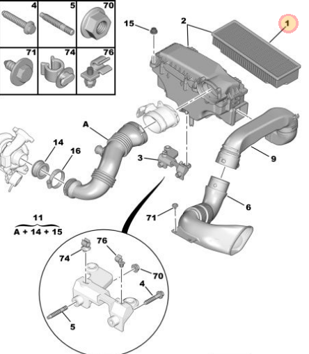

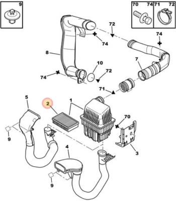

Air Filter
Item (1)
OEM Air Filter, Part: 1444TJ, £32.44
Cheaper Filter, Part: E147242, £9.54

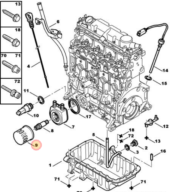

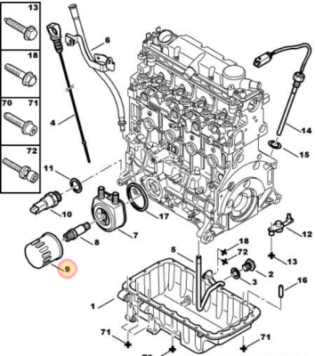

Oil Filter
Item (8)
OEM Filter, Part: 1109AY, £16.82
Cheaper Filter: 1680233480, £9.34
Item (9) Oil Filter Cover, Part: 1103K4, £61.22

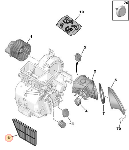

Cabin / Pollen Filter
Item (6)
OEM Carbon Filter, Part: 6447PE, £43.36
Cheaper Carbon Filter, Part: E146242, £24.47

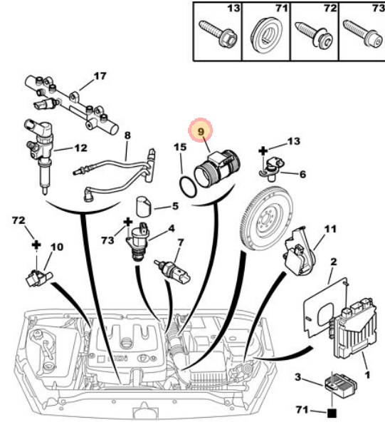

My vin 307sw ,VF3**************[VIN obfuscated, can be read by forum staff] Marc can you confirm my fuel pump and injections are they siemens ? Many thanks
Also the maf sensor played up yesterday car went to limp mode , my thoughts were it got so hot under the bonnet the air temperature was to warm and maybe it couldn't work out what it needed to do so car came up with the mil light & anti poll fault. Its been ok since. Was rather hot yesterday were i was driving. Plus a part number for the maf sensor to , many thanks.
:-D
x 6945
Your Engine ECU and Injection Pump are indeed Siemens.
Item (9) MAF, Part: 19207S, £231.92
