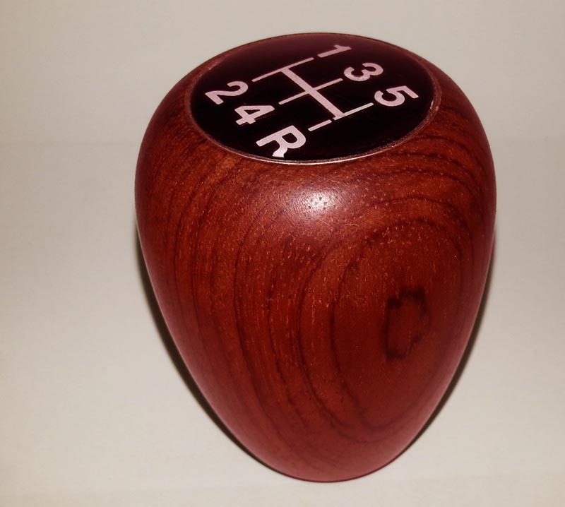

I had to use a knife to scrape the crap off it before sanding. it was horrid thick, I thought it was the varnish....but no..YUK !!!!!
superloopy
- Posts: 3344
- Joined: 30 Mar 2005, 03:25
- x 19
Re: I have become an Activa owner...Project Stictiva-V6
Does the gearbox just pull off or are there any 'fittings' involved. Mine's not looking good but i'm fearful i'll smash it. Once tried to clean it up in situ but made a pigs lug of it.

I just (sharply) turned it to the left and it lifted off....it has left the plastic on the stick. I do not know if that is the correct way but that's what epoxy is for

Nice job on the knob Alasdair
Most I see are really grotty and it spoils the whole car. Mine is fine but I guess it has been refurbished with some really good varnish in the past - by the previous owner maybe...

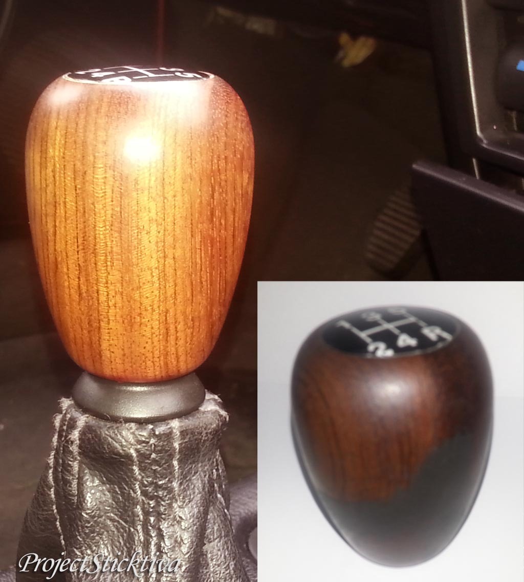

Before and fitted.
One note, to remove the knob, PULL UP after releasing the gear stick gaiter___DO NOT Twist it as this will shear the lugs off the plastic...which had been done on mine hence the confusion.
This removes the Knob with the gaiter attached, put the knob in a vice (protect it) and pull up on the plastic sleeve that attaches to the metal stick and fits inside the knob

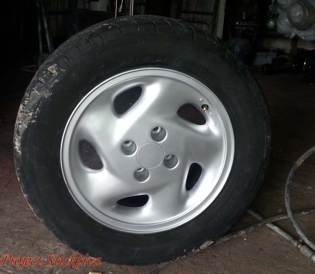

Well, after my little "come together" with a nice big blue EURO Pallet I needed to referb a spare Activa wheel.....so I did.
(and No, the HedgeJumper" tire is not staying on)
So, Alloys or "steelies" ?
