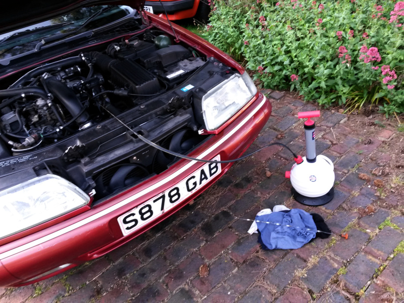

First thing that happened was that I managed to unearth my Pela oil drainer...it was only moderately structural in the garage!
Got to love the lazy man's oil change...Literally didn't get *any* oil on my hands.

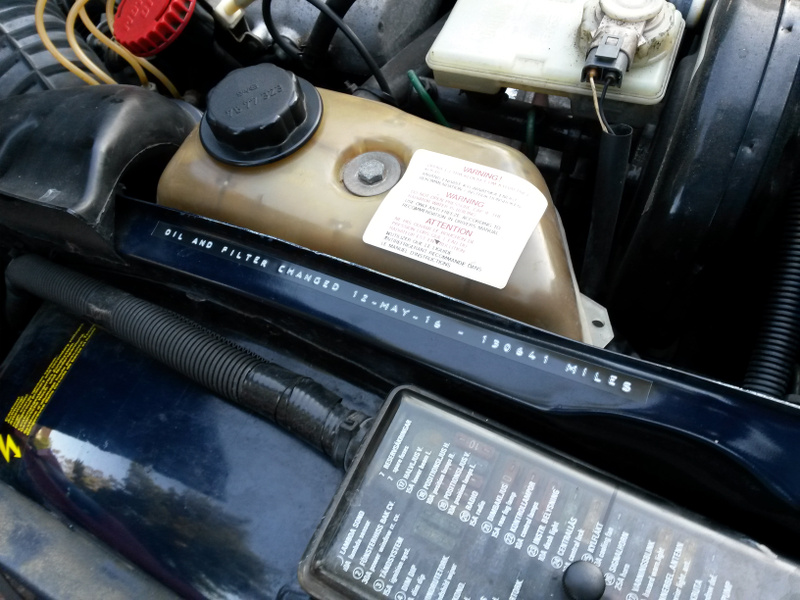

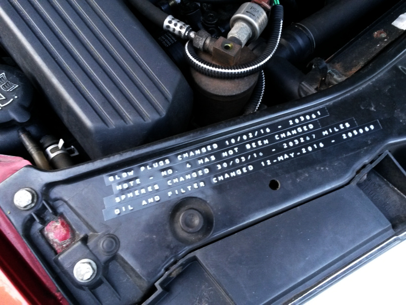

The "maintenance plate" of course was updated accordingly - air and fuel filters will be done tomorrow. This corner of the slam panel gets labelled whenever any maintenance is undertaken so I can at a glance tell whenever anything is due when doing my weekly checks. It's a practice I started doing years back. The embossed Dymo tape works best as the print doesn't fade if it gets contaminated with oil, petrol, diesel etc like the printed one does.

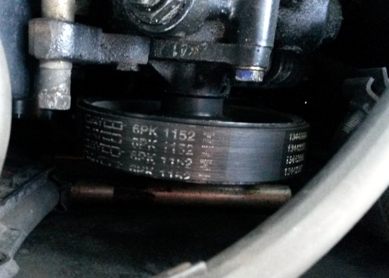

One thing that is concerning me a bit is the state of the drive belt...This only went on a couple of thousand miles ago, and is starting to look rather worse for wear.
I have noticed in the last couple of days a regular quiet squeak-squeak-squeak noise when cold, but haven't had a chance to investigate yet. Idler/tensioner failing you reckon? I do have a new spring loaded one in the box here, so that could go on if that's likely the culprit.
Will have a closer look tomorrow, only first had a chance to look at the car today and noticed this when doing the check around after changing the oil.

As for the belt, is a wheel that rubs on the outside not turning as freely as it should? Couple of idler pulleys in the belt run IIRC?

That's my thinking. Only the one (tensioner) which runs on the outer surface from memory, though I could be wrong! At least if it is that I have a new one in the box ready to go on.

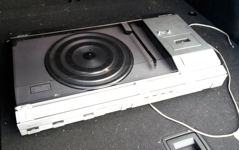

Did spot something however in the e-waste container at the local tip...This should be up your street Jim!

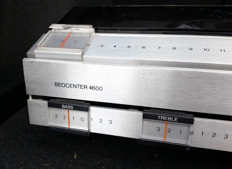

(Apologies for the terrible photo, direct sun plus brushed aluminium is always a challenge)
That damage to the volume control trim is the only thing that I can see...though obviously I haven't had a proper look yet, and won't be able until we get home tomorrow evening.
Nearly killed me lifting it out the container, thing weighs a tonne! Don't think the speakers were there - or at least not visibly, they could have been buried at the back - this was getting pretty well buried itself by the time I got to it.
Seriously though...who throws out a Bang & Olufsen hi-fi?!? It's just wrong...

Ohh nice :D I like that! Vinyl is one thing I'm not active in. I got rid of all my vinyl in the 80s and have never had any since. 100% CDs me...
You'd be amazed what some people chuck out but that, I must admit, is criminal :evil:
