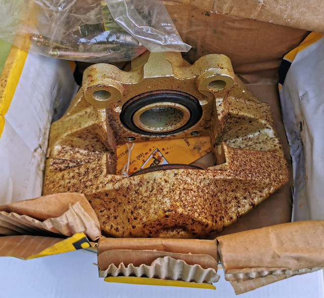

Firstly I've confirmed that the new caliper for the Cavalier will be going off to be inspected and rebuilt as necessary with the one that came off the car.
Yes it's a factory remanufactured part - but as I kind of expected, that looks to have happened somewhere probably in the 1990s and it's sat somewhere less than entirely dry since.
Would probably be fine, but I figure if I'm getting one sorted I may as well just get the pair seen to. Less likely to come back to bite me then.

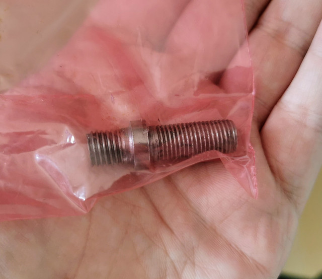

The other car related item waiting for me was this.
Which the eagle eyed of you might recognise as an Invacar wheel stud. A friend has offered to make me a few up to replace damaged ones, though it's a one off job given the time involved and obvious potential liability issues if they were to be offered as a more widely available part.

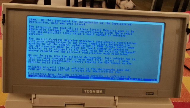

So a decent chunk of time has been spent finally putting together the webpage for the Invacar. Using an appropriate piece of hardware as my development platform of course...because I'm me.
Still bugs me that the display on this thing always looks awful in photos...this is closer to how it actually looks in person, though obviously it's pin sharp in person.
Contrast for an LCD panel from 1988 really is decent, and quite attractive with that deep blue colour.

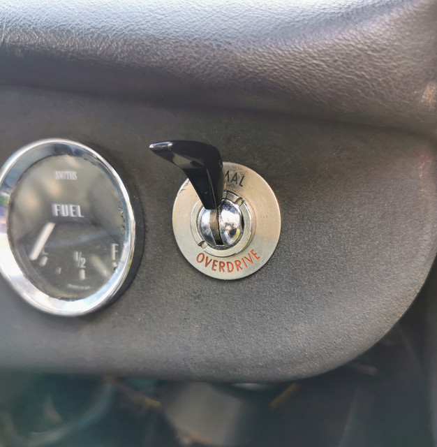

I like how they feel to drive, and this one was a lot more relaxed at speed once I noticed this switch.
This is the third time I've driven this car, however previously completely missed that it had overdrive. Heh...never said I was the brightest spark.

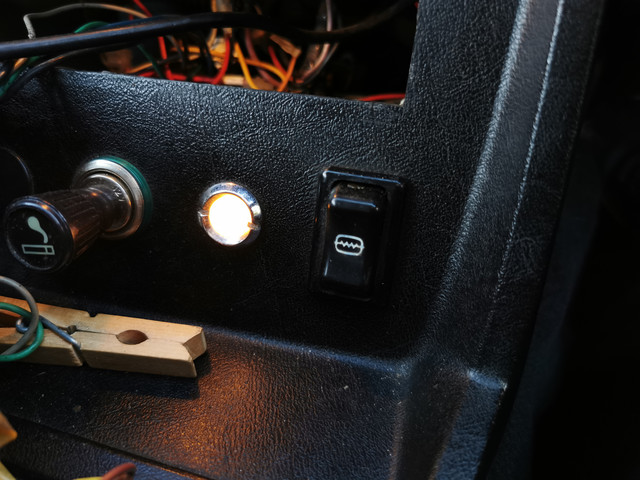

The dash lighting took precisely five seconds to solve. Giving the panel lighting rheostat a bit of vigorous twiddling pretty much immediately restored operation of the circuit. Just about visible in daylight at the right angle.
At night it's more obvious that it's working.
Well, just about! Not exactly the brightest dash lighting, but it does the job.

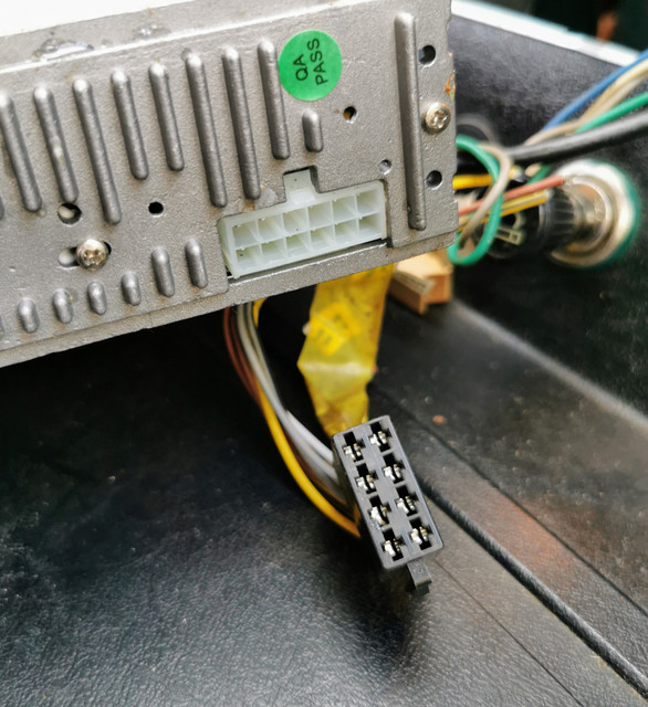

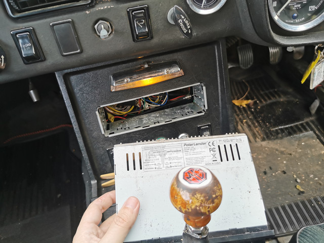

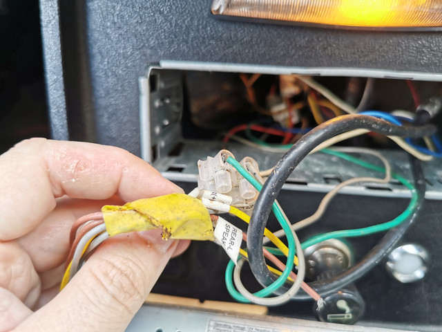

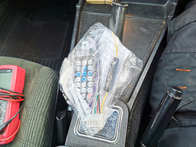

The issue with the radio became pretty immediately apparent once I pulled the head unit out of the dash.
Yeah, not being attached to anything wouldn't help! Obviously hasn't ever been hooked up either.
The wiring tail in the car was for a standard ISO connector, whereas the socket on the head unit is a finer pitch.
Helpfully the fitting kit turned out to be stashed in the armrest storage compartment.

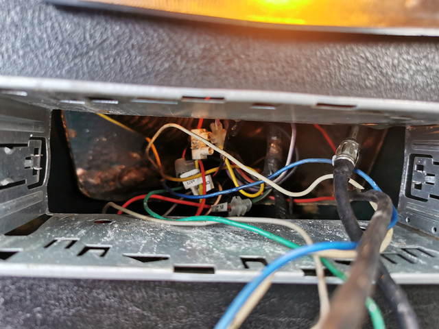

Which also gave me the opportunity to happen to this appalling mess.

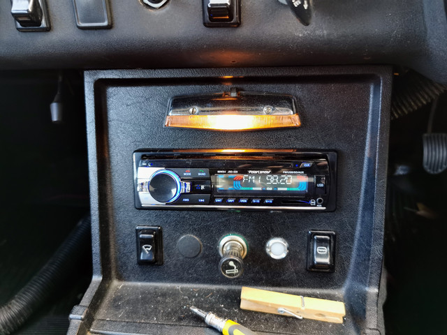

Sadly I failed to grab a photo once it was tidied up. However once actually wired up, we had a working radio.
Something more period appropriate will be going in shortly, but this is now working at least.

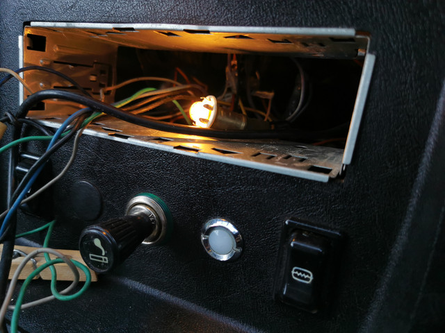

While I was sorting the spaghetti behind there I discovered the lamp holder which should have been clipped into the indicator light for the rest window demister just floating around behind the panel.
Which I naturally returned to where it should live. So that can now be ticked off the list, even though it wasn't on there to start with.
Have to wonder how many years it is since that worked.

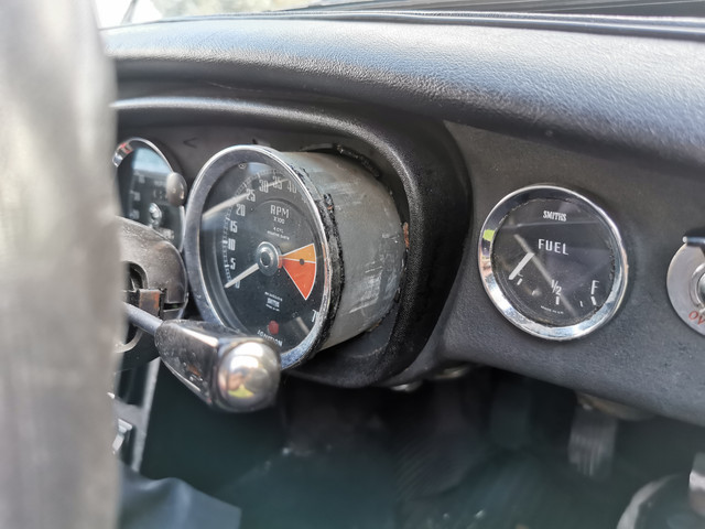

The rev counter is a little more tricky. Everything looks fine at the coil end of things, though it's spliced into the loom somewhere other than actually at the ground terminal of the coil. So a dodgy contact is still on the cards.
I figured I'd pull it out the dash...but the rev counter doesn't quite fit past the indicator stalk housing.
I literally need about another 1/8". *Sigh.*
I'll have another poke at that shortly and see if I can get it out of the dash. I have a sneaking feeling though that the instrument itself may be at fault. Especially as it has sprung back to life, albeit reading low, on a couple of occasions.

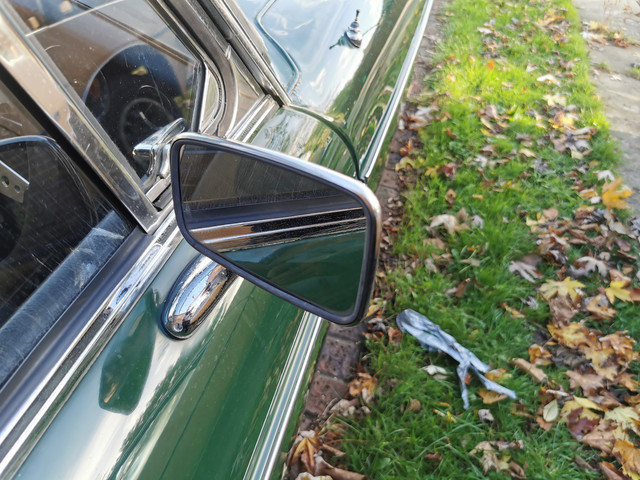

Further to the MGB work so far, I added another item to my list about 1/4 a mile into driving it. The mirrors. They both wobbled around all over the shop and rattled horribly. It was going to drive me around the twist.
There were two issues I found firstly was that the screw holding them onto the brackets were both loose. Secondly the mirror glass was loose in the units. Some closed cell foam blocks behind the glass (they had some fitted but they weren't thick enough) sorted that.
The mirrors now no longer rattle, nor do they wobble - well, no more than you should expect in an MGB anyway.

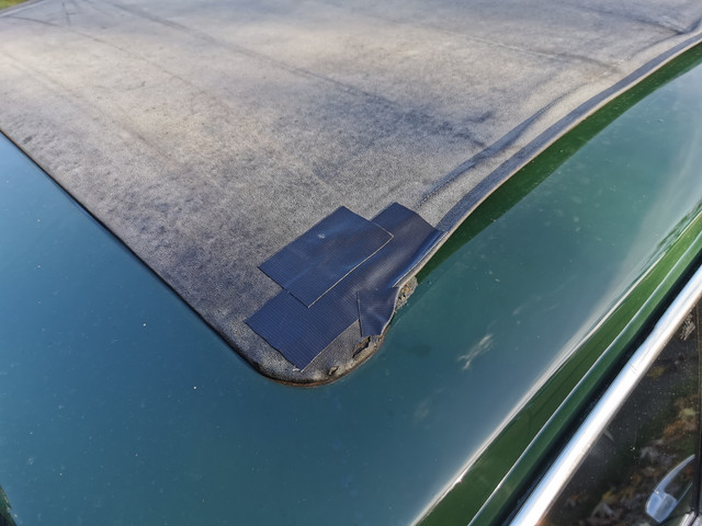

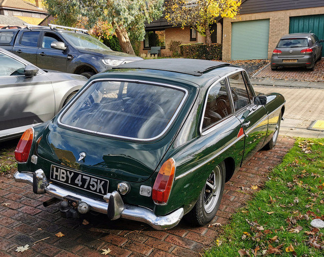

As we had some heavy rain forecast I wanted to do some temporary patching over one of the tears in the sunroof (through which you could see straight through to the cabin).
The sunroof really needs to be replaced, but this will help keep the worst out. It's definitely reduced the amount of wind noise anyway.
