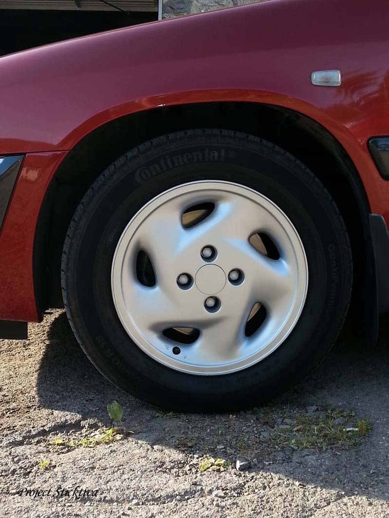

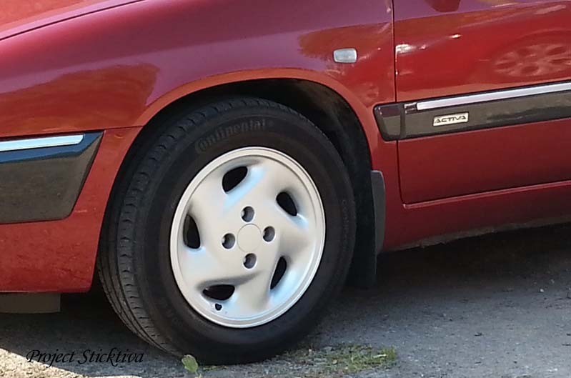

Wheels (from donor) refurbished....the original ones (same type/style) are now off getting a higher grade powder coating.
Getting very excited by the handling of this car, I am enjoying its poise and predictability but think I will swap off the Continentals and go back to Michelin Pilots as they have a stiffer side wall and suit the SC.CAR system better reportedly, any comments on that guys ?.
- Posts: 55127
- x 8411
Re: I have become an Activa owner...Project Stictiva-V6
Wheels look lovely Alasdair
- Posts: 11837
- Joined: 28 Mar 2013, 21:05
- x 1994
Tank you Jim,
Like new trainers,,,,,,they look very bright at the moment.

Those wheels look gorgeous.
My Activa wheels still look like new, they've got a cracking shine to them still but they're just starting to corrode around the valves so I'll need to get them done at some point.
Still trying to decide if I should have mine resprayed to make it factory fresh or just leave it and drive it then when it's peppered in chips have it done.
Looks great from a distance but up close it annoys me!
David.
David.

Thanks chaps.....I did these wheels myself, the good ones as said are off for full "service" and will be powder coated to the correct colour....?? Any one know what the colour code is for Activa wheels ?
I had paint breakdown in various places however mainly in small areas only where there had been damage. The original passive coating under the paint was all OK , about three layers, one black ! so I removed this mainly with a heat gun and home made wooden chisels and scrapers. Some flap wheel work with the Dremel, filler and a good hand sanding. Some slight kerb damage was built up with metal filler.
I used an epoxy primer then silver paint I use for radiators when creating a "polished" look....some Poxhall shade, I buy the base and mix. I topped it with clear with added talc to give a silk finish. I protected it with solid wax then a finishing gel polish
