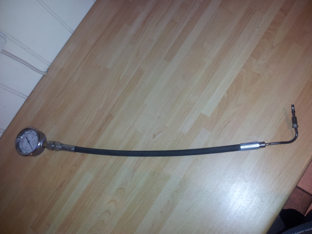

Also managed to get my pressure gauge made up, thanks Robert Smart for sending me some 4.5mm steel pipe which surprisingly I had none of!
Heres a pic of the brazed joint
It was made up by Pirtek and looks pretty sturdy! Took some persuading to get them to do it mind.
