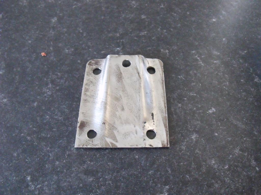

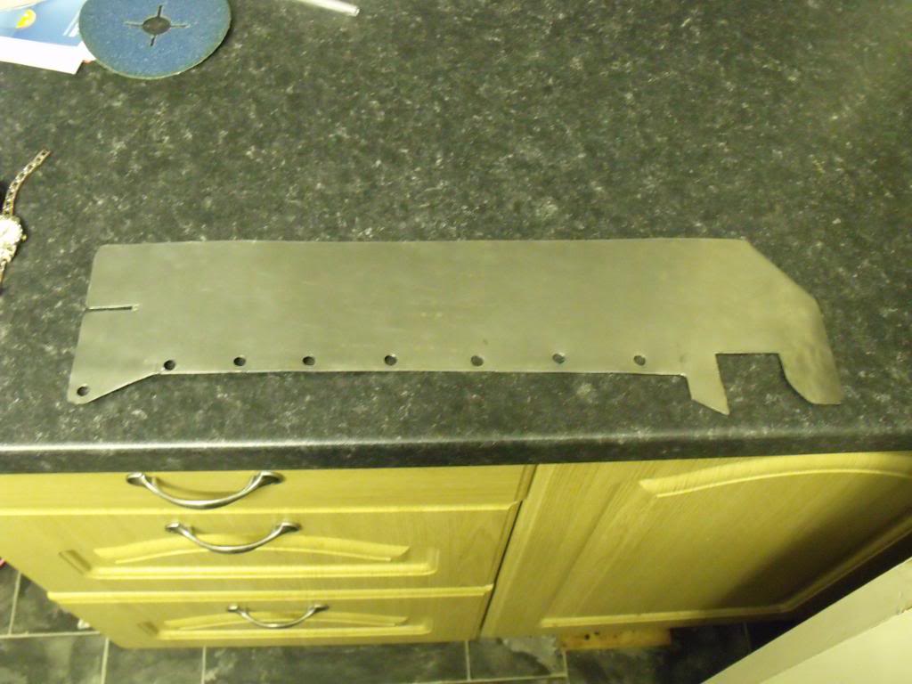

Well, that inner wing is all welded and sprayed up along with the outer reinforcing bit.
I have photos of the pieces I made up:
Inner wing section
Outer reinforcing section
Still no photos of the welded in section yet. The car is up on it's other side now waiting for a moment when it's dry, light and I have some spare time to weld in a new section for the floor. The new section is made just needs welding. I also need to crack on and make the section for the OSR inner wing, that only requires spare time and artificial light!

That looks like a real quality job on the replacement sections Kev, there is some skill there!

i quite agree supper dooper fabricating there Kev'z dad ???Citroenmad wrote:That looks like a real quality job on the replacement sections Kev, there is some skill there!![]()

I'm flattered! Fabricated both myself
Took a bit of time and working out mind!
The rolling pin and apple core cutter tool is just out of view
