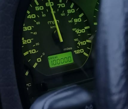

The Caddy passed a nice milestone while we were on the way to an appointment a few days ago. Thankfully I had my other half with me so was able to get evidence of it...as I was on the M1 at the time I couldn't exactly pull over to grab a photo.
Hopefully many more to come.

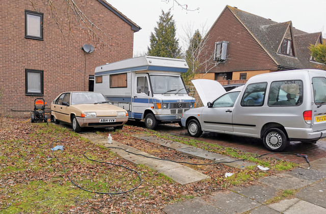

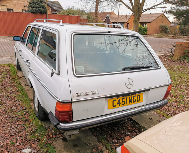

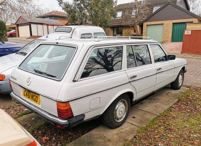

Despite suffering from a lack of a working pressure washer I needed to get the Mercedes cleaned up ready to be handed over to the new owner - this meant the best part of an hour driving around in circles until I found a jetwash that was actually working. Was the most horribly rushed and patchy job in the history of self serve car washes, but at least I had most of the moss out of the window seals and brightwork, so it looked a lot better.
Still one of the classiest looking cars I've ever owned I think.
The car rewarded me for cleaning it by blowing the offside rear indicator bulb. Of course I didn't have a spare in stock...so wound up nicking one from one of the repeaters on the van. It won't be going anywhere until the salt is gone from the roads anyway. Plenty of that a out just now...the corner of this roof was silver before a 20 minute run up the motorway a couple of days ago!
With the cleanup complete though I was able to pass the car on to its new owner. Only a few miles up the road and someone I know, so I'll still see it now and then I'm sure.
Off she goes.

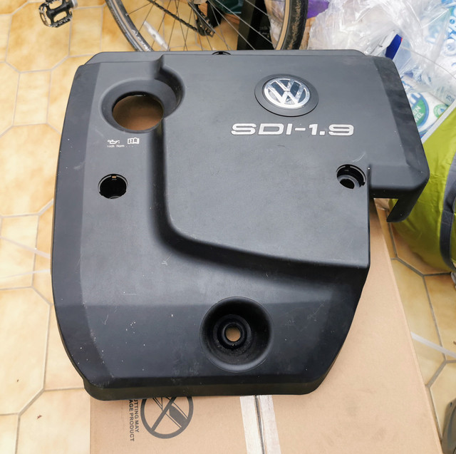

A surprisingly large parcel arrived - even more surprisingly quickly given it came all the way from Germany - for the Caddy. Got here quicker than some things ordered from an hour up the road.
Hardly mission critical, but definitely tidies things up a bit. Does make quite a noticeable difference to the noise level outside the van too so isn't entirely cosmetic. I usually hate engine covers, but this only takes about 90 seconds to install/remove and makes a good tray for putting things in so isn't a huge problem.
Does look like it's taken about ten years off the engine bay though!

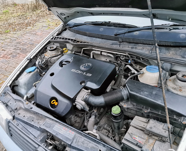

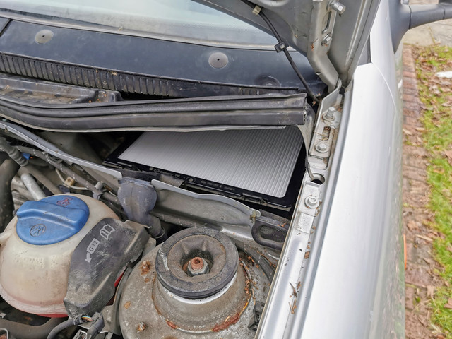

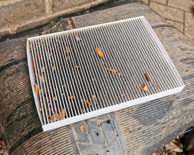

While I was rooting around in the area I dropped the new cabin air filter in. Dead easy to get to compared to many modern cars which require you to stand on your head in the footwell and/or dismantle half the dash.
I'm quite used to seeing these having never been changed so was half expecting a solid black rectangle of unidentifiable organic matter to come out, but it wasn't actually too bad. Definitely due a change but it's definitely been changed sometime in the last few years.

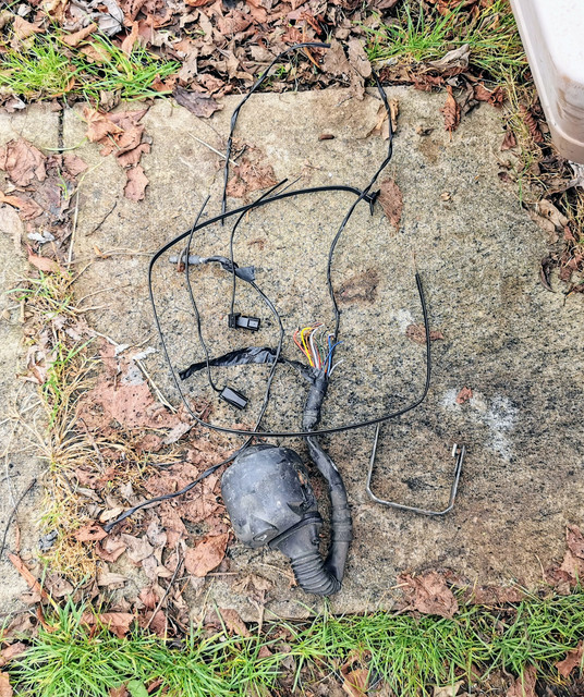

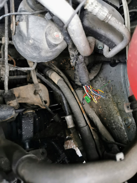

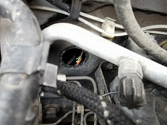

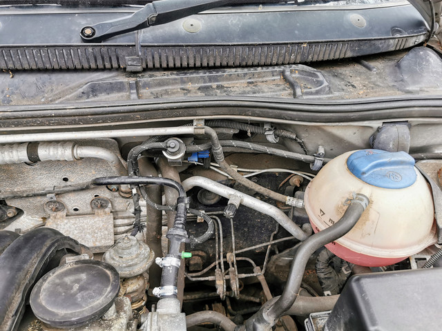

You may recall me noticing some horribly hacked wiring in the engine bay related to the obviously long defunct aftermarket alarm system a little while back.
Which had also left a gaping hole in the bulkhead.
I've now found that end of the tail (buried behind the heater box), and each of the wires has been taped, heat shrink covered then the tail as a whole treated the same way. The actual alarm module is buried up behind the centre console and I didn't have the patience to go chasing that further today.
This lot was pulled out.
The above area now looks like this. By pure chance I found a bung sitting on the drive that was exactly the right size to fill the hole left by that alarm wiring.
Much tidier.

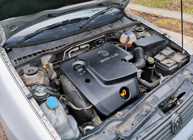

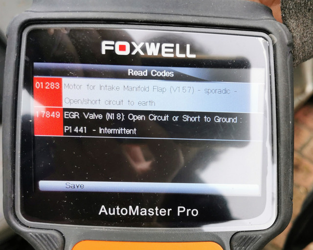

A friend dropped by today with their fancy diagnostic gizmo to see if we had any fault codes stored which might give us a pointer on what's going on with the twitchy idle/EGR issues.
As we had hoped there were a couple of codes stored.
The first of which is the interesting one.
"Motor for intake flap (V157) - sporadic - open/short circuit to earth."
The second code is expected as it's indicating the solenoid for the EGR valve being open circuit - because I've unplugged it.
This is really useful as it gives me a component to home in on with my investigation. First port of call is to make sure the wiring to it isn't obviously damaged as it is quite exposed. Then we'll give it a good clean, which it really wants anyway.

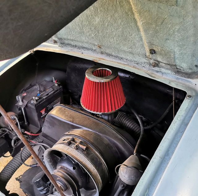

Have also come up with a temporary solution to the air filter issue. This doesn't look in any way ridiculous...
To be honest it's basically only there to keep crud out of there until I can track down/manufacture a replacement for the missing bit of the cleaner housing. I won't be driving it like this given the insurance company may declare it's a performance modification...must be good for at least a 30% power increase of course!

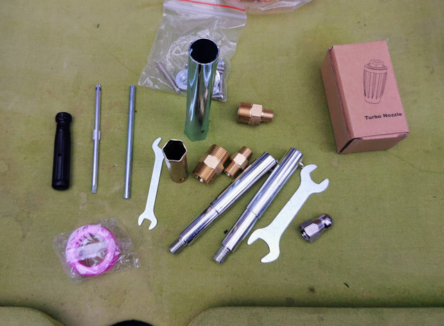

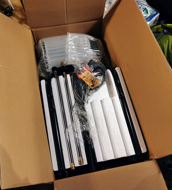

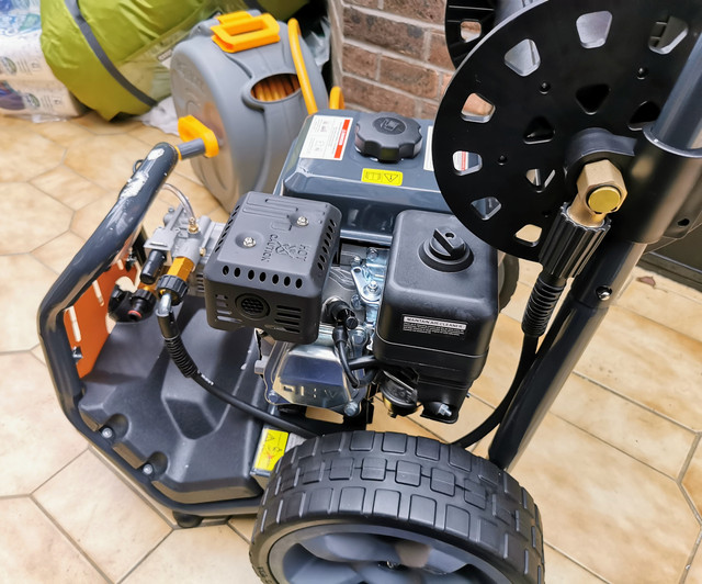

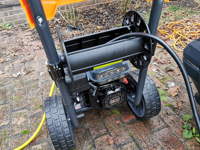

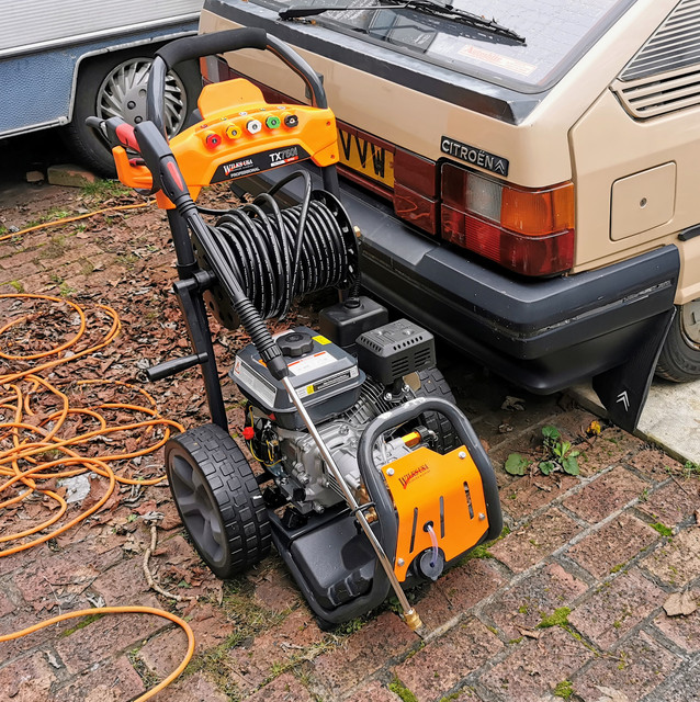

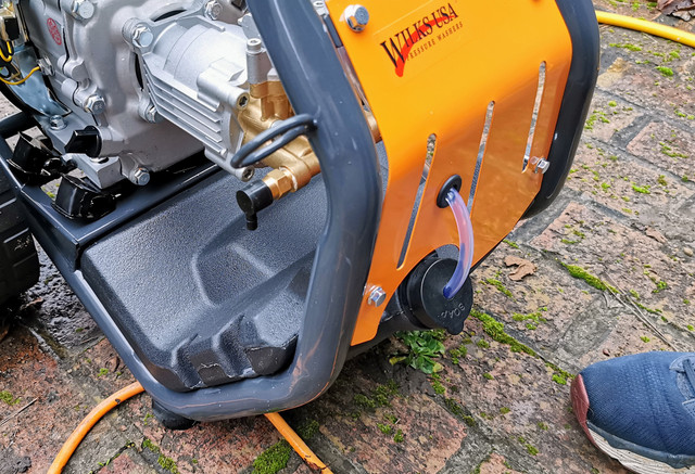

Well this box arrived on Friday...
What was in it then? Well after about half an hour's assembly, this:

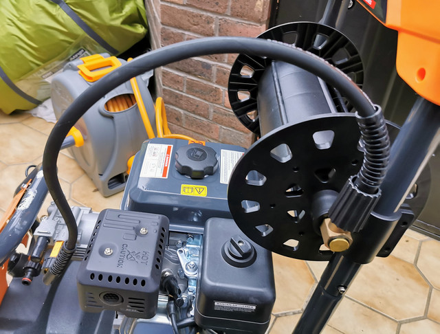

Assembly was about as simple as you could ask for - all the necessary tools and some PTFE tape were in the box.
The biggest complaint I'd seen from people in reviews of this unit was that they were managing to melt the hose that runs between the pump and hose reel on the exhaust. Have to assume they had it routed over the top of the engine...
Simple solution, route it down underneath and apply a couple of cable ties to ensure it can't get in the way.
Yes the reel is very obviously an afterthought they just managed to find space to bolt onto the frame as it does make getting to the pull start a bit awkward.
Really not badly though so long as you've uncoiled the hose, which you're meant to do before starting the engine anyway - and having onboard storage for the hose is worth it I think anyhow.
Speaking of the hose... I've got used to the pathetic four metre reach on the old cheap plastic electric one, so having twenty metres to play with feels like utter luxury. It basically used to equate to one side and a bit of a car before you had to pick up and move the whole lot. This is the new setup...
That's not even using the additional ten metre extension that came in the box. That alone will make the job of cleaning anything far less annoying.

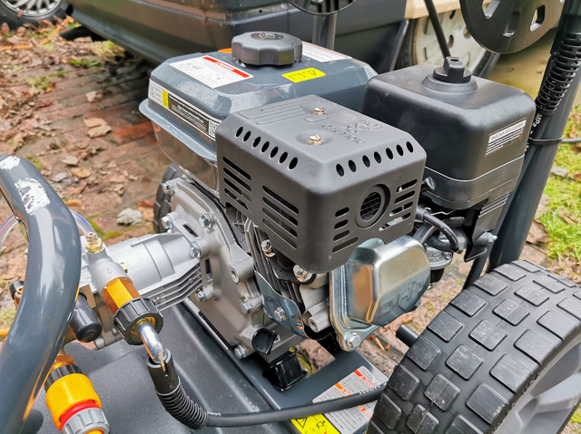

Fit and finish is a lot better than I was expecting to be honest. Just a shame the polystyrene packing has reacted with the paint on the frame in one spot. Everything slotted, clipped or screwed together nicely as it was mean to and I had no issues with sharp edges or burrs on anything.

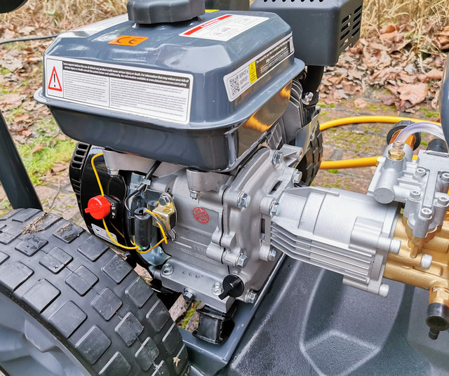

Engine is your typical Honda clone which turns up on everything from go karts to lawn mowers to generators...and while I'd obviously prefer the real thing (or being me to be honest, a flathead Briggs), I've never personally had any issues with these on any of my equipment or anything I've helped others look after. If it was being used for hours on end every day, maybe. For a couple of hours every week or two it should be fine.
It does have a low oil shutoff, which is always nice to have on a piece of equipment like this.
The detergent tank built into the base is a nice detail rather than just a hose dangling off to dip in a bottle (which inevitably gets either lost or broken) or an awkward thing you have to clip to the lance like the Nilfisk this replaces had.
As for performance? Well you'd expect it to have more punch than the 1400W electric ones given the engine here is rated at 5500W if my math is right (8hp). Yep...that's definitely the case...you properly have to brace yourself when pulling the trigger on this and use common sense as even with the wider nozzles fitted I don't doubt for a second that this thing will strip paint off metal if you're not careful.
Hoping to give it a proper test in the week, today was just a run of a few minutes to make sure everything behaved, and allowed me to blast some of the worst of the gunk out of the gutters and after a dousing in degreaser, the engine bay of the Caddy. Not an oily engine anyway, just grubby from 20 years of use. The washer bottle is going to need separate attention, but it generally looks a lot cleaner now.
Cars are much more likely to get cleaned now as this reduces the hassle factor massively!
List price for this is £379, though it was discounted to £330 when I ordered it - decided it was a good thing to stick the £100 or so of vouchers I've had sitting around literally for years to use for - plus my nan sent some money at Christmas too...so good excuse for a new toy I reckon!

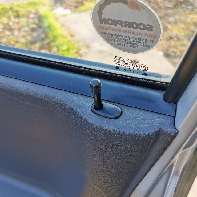

Broken driver's door lock pull has now been replaced as it was bugging me.
The pull for the door lock on the driver's door was broken off at the top and it was bugging me. For the sake of less than £2 from a breaker it made sense to change it - they just unscrew.
Little details, but together they help make the big picture and make the car nicer to drive.

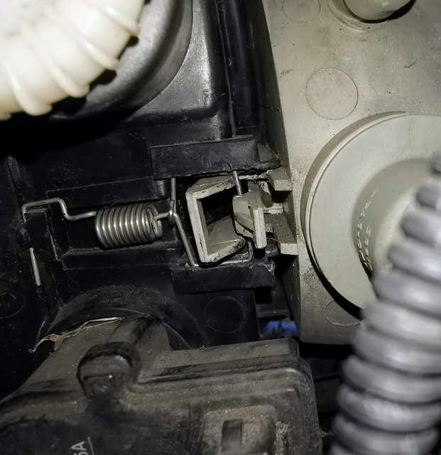

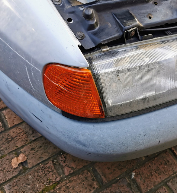

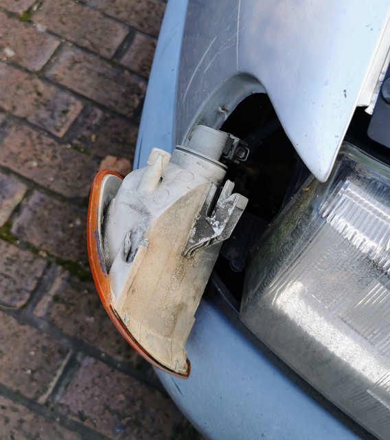

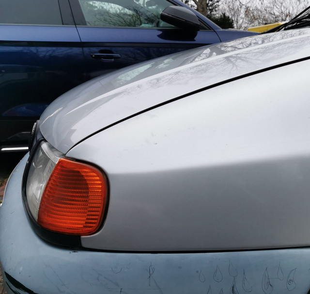

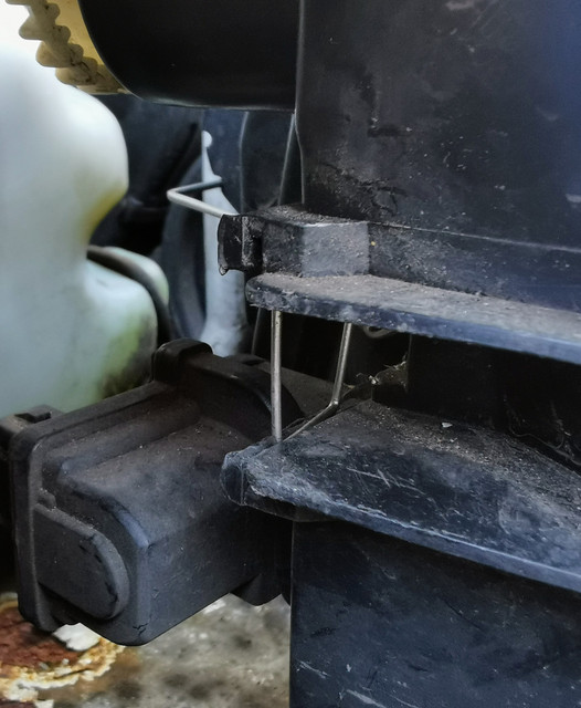

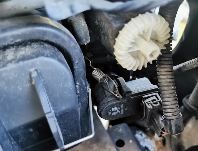

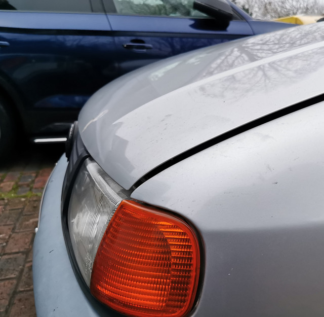

Figured it was time that I did something about this.
I was getting fed up of having to shove it back into place every other trip.
A tip from someone on another forum suggested that there was likely a spring clip meant to be holding things in place based on their experience on older VWs so I went looking.
Sure enough I found one behind the headlight doing nothing.
Took a bit of figuring out that the spring was actually meant to fit into a groove on the back of the headlight, which has been deformed in this case so it doesn't fit very securely, the bottom edge kept popping out of the groove.
In the above photo you're looking into the hole the indicator would normally be in, the front of the van is towards frame right.
Once I figured out how it was supposed to fit together it didn't take long to get it reassembled.
That's looking at the back of the headlight from inside the engine bay.
I've noted that one side of the plastic peg that the spring hooks over is cracked (which is why it's sitting at a bit of an angle) so it will need to be replaced at some point. Not a big issue as they aren't expensive.
For now though it's properly fixed in place again and doesn't fall out if I brake firmly.

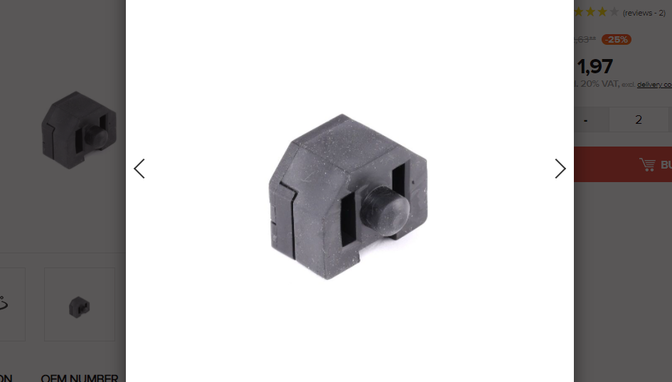

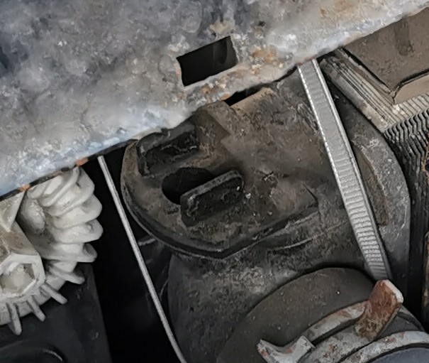

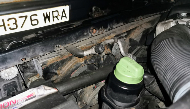

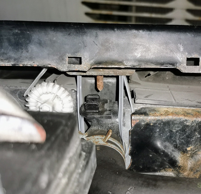

I do have a question though for folks who know these cars/vans better than me.
Does anyone know how the radiator etc should actually be supported? The top of mine is currently secured by cable ties (having previously been hanging by the coolant and AC refrigerant lines) as there is no evidence of any viable means for it to be secured to the underside of the slam panel. I've also completely failed to find photos online of anything which looks like what's in place in my engine bay - not sure if that's just because AC wasn't a common option on the Polo/Caddy back in 2002 or if I'm just useless at internet searches. It's pretty obviously wrong in most cases though as the majority of them only have a position available for a single fan, whereas I've got two. The ones I have seen with dual fans show two which are very different sizes, and a plastic cowling...rather than these two which are pretty similar in size (the offside one is a bit bigger) and a metal cowl of quite a different design. So I'm confused.
I'm guessing that there should be some form of bracket/block/fitting...thing...that secures the radiator to the bolt through the slam panel on both sides.
There isn't a threaded hole or anything on the radiator for that bolt to screw into by the way - I did wonder if it was that simple, but no.
Attempting to trawl Google for anything helpful has proven completely fruitless...and in fact about 70% of the radiators shown don't even have *any* tab/bracket etc at the top corners shown at all. I'm basing this on Polo stuff, as trying to search for Caddy specific things is completely hopeless as the search engine totally ignores 2002 and just spits out a plethora of matches for the current models.
I don't think the radiator can be lifted very much as I think the bottom end (which feels like it's located by pegs rather than bolts given it moves pretty freely vertically) will then lift out of whatever retains it down there...which makes me think that there must be something missing between the slam panel and the top of the radiator. It's one of those situations where I know the solution is probably dead simple, but without a proper diagram of how it all fits together I'm just guessing.
I could pull the bumper off to try to get a better look at things, but with it looking like something is actually missing I don't really know what that would gain me anyway other than being able to see that something is missing...
The only other job I've done today was to replace the headlight bulbs. They looked pretty well done based on the condition of the filament and the new ones do seem a good bit brighter so I think they were due a change. Still not great, but I can actually see they're on in town now which is an improvement.

You could try giving Davie (daviemck2006) a shout, as he has a Caddy as well.
https://www.frenchcarforum.co.uk/forum/ ... start=3840
Posts: 26419
x 7164
Re: Zel's Fleet Blog - BX, Jag XJ-S, Sinclair C5, Mercedes 208D & 230TE, AC Model 70.
May be irrelevant, but then again could be just the thing you are looking for :-D
Auto doc has these "radiator mounting blocks" appearing if you select VW Caddy II Estate 11/1995 to 01/2004 (9K9B) 1.9 SDI Diesel 47/64 hp , common to many variants of that age of Caddy.
https://www.autodoc.co.uk/

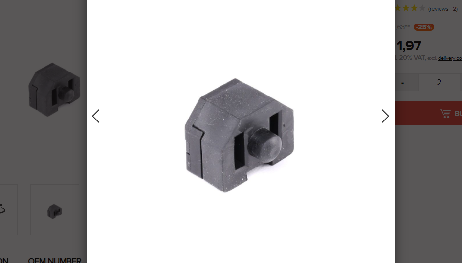

That definitely looks like it would attach to the radiator - though the space above it looks big enough that there would need to be another spacer of some sort involved too...though that's easier to engineer if needed at least.
You can see the attachment point on the radiator better here.

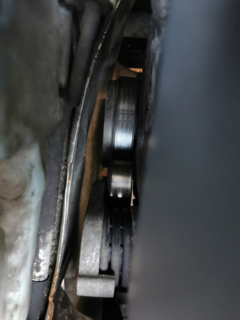

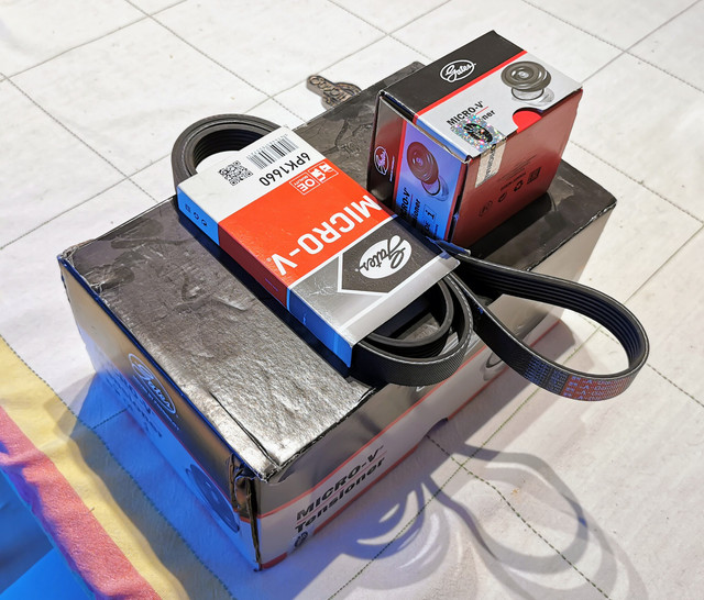

Noticed that there's a slightly noisy pulley in the aux belt area on the Caddy. It's not bad, but with a long drive coming up at the end of next week I'd rather get it changed as a precaution. The tensioner in particular looks quite rough so that's my prime suspect.
I'm not used to being able to walk into the motor factors and just get parts rather than having to wait several days for things to be ordered in.
Guess this is the upside to owning something made this century!
£130 later and we've got a new belt, tensioner and idler pulley.
I'm not sure which it is that's making the noise so just picked up both. Depending how much of a pig to get things off are I may just change them both for peace of mind.
Just need to figure out how to de-tension the tensioner, as that's going to be a major part of the job I think.
Hoping it's not a major pain of a job to change...it looks *relatively* simple which has me worried!

Okay, that's going to be one of "those" jobs then is it...
Only way to get a spanner (can't be a socket as it's too close to the chassis rail) onto the tensioner to back it off is from underneath, which means I need to get the under tray and wheel arch liner out.
That ain't happening today with how windy it is.
At least the actual bolts holding the tensioner to the engine are pretty easily accessible. However until I've safely restrained the world's strongest spring that's not a lot of use to me.

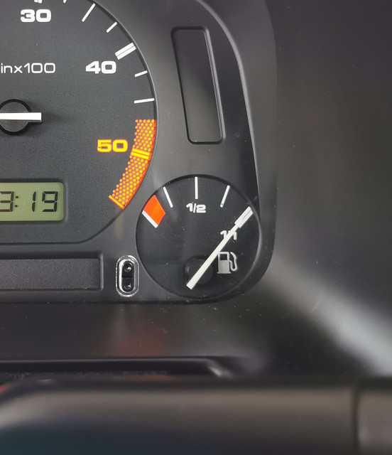

Loaded up this morning - reckon we had about 85% of the luggage being taken with us, 100% of the bulky items for certain.
Fuelled up yesterday so didn't need to mess about with it this morning.
Wasn't quite sure if I'd need to stop for fuel en route as I'm usually filling up after about 330 miles of running around. This was the projected mileage for our trip.
