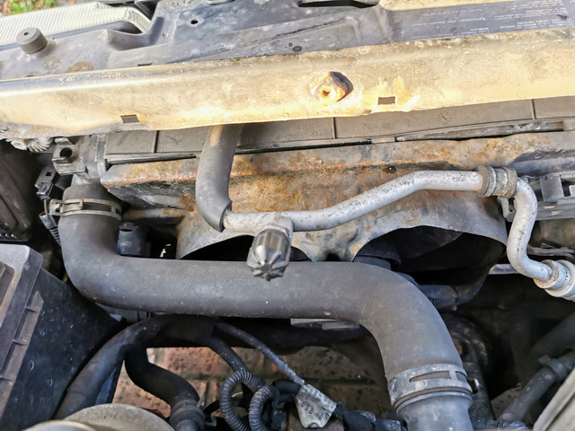

Having a slightly more in depth look under the bonnet than yesterday I spotted a couple of things amiss.

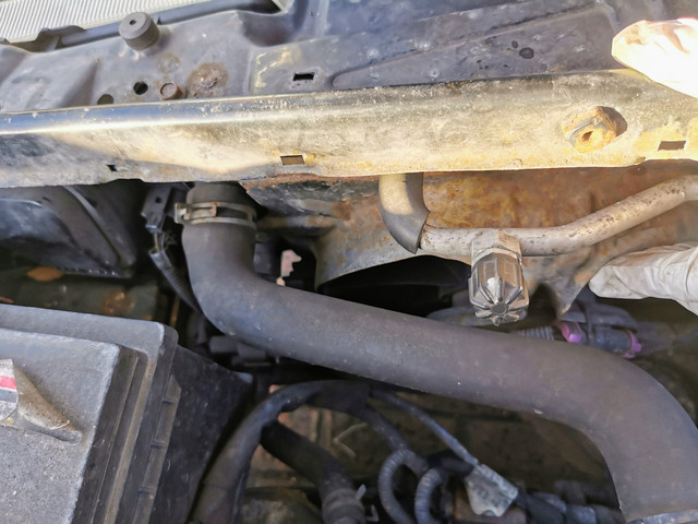

Firstly, looking at the radiator something just didn't look right. How the top hose was sitting was what really drew my attention to it initially.
A little poking and head scratching revealed that it should actually be sitting more like this.
The top brackets appear to have either fallen apart of are totally missing. Strange.
I deployed a highly technical cable tie to pull it closer to the right spot until I can properly Investigate and resolve that...has at least got some clearance between the top radiator hose and fan shroud now, this was previously touching.

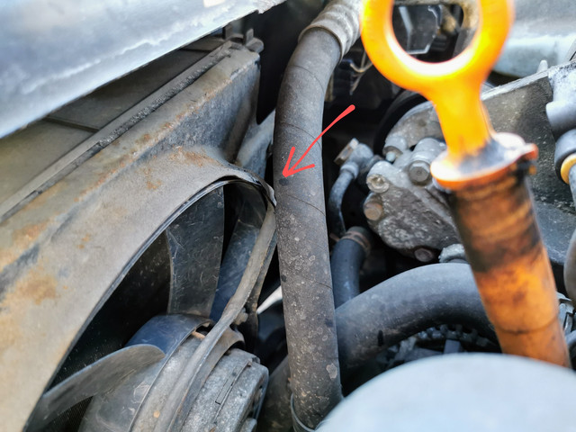

On the other side the shroud had worn quite a deep groove in one of the air conditioning lines too, this now has a bit of actual clearance.
Will need to see if there is any gas in there whatsoever soon. I suspect not.

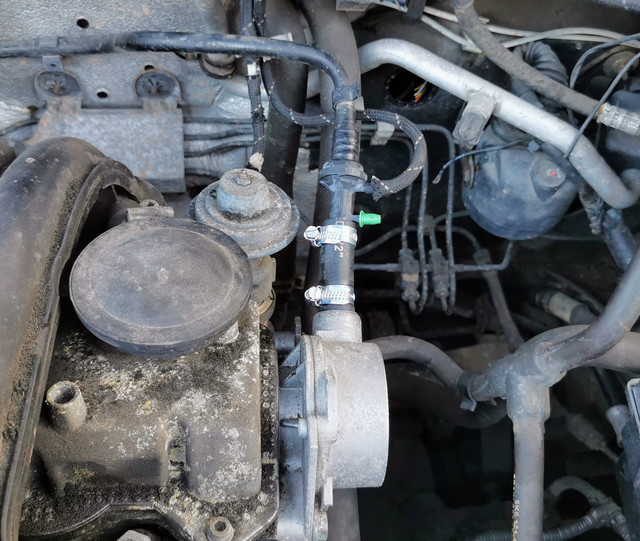

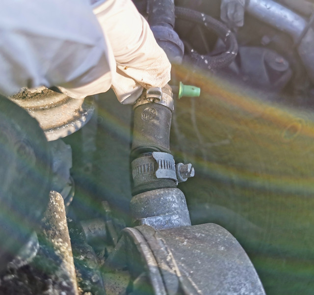

Then I noticed this.
That's the state the main line coming off the vacuum pump was in. That's not going to be doing anything any favours, especially as at the very least the actuator for the EGR system is vacuum controlled, and there are lines running off to several bits and pieces around the engine bay.
Ten minutes later it looked like this instead.
Sorting this appears to have completely eliminated the hunting idle, the ever present smell of diesel and obvious white smoke on the overrun/light throttle openings. It has also made the throttle response far smoother, so that leak was definitely causing issues for a few things. Likewise the brakes definitely feel stronger now, so I think the servo was also struggling a bit for vacuum pressure before.

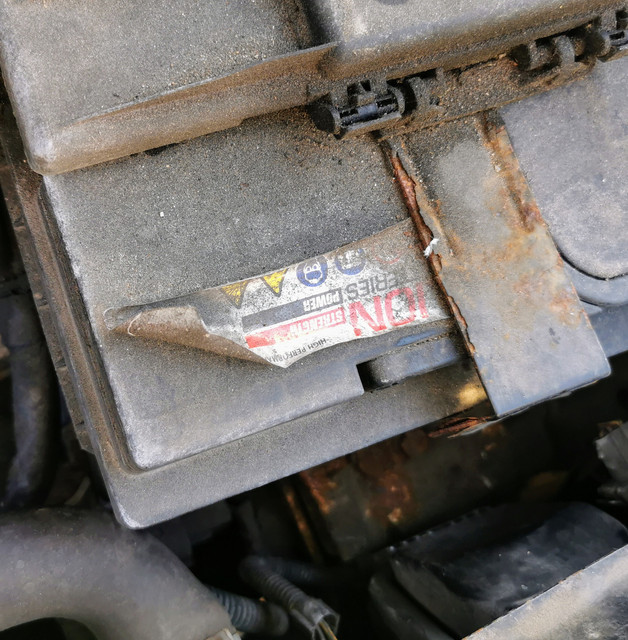

Not much to report today. Had to take my husband to a hospital appointment this morning, so have confirmed that cold starting doesn't seem to be an issue for the Caddy, even at -4C that we had today, and oddly is the coldest we've seen this winter so far. All despite the rather old looking Lion branded battery, which I'd generally trust about as far as I can throw it.
I think the best I've ever got out of one of their batteries before was about 18 months, so I'm already mentally budgeting for having to replace that at short notice at some point.
This temperature also meant I was surprised to find that for the first time since I think 2009, I have a car with a full compliment of working rear window defroster elements.

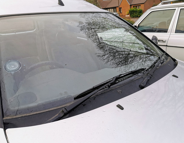

Something which become extremely vocally apparent during that trip though was that the wiper blades were past it. Cleared the screen okay, but unless it was absolutely saturated wanted to jump, skip, judder, squeak and generally make a nuisance of themselves. I did clean them as they didn't look all that old, did help but not by much. So a new set went on.
This restored quiet and calm to the cabin while driving in the persistent drizzle which we've had here all afternoon.

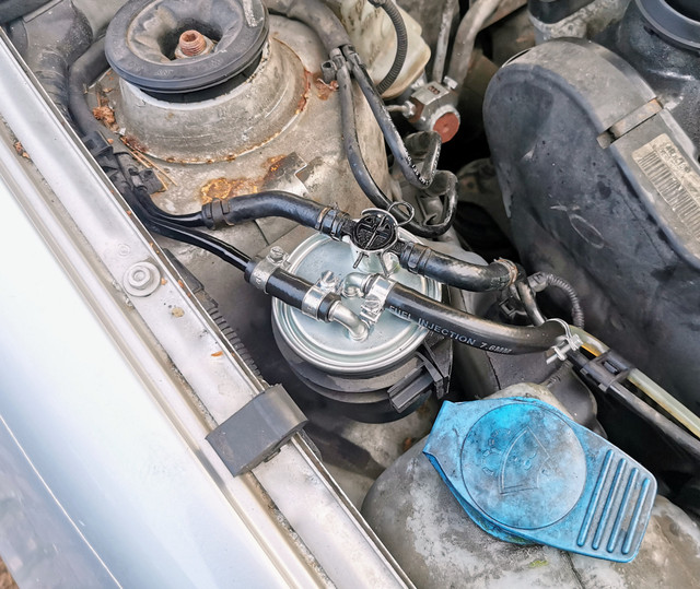

Only other item of note done today was getting the fuel filter and the feed lines attached to it replaced. Simple enough job.
Think I'm going to go back and do the ones on the return too, just didn't have enough hose clamps to go round today (I despise those spring type ones with a passion - especially the ones VW use as they have really tiny tabs on so are nigh on impossible to get hold of if you don't have the proper tool). Given I was able to pull the one on the feed side straight off, the hose had obviously been squashed enough under the hose clip that it was no longer doing anything.
One of the O-rings on the return line stub was cracked, so definitely think this was due changing.
Hopefully this will put a stop to air being pulled into the fuel system. Time will tell I guess.

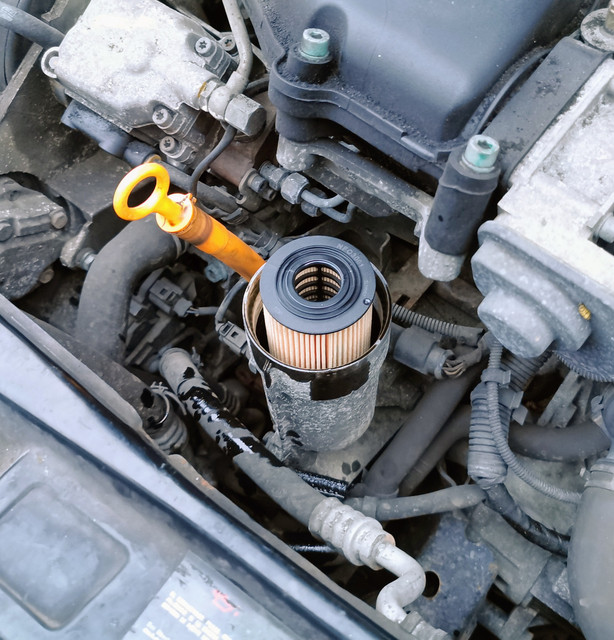

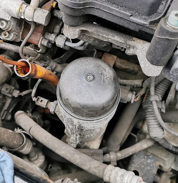

Having run out of daylight yesterday today's quick task was oil & filter change.

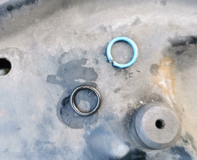

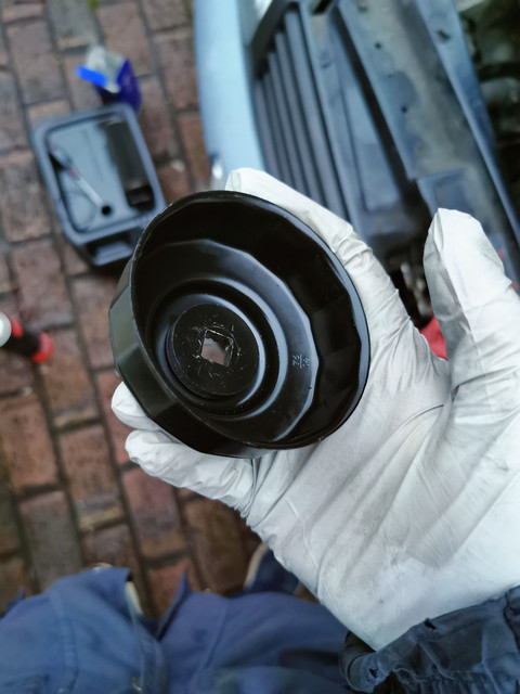

Set the oil draining, then realised something...the Caddy is modern enough to have one of these strange plastic caps over the oil filter.
...Which I've never had to deal with before. After wasting half an hour trying to get it unscrewed without the right tools I gave up and went round to Halfords and grabbed one of these.
Even with the right tool, holy hell that was tight. I wound up basically hanging my bodyweight off the thing before it eventually started to very slowly come loose. No way it was coming off without the special tool for it.
I then made a horrible mess and spilled oil everywhere when lifting the old filter out.
New one in - which helpfully has the top marked as I didn't realise they weren't symmetrical until after I'd put the old one down and lost track of the rotation.
New filter also comes with new O-rings for both the cap itself and the feed tube assembly which drops down through the middle of the filter. I made a definite point of lubricating the outer seal with fresh engine oil before reassembling. Tightening it precisely as much as necessary to snug the seal up and a smidge more. Hopefully I won't have such a fight to get the cap off next time round.
The old oil smelled quite strongly of diesel and seemed quite watery (it is 5W40 though so not all that thick anyway), which isn't a huge surprise given the van was chucking clouds of unburned fuel out the back on the overrun because of that vacuum leak I found a couple of days back. By no means the worst I've seen, but it was definitely ready for a change.

Zelandeth wrote: 10 Jan 2022, 18:21 H
I remember learning many years ago that in most engines the oil circulates round the filter in a clockwise direction. Therefore its minimal drag on the outer face is continually trying to tighten the filter whenever the engine is run. Quite a clever idea to help prevent age leaks but it does result in excessive torque needed to release them!! :-D

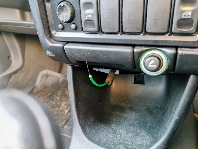

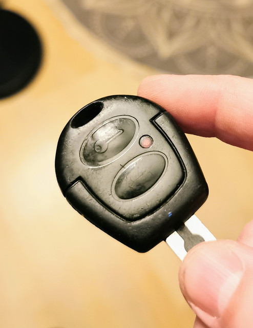

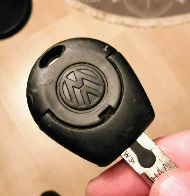

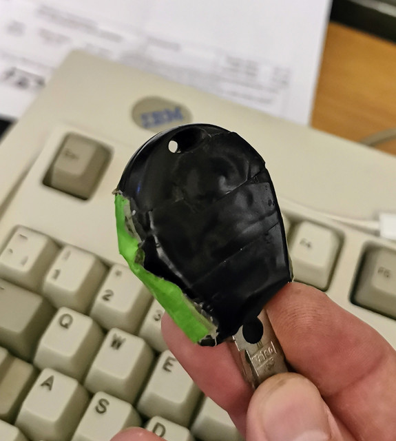

This afternoon I decided to have a look at the key to see if I could do anything to tidy it up. I also wanted to get into it to confirm if it had an immobiliser chip in or not so I knew which type of spare to order. Currently I only have the one key and that's always a recipe for stress in my mind.
The key looked like this...which is why I was determined to try to tidy it up a bit.
The fact that the tape was decomposing and sticking to every bit of pocket lint (or in this house, the omnipresent dog hair) was also rendering this high on my to do list.
Like a complete and utter idiot I didn't wear gloves while pulling this to bits...and of course the mixture of electrical tape and duct tape had both well and truly started to decompose into the stickiest goo known to human kind. Said goo is now all over my hands, desk, keyboard, mouse, phone, probably in my hair - and all over everything within about a 500 metre radius. Rookie mistake.
Oddly when I pulled it apart I couldn't see anything wrong...all three bits of the assembly click together firmly, and the flexible membrane on the side with the remote buttons on isn't split.
Testing the two CR2016 cells showed they were both fine, so I just reassembled everything after a good clean. Oh, and yes it appears the van does have an immobiliser as there's a chip in there.
Sure enough, the light on the key did flash when buttons were pressed...so I went out and walked through the key synchronisation routine, resulting in...
We appear to have fully functional remote central locking again.
I'll take that as a win!

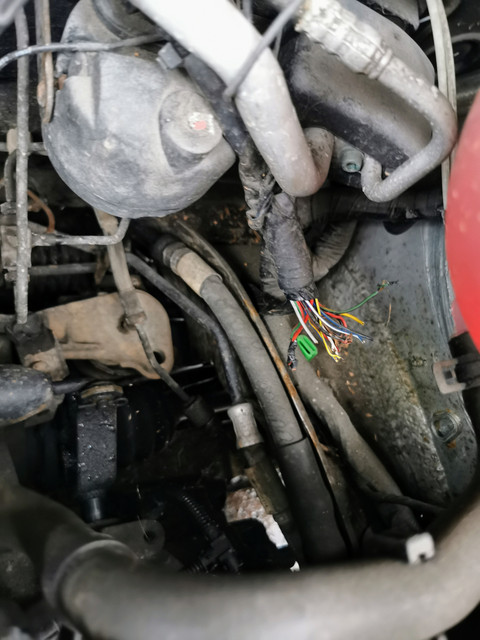

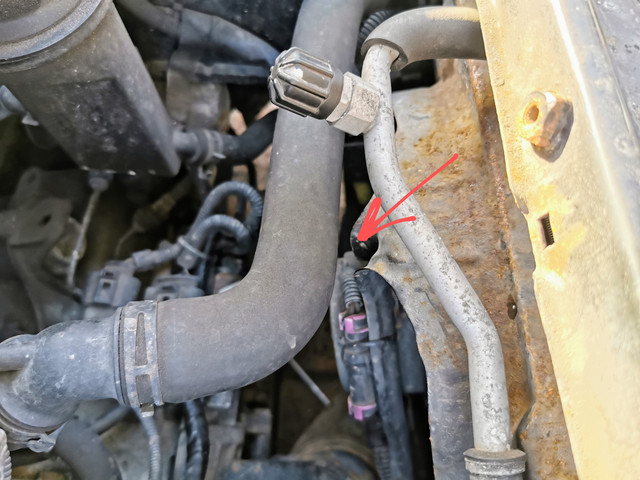

Though I did notice this mess in the engine bay when doing a check for oil leaks following the change yesterday...
Which is moderately concerning. I know this van did at one point have an aftermarket alarm (which doesn't appear to function), so I wonder if this was a result of a refusal to shut up one time to often - the loom tape does make it look different to the main vehicle loom, which is why my first thought was alarm. I will definitely be checking to ensure there's not power there shortly.
