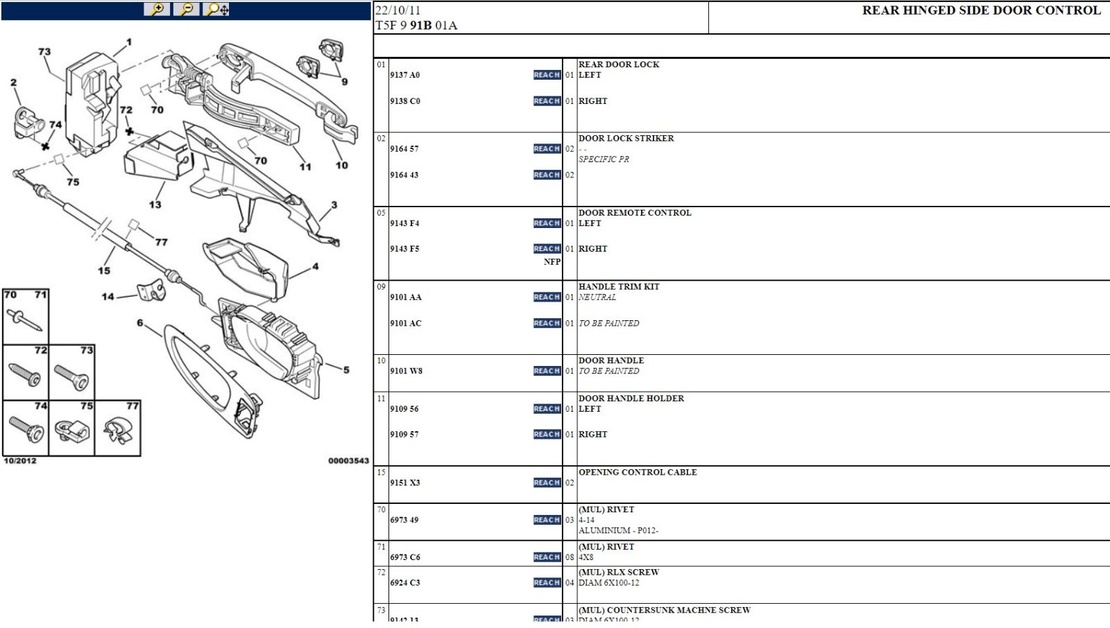

Looking for parts,numbers regarding rear off side door as its not working on the handle outside but works with the inside handle, it works on cental locking so im thinking the mechanism is all good ( but it is french )
Also some sort of a diagram of the whole door lock set up so i can locate any rods or bars that might be causing this.
Thank you.
Thank you.
Husky.

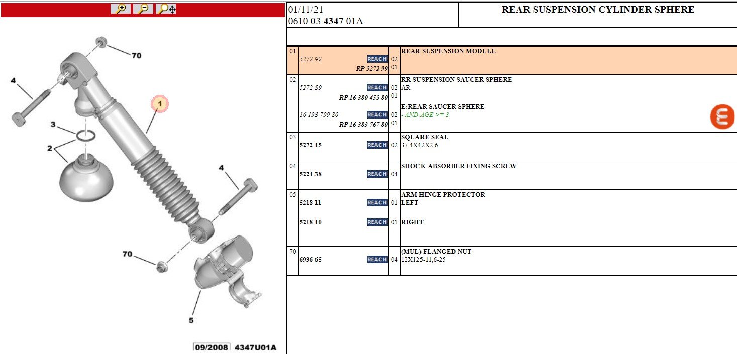

Could you provide a part number for a n/s rear shock absorber for my C5X7 Vin No: VF7**************[VIN obfuscated, can be read by forum staff].
Thanks
Hope I am requesting the following in the right place....
Thanks

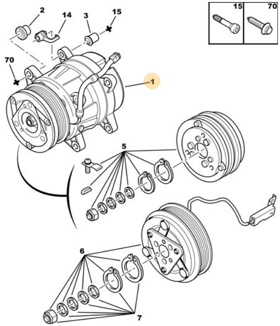

Please can you help me find part numbers that can match my Aircon compressor (mine has 6560502 stamped on it, but this is not bringing up matches.
Thank you so much, this has driven me nuts!
- x 6957
So your vehicle was fitted with a Delphi Compressor (1135463), which had the original Peugeot part number of: 6453JW that is no longer available. However the exchange Delphi unit has Peugeot part number of: 6453NC and that is available from Peugeot for: £751.98 inc. VAT. (Plus refundable deposit).

This any good? No rods, just cable.Huskyxantia wrote: 23 Jun 2022, 10:07 Looking for parts,numbers regarding rear off side door as its not working on the handle outside but works with the inside handle, it works on cental locking so im thinking the mechanism is all good ( but it is french )
Thank you.

The shockers are not sided. Original part no was 527292 but has now been superseded to 527299 which is £211.84 inc VATPeeBee wrote: 23 Jun 2022, 22:21 Hello Marc,
Thanks

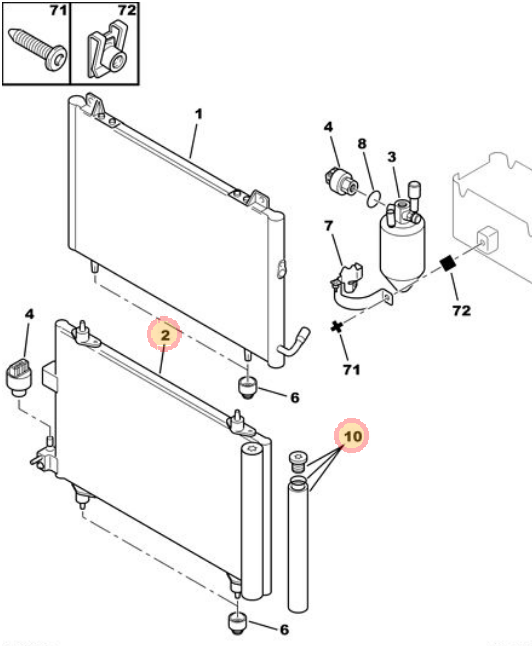

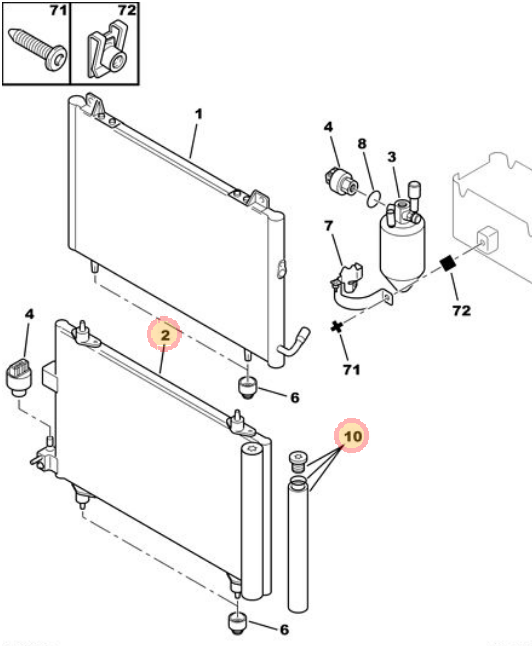

- x 6957
Here you go:
Item (2) Condenser
New OEM, part: 6455CQ, £514.28
New Cheaper PSA, Part: E163236, £101.72
Item (10) Drying Cartridge Kit, Part: 6455AH, £198.24
All VAT inclusive direct from Peugeot.
Item (2) Condenser

Brilliant , this will help. Ive found pushing the door inward then using the handle it will open, so there's an adjustment neededwheeler wrote: 24 Jun 2022, 13:16This any good? No rods, just cable.Huskyxantia wrote: 23 Jun 2022, 10:07 Looking for parts,numbers regarding rear off side door as its not working on the handle outside but works with the inside handle, it works on cental locking so im thinking the mechanism is all good ( but it is french )
Thank you.
Husky.

Thanks again Marc, brilliant!GiveMeABreak wrote: 24 Jun 2022, 21:05 Here you go:
Item (2) Condenser
