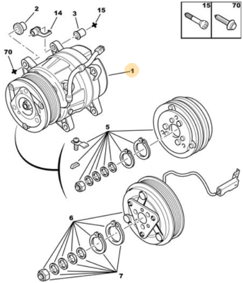

Please can you help me find part numbers that can match my Aircon compressor (mine has 6560502 stamped on it, but this is not bringing up matches.
Thank you so much, this has driven me nuts!
- x 6955
So your vehicle was fitted with a Delphi Compressor (1135463), which had the original Peugeot part number of: 6453JW that is no longer available. However the exchange Delphi unit has Peugeot part number of: 6453NC and that is available from Peugeot for: £751.98 inc. VAT. (Plus refundable deposit).
