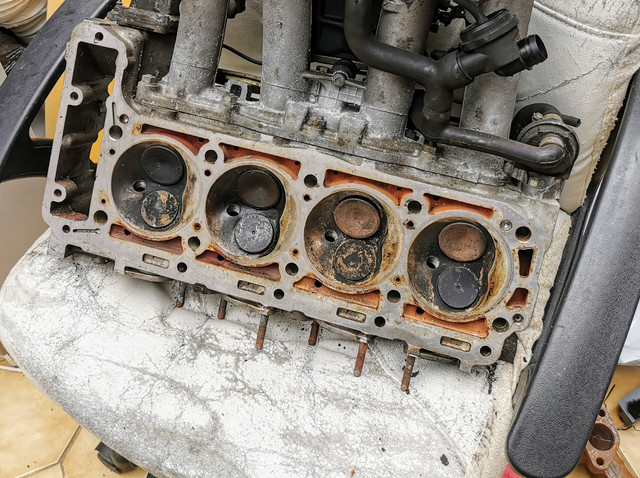

Today has been at times frustrating but overall was productive.
I didn't actually have much work to do in terms of cleaning up the mating surface of the new head. This is what it looked like when I first looked at it. Reckon someone had already made a first pass over this before I got it.
Likewise the block actually wasn't bad at all. Didn't take long at all to get it all cleaned up - though I failed to take a photograph of that stage for either head or block at this stage.

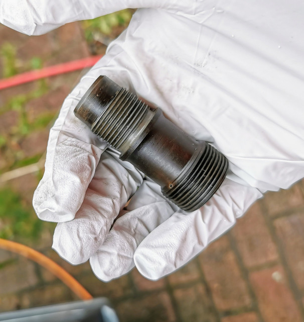

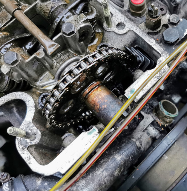

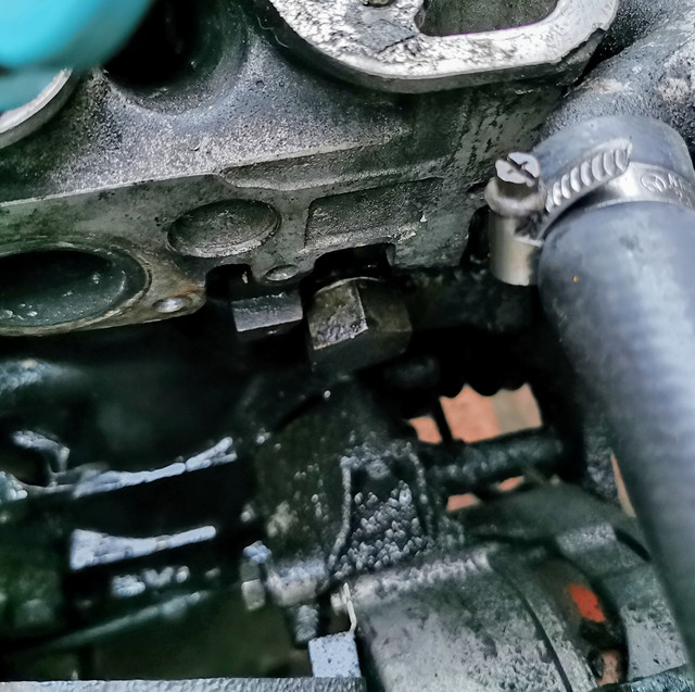

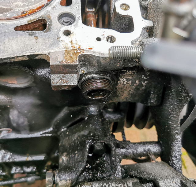

Before I could start building things back up I needed to reset that blasted ratcheting timing chain tensioner.
First step of that is to remove this huge great bolt-like thing, which requires you to remove all but one of the alternator bolts so it can be swung out of the way.
This required the biggest socket in any set I own, but thankfully I did have one big enough.
I had assumed this would bring the whole tensioner out...no, it retains the spring and forms the outer oil seal...but the core of the tensioner (and the bit I needed to remove) was completely separate.
...Which required a 17mm hex bit to remove. Which I didn't have. Biggest I could find in the garage was 12mm. Biggest I could find separately anywhere locally in stock was 12mm...so ended up having to spend £20 on a whole set of 10 sizes just for the 17mm one which was annoying.
It was also biblically tight. Though after hanging off the end of a breaker bar - which was bending worryingly itself - it eventually gave in and came free and could be unscrewed from the block.
One timing chain tensioner assembly.
All this faff so I could do this.
The way it works is that the plunger can move freely from frame right to left, but cannot move the other way. So the only way to back it off is to pull the plunger all the way out and insert it back into the other end of the body. When you screw the outer cap back on with the spring under it, that then applies the correct amount of tension to the chain. In addition to the spring tensioner, there's also a hydraulic circuit built in to push the plunger out...so basically there's a layer of redundancy there in case either the spring or hydraulic system were to fail.
If it didn't involve having to remove the alternator to get at it and require tools beyond what the average DIY mechanic are likely to have to hand I'd call it clever.

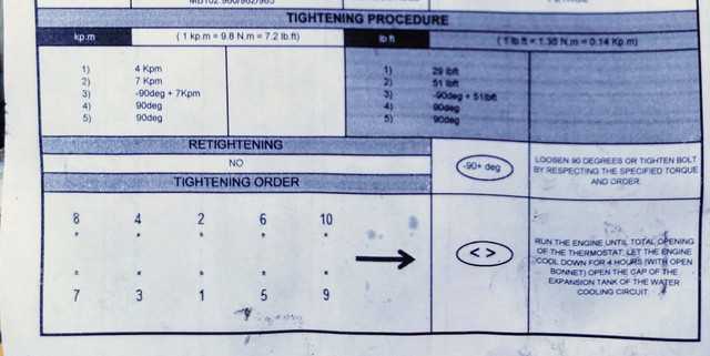

The head bolt torque specs and the bolt tightening sequence were helpfully included with the gasket. Nice touch - I did check online too and they matched up.

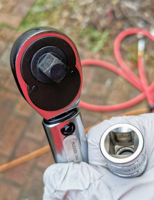

However as soon as I dug out the torque wrench I realised I had an additional problem.
Yep...Torque wrench is 3/8" and the Torx bit I had for the head bolts is 1/4". Back out to Halfords *again* to get an adaptor. I knew from prior experience that I didn't have one in the garage...so bought all of the usual suspects suspects so shouldn't run into this problem again.
After what felt like an eternity...
I tell you now though, that last 90 degrees nearly killed me. I was near enough *hanging* off the end of the thing to get there. I will definitely be feeling that from my back in the morning.
Head is torqued up, timing chain sprocket, guides are fitted and the tensioner has been refitted.
I was pretty beat at this point from torquing up the head bolts but wanted to get one last thing done, even though I knew there was no way I'd be getting to a test firing today. I wanted to verify the engine would actually turn over through a full revolution without valves hitting pistons. I had followed the instructions (crank pulley to the O/T mark and the notch on the camshaft level with the head), so it *should* have been fine...but this is the sort of job where I really do feel out of my depth so am questioning everything.
I dumped a pint or so of oil over the camshaft so everything was lubed up (in addition to the smear of grease I put there when I put it together), then got a socket on the crank pulley...and it turned over absolutely fine. No unpleasant noises, binding or anything...so there's hope for me having got that bit right.

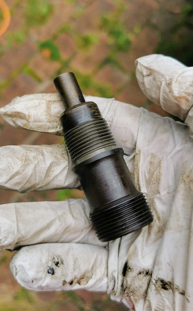

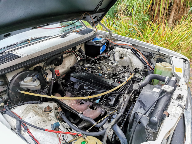

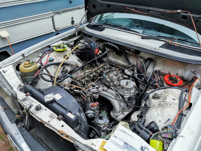

Today I spent a good solid six hour stint working on this. The result?
It almost looks like an engine bay again.
Apparently I'm not a *completely* cack handed idiot either and must have done a reasonable job of getting the timing right. Given this was the first time I'd ever had the head off an OHC engine unsupervised that felt like quite an achievement. Initially getting it started took a little coaxing but I think it may just have been flooded/the plugs oil fouled. Took me about half an hour of fiddling before I realised that the throttle cable wasn't hooked up yet so my holding the pedal down while cranking wasn't going to help. Idiot.
Sadly as you can probably hear on the video she still sounds pretty rattly at higher revs. This was pretty much impossible to hear before because there was so much of a racket from the top end. Hard to tell too much from blipping the throttle when stationary, should be more obvious if there are any untoward noises when we take an actual test run.

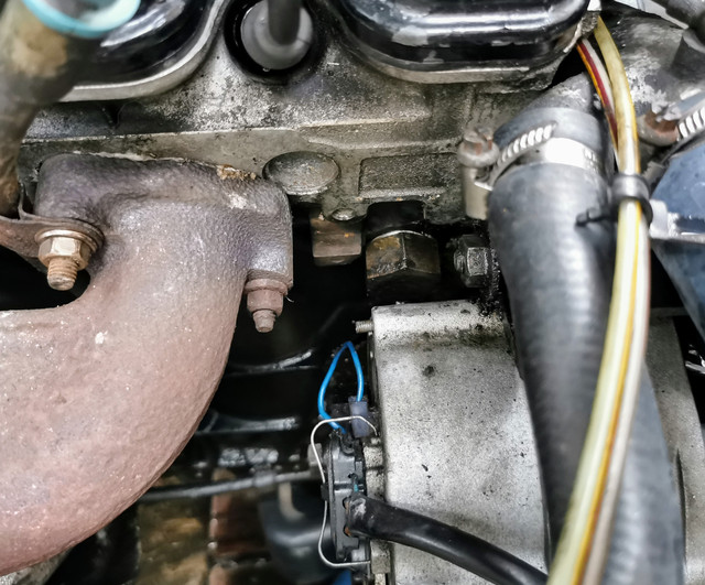

However I need to sort a pretty major oil leak from the timing chain tensioner...

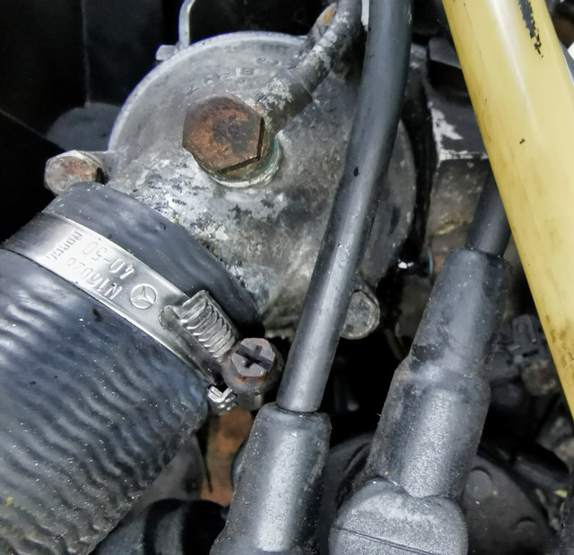

And a water leak from the thermostat housing...
Before we can do that. The tensioner is leaking I'm guessing because the metal O-ring it seats against is intended to be a single use item, and the thermostat housing just needs a gasket. I did order one but what turned up was totally wrong for this engine...tried to get away with instant gasket and it didn't work. I don't actually have any gasket paper in stock at the moment...might try making one from card just as an experiment while I wait for the proper one to turn up.
The only real own goal I had to sort was initially bolting the brake servo vacuum hose bracket on backwards...which by my standards is pretty good going!
Even if we do find ourselves back where we started after this, I still feel it was a worthwhile exercise. The alternative would have been to pull the engine out of the car for inspection...which I really don't have the space to do and would have needed to buy quite a few new tools to undertake. This has taken a couple of afternoons and probably £50 of parts/sundries. A T12 Torx bit and 17mm hex key were the only tools I needed to pick up for the job.
If we'd gone down that road and found the bottom end to be stuffed I'd have a dead engine sitting in the middle of the front lawn to annoy the neighbors (even more) and a now engine-less car sitting there being a large white paperweight unless I spend a small fortune on a replacement power unit. This way we will have discounted the top end as a possible issue, but have at least ended up with a car that runs and drives until we decide exactly what to do.
That path may well be looking to sell it on as a project as I'm just not sure I can summon the enthusiasm to justify spending the sort of time, effort and expense of replacing the engine. If one turned up cheap and local, maybe. However the only ones I've found so far have been anything but cheap and would require shipping...if she was a tidy example maybe, but without spending thousands on bodywork this is always going to be a bit of a rough car cosmetically.
Probably absolutely a worthwhile project for someone so inclined to drop a new engine into, or strip this one down for a proper rebuild, just don't think that person is me. Especially as this whole experience has been a bit of a sledgehammer to the enthusiasm for the car. I'd been planning to pick away at improving it overall, but really hadn't planned on much mechanical work beyond routine servicing and the usual maintenance projects which older cars bring with them - a major mechanical issue like this wasn't really in the plan, and is an area where I just feel a bit out of my depth. Especially when it's a car we're talking about that I'm really not all that familiar with. Doesn't help that whenever you search for "how do I <insert task here> on a Mercedes M102 engine?" The first page of results is entirely comprised of answers for the six cylinder or diesel engined cars. That gets annoying quickly.
Guess we will see what happens once we've done a proper test run. Had to abort things today due to the amount of oil and water that was pouring out of it (very glad I just put water in for testing).

Hard to say without a *fully* up to temp run. I called time on the testing yesterday as I was running out of things to catch oil and water in. It definitely builds pressure faster now so we have improved something. It looks like we might have gained a bit, but it's definitely not a night and day difference.
Natural idle:
In gear idle:
I need to double check the specs, I may need to bump the idle speed up a touch anyway.
Real question will be seeing if this gets rid of the metallic debris in the oil. It's quite possible that yes the bottom end does rattle a bit...but it quite possibly has done that for years and will continue to for many more. Recently though something has obviously been breaking down - and some of that was definitely the camshaft (there was a lot of glittery residue present around the most badly worn lobes - and on top of the grime in there so obviously recent), though the question is if it's *only* been the camshaft...
