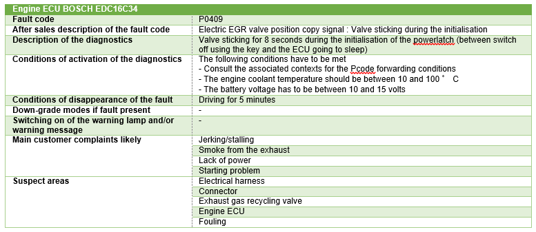

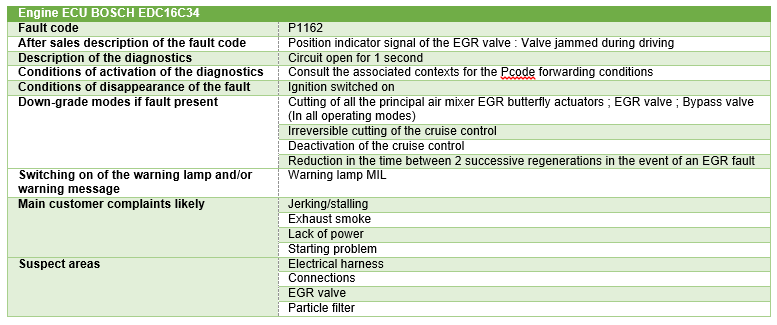

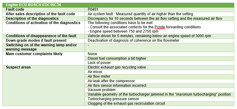

Having donated my known-good Air Doser and MAF to the X7, I bought a used doser off ebay and on fitting it (and the X7's removed MAF) got rewarded with a handful of related fault codes including shut down of ABS and ESP functions on starting the engine.
Those codes cleared themselves once auto-adapatives was invoked but that then triggered four new fault codes, indicating the EGR is stuck in the closed position. If it weren't for the slight loss of performance, I'd be tempted to leave it that way.
Electric EGR valve position copy signal Valve opening too small
Temporary
QWP- P0490
Electric EGR valve position copy signal Valve stuck when driving
Temporary
QWR- P1162
Fault: air circuit amount of air measured higher than the setting
DAI- P0401
Electric EGR valve position copy signal Valve stuck during programming
8WK- P0409
MikeT's C5r 1.6 hdi Estate
- x 6945
Re: MikeT's C5r 1.6 hdi Estate

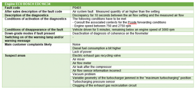

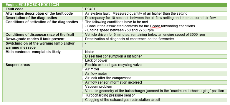

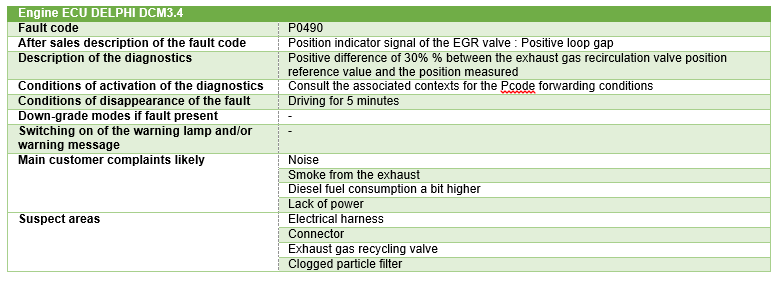

Mike Here are the faults descriptors as they apply to your engine ECU. Most of these should disappear after 5 minutes or so of driving - so as you say may take a little while for the ECU to settle down with the new data it is receiving...
These should clarify in quality when clicked on:

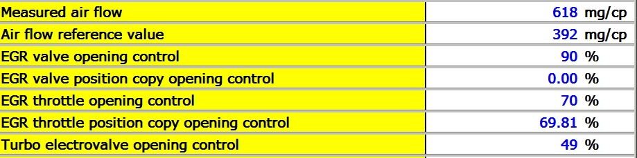

I don't think this is one of those magically-fix-itself scenarios, Marc
The codes show it can't program endpoints at engine off, can't see the valve moving when driving and the copy signal always reading "too small".
Live parameters shows the EGR to be permanently stuck in the closed position. The AirFlow discrepancy shows fresh air supplementing the missing exhaust mass, despite the EGR being commanded 90% open and the EGR throttle at 70%.

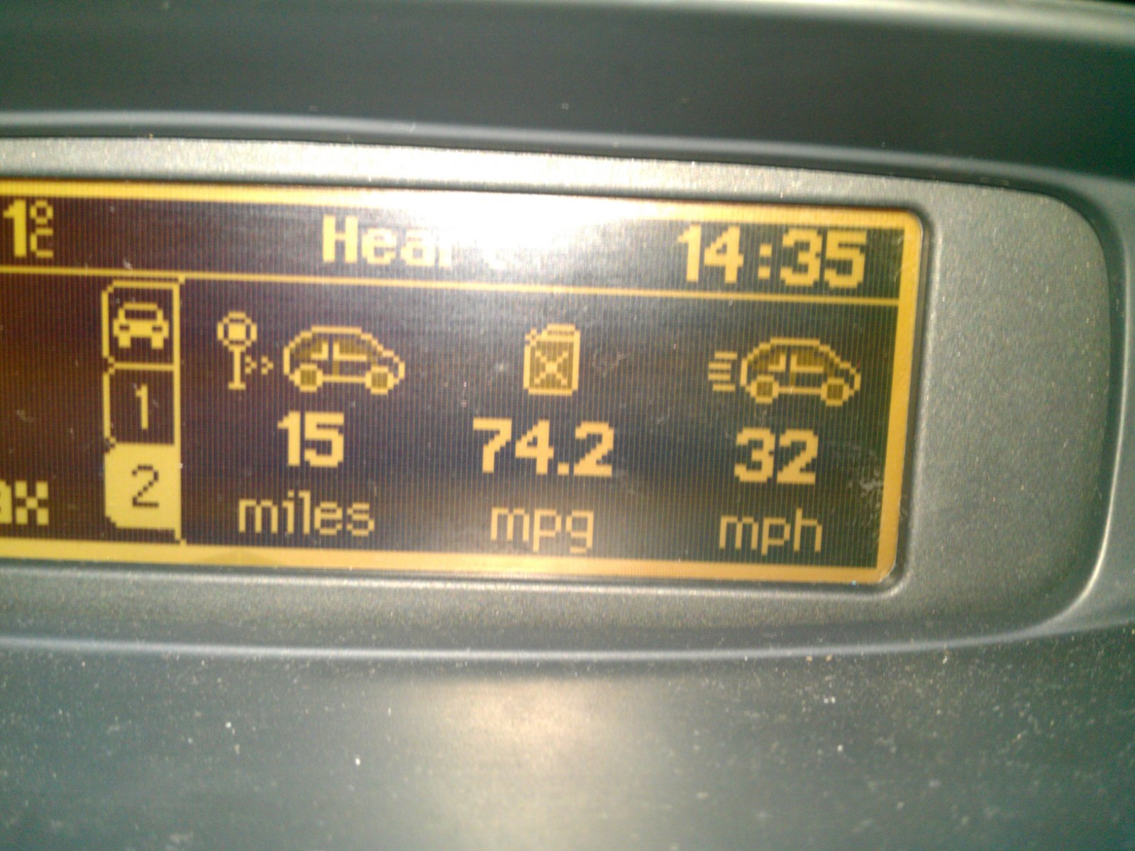

First splash n dash since the EGR's been stuck closed and I find it even more tempting to leave it be.
- x 6945
That's only 15 miles though - bound to drop as it averages out. Not that I'm in the slightest bit jealous of course, you understand.
Yes, it will drop for sure Marc, but just illustrates how detrimental the EGR is to fuel economy as this is the first time I've seen it above 68.4mpg, and by quite a margin.
