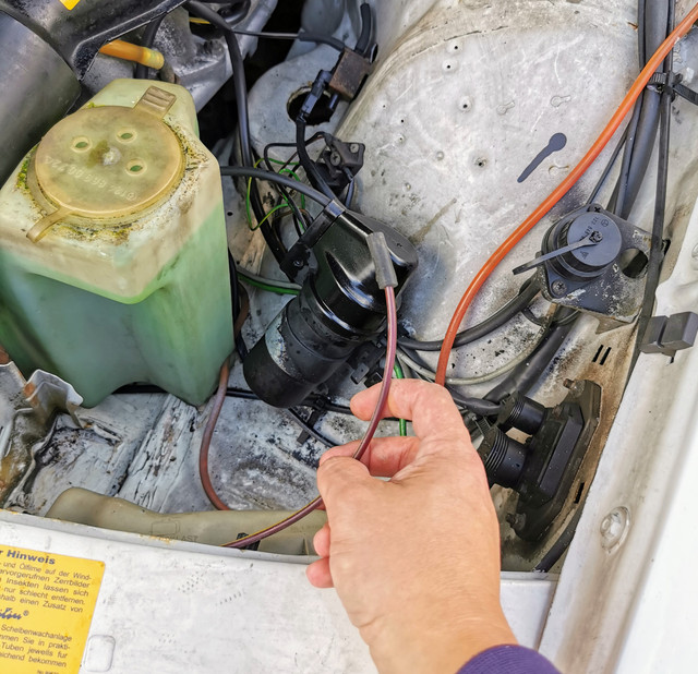

As with many things on the Mercedes W123/S123 the headlamp beam height adjustment control is operated by vacuum...and that hose you see there should be attached to the nearside headlight height adjuster. I'm guessing I knocked it off when I pulled the cover off a couple of weeks ago. With it reattached the beam adjusters did their thing and the beam height looks more or less right now.

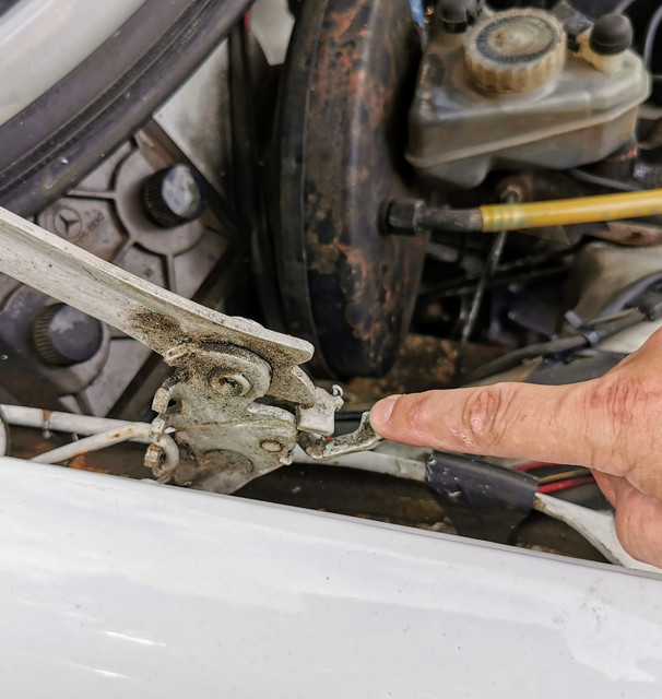

Normally the bonnet opens this far. Which is better than on a lot of cars. Plus sprung hinges mean there's no faffing about with bonnet props.
I also appreciate that the latch is buried up behind the grill as well so it's near impossible to catch your head on it. The bonnet sits high enough that even the grill hanging down doesn't get in the way.
However if you press this one little catch down on the offside hinge...
The bonnet then swings all the way back to vertical (and equally importantly, latches there).
This takes it completely out of the way and I'm pretty sure would even give you ample room to get in with an engine hoist if you needed to.
It's a feature that on 98% of the cars probably never got used even once after they left the showroom, yet the design and engineering team saw it as helpful enough for maintenance that they included it. On behalf of mechanics and hobbiests the world over, if you were one of the folks on that team, we thank you.

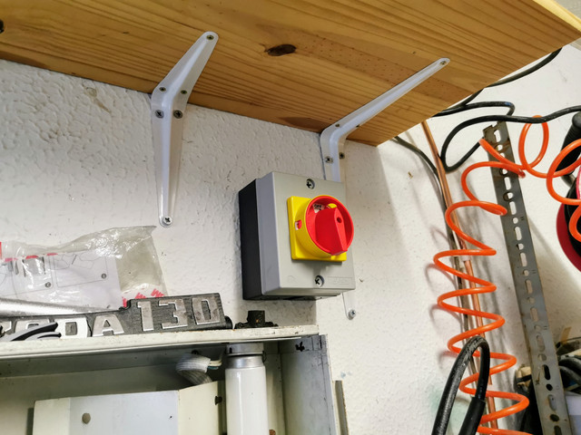

Only task left on the air system until I call it good will be wiring in the power switch.
The socket this is connected to is basically inaccessible (it's behind the tank) so is a pain to get to, but I obviously wanted a way to shut it off. I went for an industrial style switch as it was cheaper than an equivalent IP rated double pole rocker switch, which I wanted because I've had issues with dust and grime getting into none IP rated switches before. Plus I can just wipe this down if I get it covered in oily gunk, which will no doubt happen at some point.
Once that's wired up I'm calling it done for now. Few little bits and pieces to do to optimise things (like replacing that flexible line from the receiver to the regulator with rigid line) but it will be absolutely usable then.

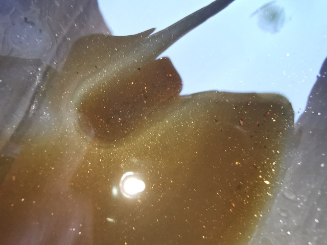

When checking it today I noted that the oil on the dipstick was looking distinctly dark again so it was time for it to be dropped and changed again.
Not black, but definitely dirty. This has been in the engine for about 700 miles.
You can see how much grime the filter has been collecting between the pleats in the element. So this would have lost quite a chunk of flow capacity already.
Somewhat worryingly there are a few ~1mm sized bits of metal flake in there. Optimistically they're from the camshaft as we know that's been subjected to abnormal wear due to oil starvation. It's entirely likely though they're from bearing surfaces deeper in the engine. Short of dropping the sump and pulling a couple of the bearing caps off the crankshaft for examination it's impossible to say. It's worth keeping in mind that the previous oil filter that I removed the first time I changed the oil on getting the car had failed so most of the oil was probably bypassing it.
I am going to have a look at how hard it is to drop the sump anyway as given the state of the top end I'm expecting the sump to be just as bad - and I'd really rather not have all that slime ending up blocking the oil pickup screen (as has killed innumerable 90s and early 00s Saab engines).
We've got acceptable oil pressure at idle, not great but acceptable, so I'm not immediately worried it's about to explode, but definitely something I need to keep an eye on. I'll be keeping on the "change the oil once it starts to get dark" routine for the foreseeable future. A bit of a case of closing the stable door after the horse has bolted, but there's only so much I can really do at this stage - if damage has happened it's already happened.

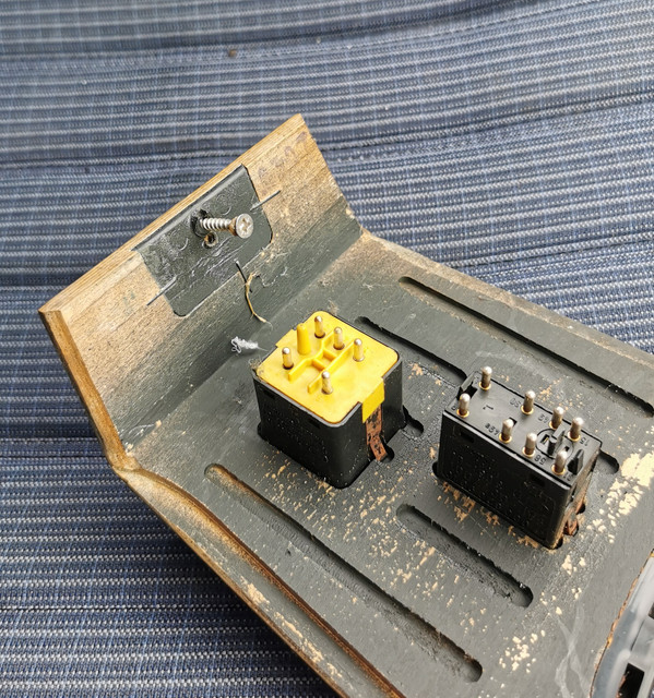

Also on investigation of the jammed passenger side heater temperature control found I need to order up a new bracket for the heater controls.
Which I think is why this whole console is wobbly. That plastic frame is meant to be riveted to the front of the heater box, and the temperature controls are then bolted it it, and that locks everything together. With that broken (it's worse than it looks, I counted eight pieces) nothing is really secured properly. I'll aim to replace the cable for the passenger side temperature control while I'm at it...the valve moves freely but the cable is completely seized up.
Given the number of posts on various forums I found when searching for the part I'm guessing that bracket failing is a common issue. Get a horrible feeling that replacing it is going to be a pig of a job though as I reckon the whole console will need to come out to gain access.

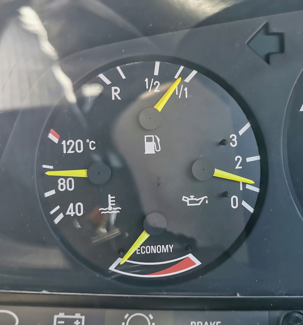

Having a little bit of a moment of concern over the long term prospects for the engine in the S123. I'm pretty certain that the hot oil pressure at idle has dropped somewhat since it was changed a week or so back. I'm sure we were seeing just under 1.5 bar at the point the cooling fan was cycling. Now looking at this.
It was hotter than Hell out there today and I think the idle may be fractionally lower than when I last checked (I think the IAC valve would probably benefit from a clean), but it definitely seems to be lower.
This isn't entirely unexpected to be honest... let's not forget that this is what several lobes of the camshaft look like.
I was pretty much braced for there most likely to be deeper issues... especially as the oil filter element was so clogged when I went to change it the first time that it had collapsed.
The most likely candidates I can think of off the top.of my head are:
[] Clogged oil pickup strainer.
[] Gunk in the oil pump pressure relief valve so it doesn't seat properly.
[] Big end bearings and/or journals in the same state as the camshaft.
[] Oil pump rotors or casing ground away to nothing...like the camshaft.
[] Or it's just a bit of a worn out old engine and wants some thicker oil thrown in.
Which is definitely the first thing we'll be doing after I've had a peek at the oil filter element to make sure it hasn't been clogged up by some gunk having come loose from somewhere.
If it turns out we do have decaying oil pressure which isn't just needing a new filter and a grade change we obviously need to do something about it. The big question is rebuild or replace?
I would definitely be leaning towards wholesale replacement with another engine. I'd be expecting the crankshaft to be scrap based on what I've seen so far...and I'd probably basically end up replacing everything aside from the block itself...even then I'd never be completely sure that I'd got all the gunk out!
If I could find a complete unit with a gearbox that would be even better as I know this one isn't 100% healthy - third gear is engaged with a sledgehammer when cold and first gear only appears for about half a second when pulling away with your foot on the floor...oh, and the fluid smells like burnt toast which is never a good sign.
Given that it's usually rust which kills these cars I'm hoping that tracking down a good power unit wouldn't be too massive a headache. On that note, if you know anyone with an M102.980 engine sitting under a tarp in the corner of a garage, let me know.
At least it looks like doing an engine swap on this car doesn't look like it should be too difficult. Definitely worth doing if it comes to it though I think.
Hopefully we won't need it...but I'd rather be prepared for it if we do. This is why I keep an eye on my instruments, so things like this don't sneak up on you. The actual numbers on the gauges aren't so important... it's keeping an eye out for them doing something different to what they normally do that's important and is a pointer towards something needing attention.
Sorry, that turned into a bit of a ramble.

If we were just down on pressure a bit that might be the case...sadly I don't think that's going to be the case...
Well I've got news and it ain't good.
Figured dropping the oil and putting some heavier weight in there wasn't the worst idea.
The drain pan tells us what we need to know I think. It was cleaned before use. The oil has been in there for about a week and a hundred or so miles.
All those specs in there? They're all shiny. Which means they're all bits of metal which *should* be attached to the innards of my engine...most likely either the cam or crankshaft.
With 20W50 in there rather than 10W30, we've gained maybe 5-7psi of oil pressure when hot. A bit but nothing dramatic.
She's obviously hurting pretty bad.
The biggest question at this point really is where has that metal come from?
We know the camshaft is knackered...well the lobes are, no way to see what state the bearings are in without pulling things to bits. Need to have a closer look at my spare head to see how much work it might be to pop the caps off to take a look.
Does anyone know off the top of their head if you can drop the sump off this engine in situ easily enough, or is it a pain of a process because something is in the way? Because if we could pull a bearing cap or two off the bottom end that could tell us a lot.
Obviously the engine has issues, but if it's "just" the camshaft that's chewing itself up, changing the whole thing might be slight overkill. Hmm...further investigation needed.
I have started asking around to see if anyone knows of a spare engine about anywhere though.
