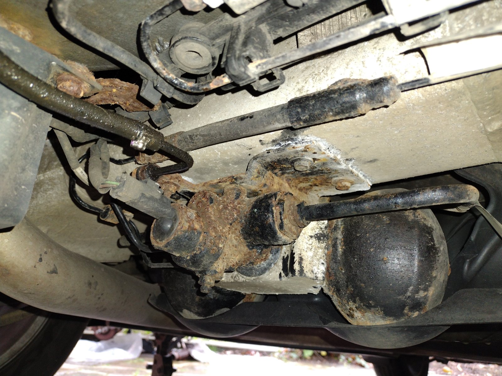

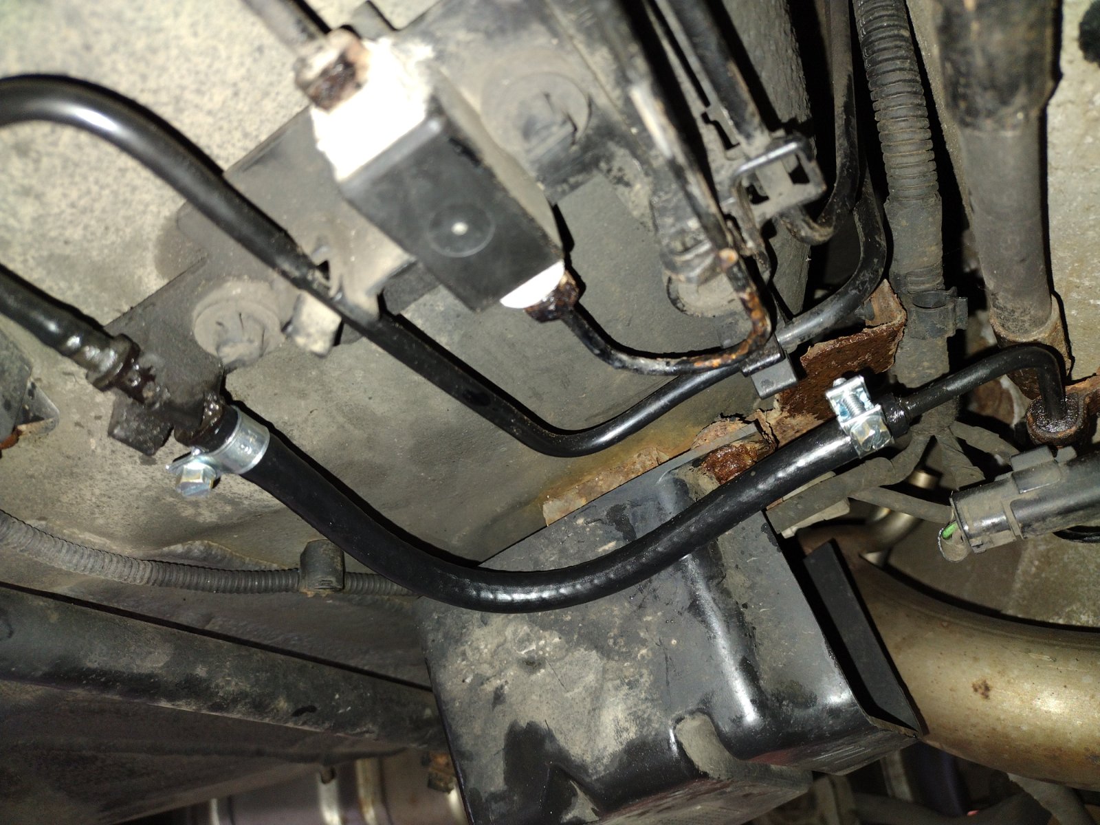

Rubber hose end number 1
Rubber hose other end

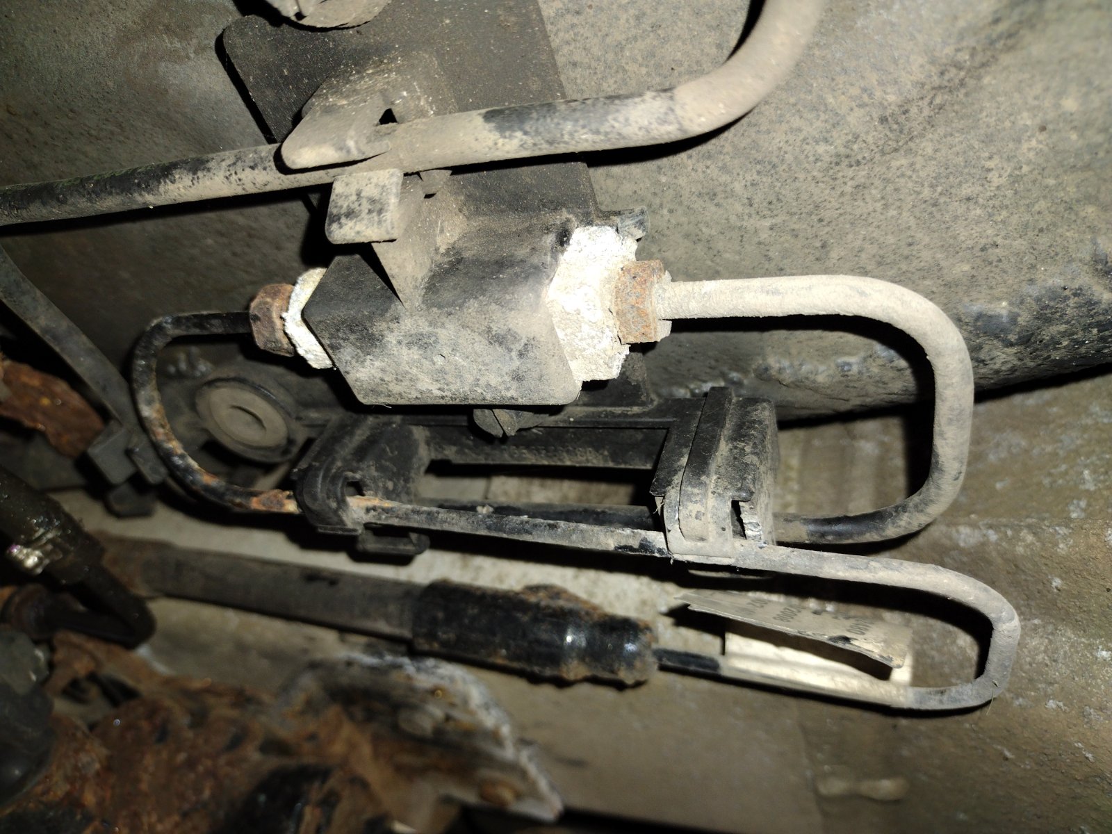

Other pipework (mostly steel)
Other pipework
Other pipework
Galvanic corrosion initiator / pipe connector alloy block

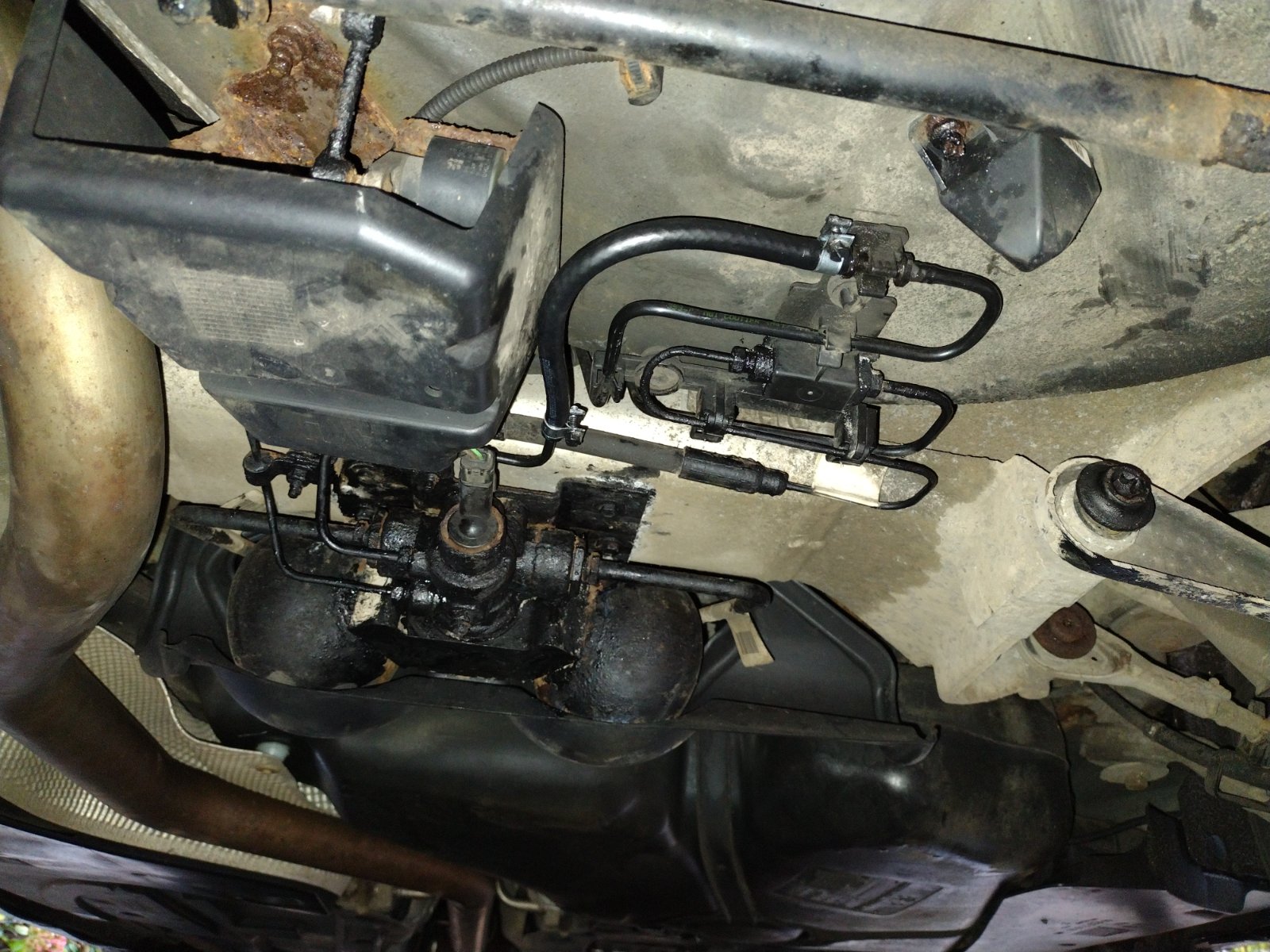

Pipework ahead of rear spheres

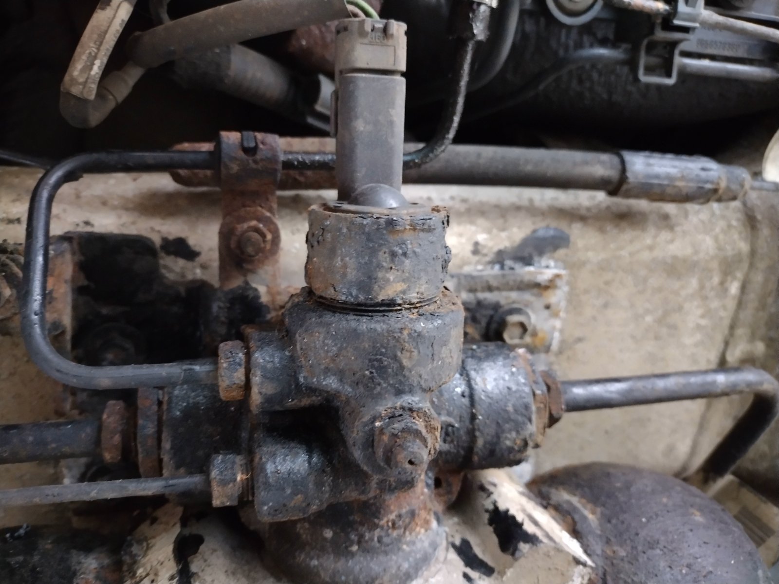

The infamous epb!
The infamous epb!
Attempt at a close up at the end I think most definitely is leaking

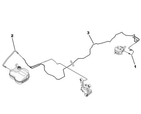

If it's the return harness pipes shown below, all those shown are available Paul:
(1) Hydraulic Fluid Return Harness, part: 5270SE, £46.60
(3) Hydraulic Fluid Return Harness, part: 5270WR, £169.30
Unfortunately the rubber hose is part of 5270SE.

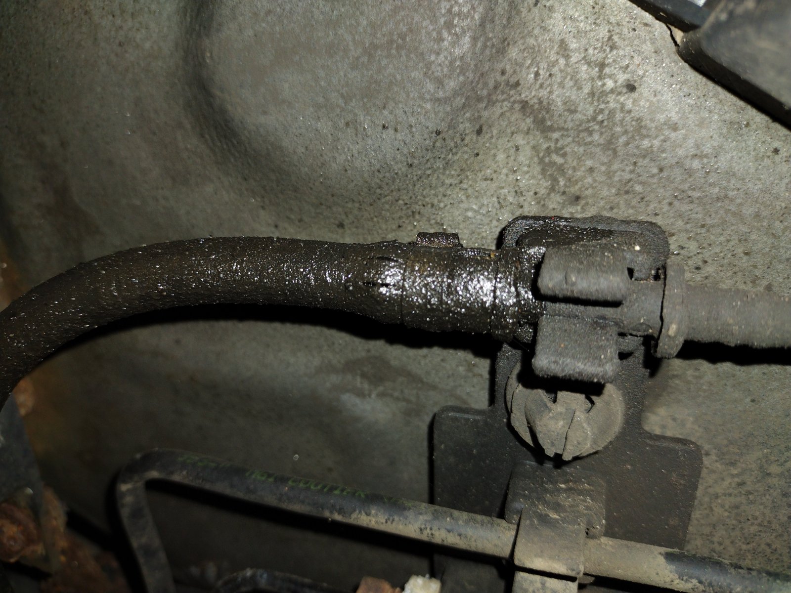

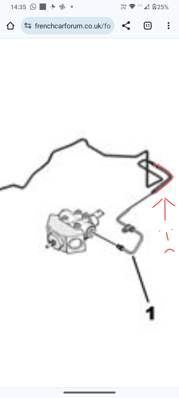

This bit 'ere!
This bit 'ere!
Need to identify it's key dimensions and get a replacement length of something similar.
Both ends of it look pretty tired on mine, don't think I could shorten it twice and get away with it (risk of things getting kinky!)

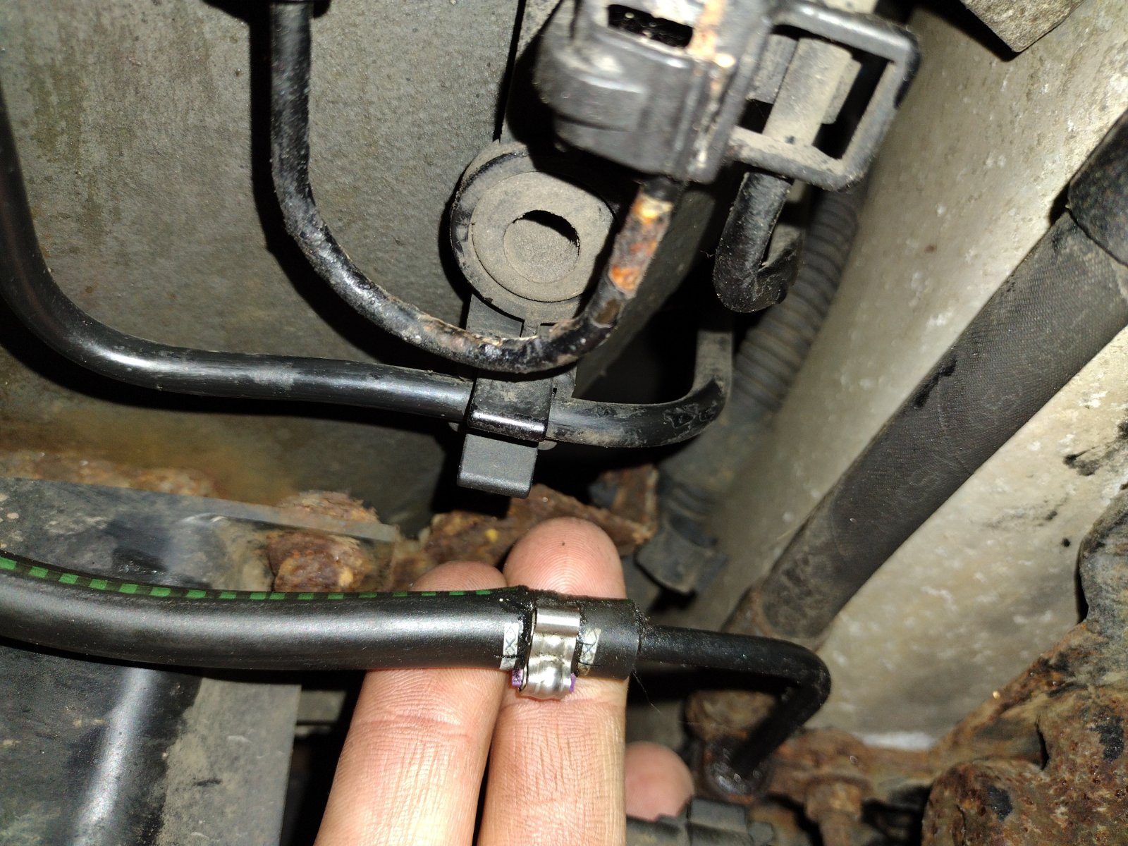

Feedback on the job:
4.8 mm rubber tube completely fine size wise.
Rigid plastic hose tail seems to be a slightly larger size. Tube pushed on fine but needed the 9-11 millimetre fuel pipe clip whereas other end comfortably used 8-10mm
Only a small drip apparent when either end disconnected thankfully. Though I did have five millimeter timing belt pins to hand as stoppers. I made the new tube 20 mm longer than the old which means it rubs on the height sensor half arsed weather protection plastic box.
Weather is absolutely abysmal and hence really sucked any enjoyment out of otherwise pretty straightforward fix. Yuk :cry:
Steel pipes have had quick sandpaper and phosphoric acid next will slap on little bit of black paint hopefully to preserve them

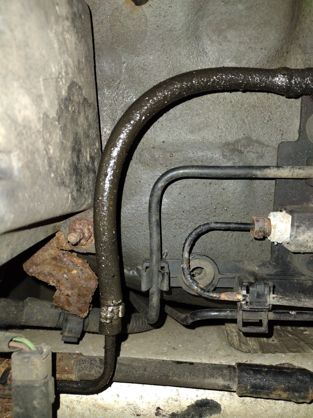

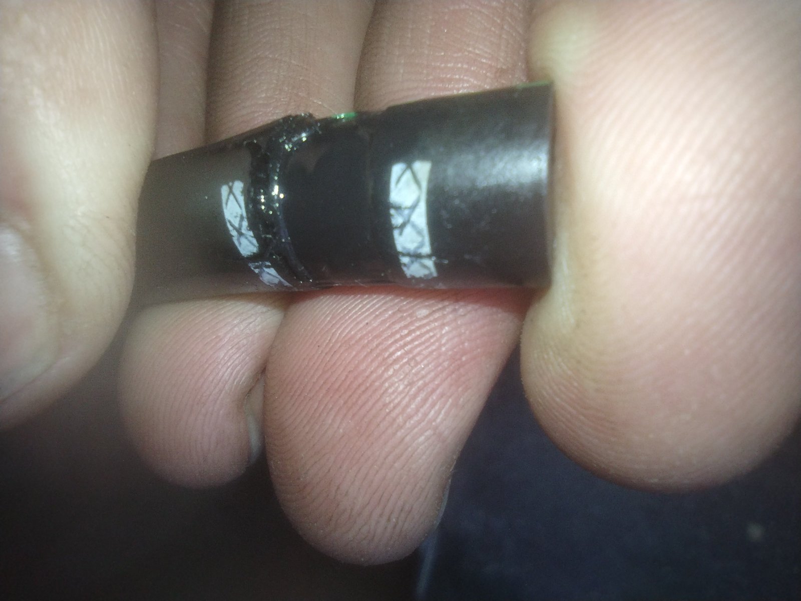

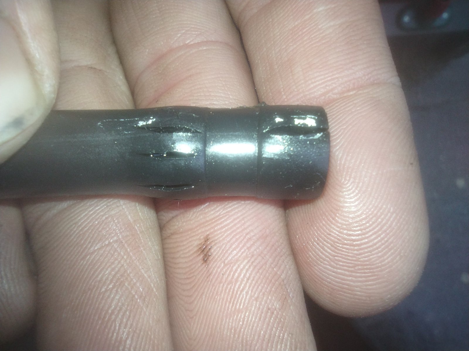

Close up of the old hose ends for interest. Rest of it seems pliable and good condition.
Posts: 9339
Joined: 07 May 2009, 16:24
x 1942
Unread post by Paul-R »
That's exactly how the hose on my car perished.
Posts: 5308
Joined: 25 Apr 2022, 09:03
x 2341
Unread post by MattBLancs »
Paul-R wrote: 19 Nov 2023, 12:12 That's exactly how the hose on my car perished.
Interesting isn't it, it almost seems the stress of sitting on the larger barbed lump on the end assists the failure.
It's why I made it long (then if goes it again can shorten one or other end) am hopeful it rubbing on the plastic box unlikely to cause any meaningful damage (but will try to keep an eye on it whenever under that end)
Posts: 55063
x 8386
And that's exactly how I've seen pipes perish on many Xantias and XMs... Always where they expand to fit over flares...
