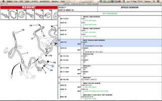

Elma...have you had any time to look at those abs fitting posts at all? I'm assuming, being a vsx that the car has aircon but has it also got a sunroof fitted?

It has a sunroof and no aircon. I had a look but wasn't sure, mine are like the diagram below.
Do I need to remove the sensors to see these posts? I'm going there today so will have a go at getting one out.
