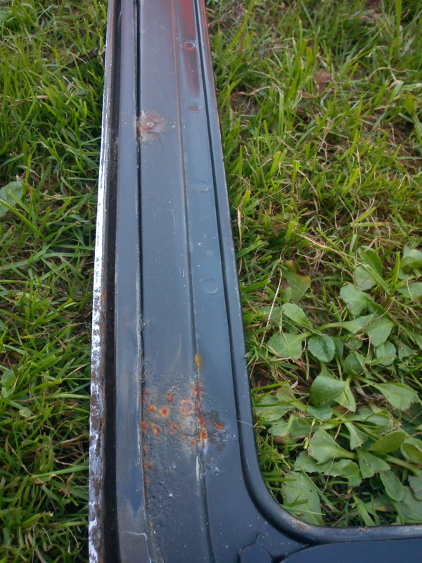

I will do a proper update next week. If I copied and pasted my posts from Club XM it wouldn't really make too much sense. In the meantime, these photos show why my sunroof was leaking. To be fair, this is from my spare sunroof which was in slightly better condition (as in it hadn't rotted through in some places
Rust beneath the seal.
Water had been getting through the sealant that bonded the glass to the carriage.

the usall cause of the tilt??/slide sun roof leaking is the drain tubes become blocked so dont allow the water to escape,red_dwarfers wrote: I will do a proper update next week. If I copied and pasted my posts from Club XM it wouldn't really make too much sense. In the meantime, these photos show why my sunroof was leaking. To be fair, this is from my spare sunroof which was in slightly better condition (as in it hadn't rotted through in some places)
the seal aint a seal against water but just a draft felt

This is what I was referring to!
I went through and tested the drain tubes, they were all clear, did blow them out anyway just in case. In my case, you could actually see the water coming through between the glass and glass carriage.
