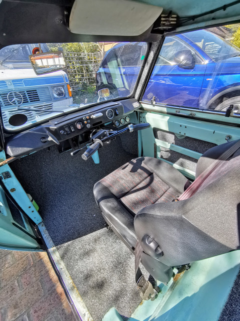

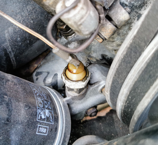

Well I don't know if it is the *only* oil leak on TPA, but the oil pressure switch is definitely a source of *an* oil leak. This was cleaned up and completely dry before I set off today.
Will get a new one ordered from Prokschi later on.

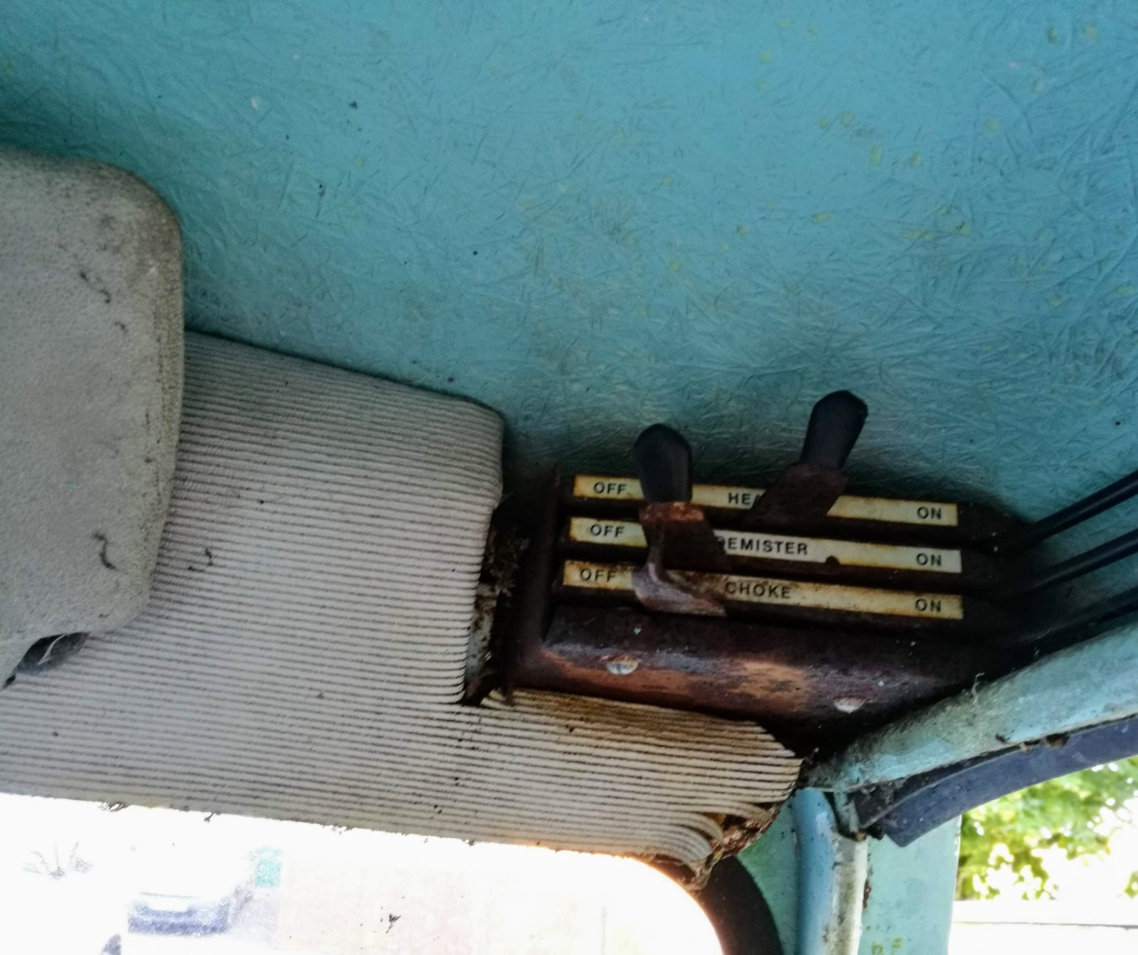

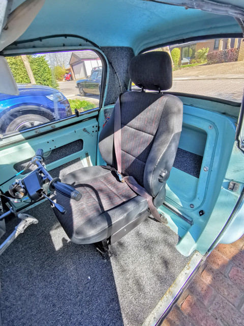

Have to admit that I'm staggered at the difference changing the Dynastart belts has made. Not so much in noise, but I'd say it's reduced mechanical vibration by about 80%, the engine just feels so much smoother now. Wouldn't have expected such a small mass wobbling around a bit to make such a huge difference, but I know vibration can be strange like that once you take into account resonance effects and such.
It's definitely improved performance of the charging system too, it starts charging a good bit earlier than it used to.

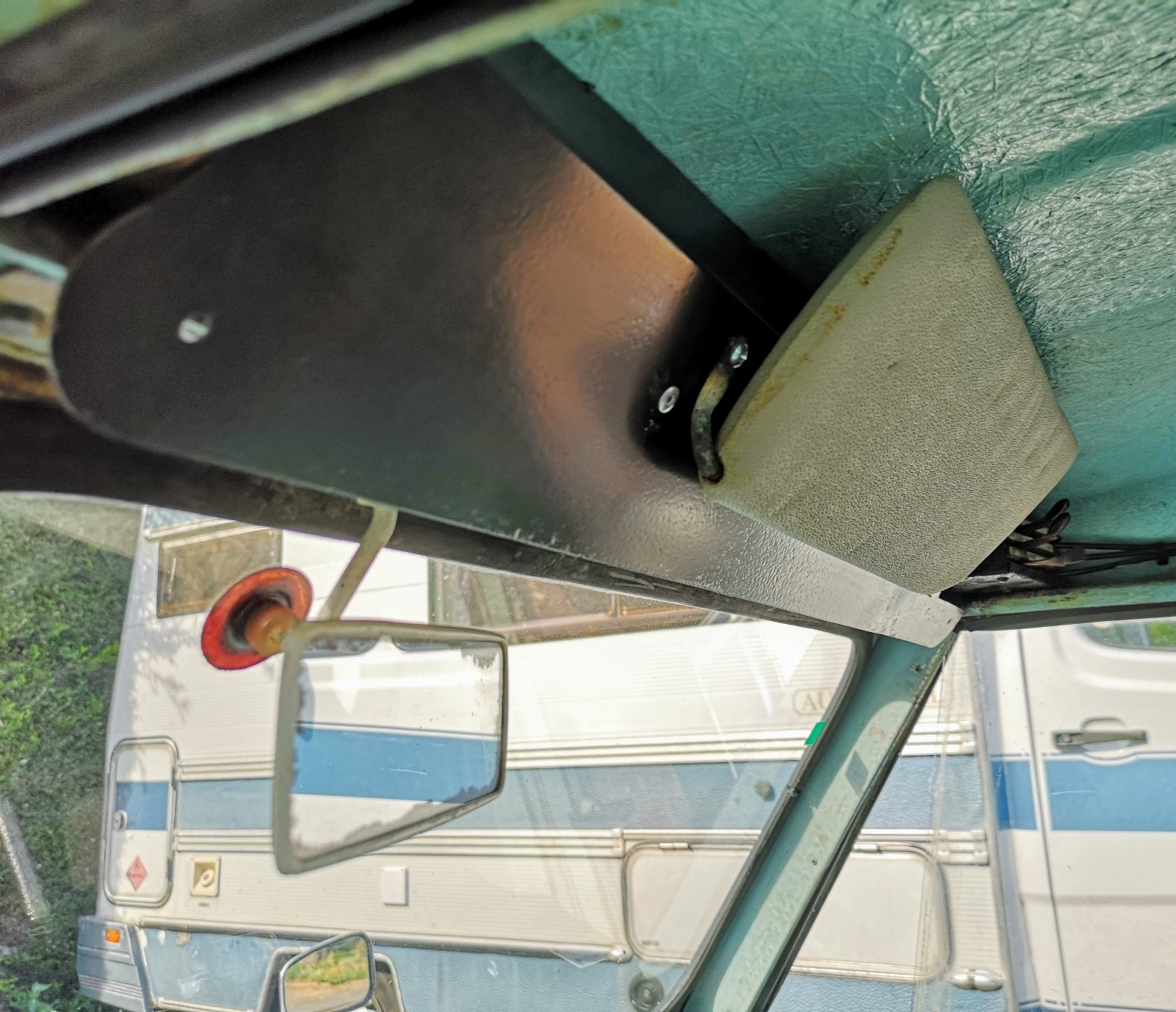

The additional trim panels on the rear pillars has helped the overall feeling of refinement in the cabin I think. It vastly reduces the amount of unfinished fibreglass you can see when you open the door. The roof obviously being the major bugbear in that department now.
Trying to decide when I get to that stage whether to trim the panel behind the sun visor the same dark grey I've used elsewhere or to match it to the lighter shade I'll be using for the roof.
Thinking probably stick with the grey as that will nicely blend in with the windscreen pillars.

The way I might do it is to have on the "visible when up" side the same dark shade as the material above the windscreen, but a much lighter shade on the opposite side, so as not to distract you when driving.
Zelandeth
Posts: 5319
Joined: 16 Nov 2014, 23:36
x 1605
Re: Zel's Fleet Blog - Xantia Activa, BX, Jag XJ-S, Sinclair C5, Mercedes 208D, AC Model 70.
Unread post by Zelandeth »
Hell Razor5543 wrote: 22 Apr 2021, 18:15 The way I might do it is to have on the "visible when up" side the same dark shade as the material above the windscreen, but a much lighter shade on the opposite side, so as not to distract you when driving.
For reference, the original finish here was a sort of stripy textured white fabric.
Which was decomposing when I got the car so was stripped and painted with a black textured paint.
This long predated me deciding to go down the carpet lining route.

admiral51 wrote: 22 Apr 2021, 18:51 Think you may need to wait until you do the roof lining and then decide :)
The panel will be coming out when that happens anyway so it will be a good time to make the decision. That's an easy way to solidly anchor the leading edge of it that I'm definitely going to take advantage of.
Haven't fully dismissed the idea of a crackle type finish more similar to the dash either, though soft surfaces are better for noise reduction.
It's very much a low priority, just one of those things I look at and ponder the long term plan for sometimes.
