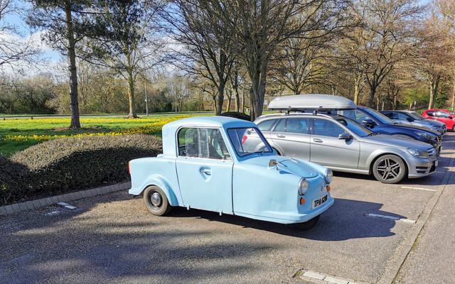

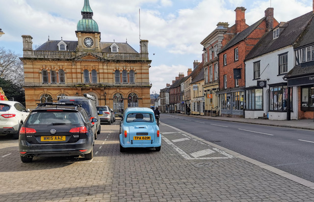

Out and about again today.
Modern cars are just so ridiculously huge aren't they?
Stopped to grab a couple of better photos on the way home as I've been wanting to grab a couple for profile picture type applications for the web page etc.
The curse of that streetlight strikes again - got a shadow on the roof this time.
...And reflection on the lens from the back of the phone case in the other photo.
I'd honestly forgotten that I'd ordered a replacement for the horn that I fitted way back when I first resurrected her as it's proven very intermittent. Fact is the electrical system just isn't up to an air horn...It'll work fine if you're blatting along at 60, but trundling along at 30 it's 50/50 whether the compressor will run fast enough to actually sound the horn or just make pathetic croaking noises.
Arrived with a load of needless plastic tat over it to try to make it look "modern" I assume.
Thirty seconds of levering with a screwdriver later...
Far better! Will get that fitted next time I'm in the garage. Half the size and about a quarter of the weight of what's in there just now.
Yes, I could have taken the Xantia today, could have taken the Jag...Nope, I wanted to take TPA because we're honestly at a stage now where she's just a fun little car to drive.
Overtook several cars on the A5 on the way back home - much to the surprise of the drivers! I was making a deliberate point of holding her at an indicated 70 (honest...) for a good few minutes as I wanted to see what the temperature did. On a very slight uphill gradient (which let's face it is about the best we can expect her to maintain it on...The fact this car can DO 70 is enough of a surprise for most people) it peaked at 165C, which is pretty much smack on 1/2 way on the gauge - which I'm absolutely happy with. I'm measuring this from the left hand cylinder head, which being shaded by the oil cooler should always be the hot one. Given blatting down roads at motorway speeds wasn't really in this car's design brief was why I wanted to make sure the temperature wasn't slowly creeping up when travelling at higher speeds.

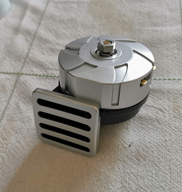

The Invacar with the 70 ish capability obviously tops out the 28mph top speed of the new Citroen Ami Quadricycle, but maybe "small is fun" in Citroen's new love it or hate it offering. Even a dyed in the wool everyday classic man like hubnut, couldn't help himself enjoying driving the new Ami around Coventry.Zelandeth wrote: 24 Mar 2021, 23:23
viewtopic.php?p=680148#p680148
Zelandeth
- Posts: 5328
- Joined: 16 Nov 2014, 23:36
- x 1607
Re: Zel's Fleet Blog - Xantia Activa, BX, Jag XJ-S, Sinclair C5, Mercedes 208D, AC Model 70.
I love the *idea* of the new Ami, but the killer to my mind is the 28mph top speed...Even in a 30mph zone around here that's going to lead to you having an Audi parked halfway into the cabin pushing you along the road to speed you up. 50mph max, then I'd say it was actually usable...but not even actually able to do 30?NewcastleFalcon wrote: 26 Mar 2021, 08:39The Invacar with the 70 ish capability obviously tops out the 28mph top speed of the new Citroen Ami Quadricycle, but maybe "small is fun" in Citroen's new love it or hate it offering. Even a dyed in the wool everyday classic man like hubnut, couldn't help himself enjoying driving the new Ami around Coventry.Zelandeth wrote: 24 Mar 2021, 23:23

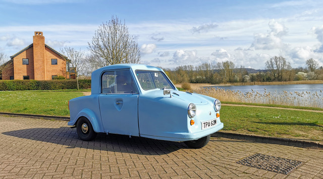

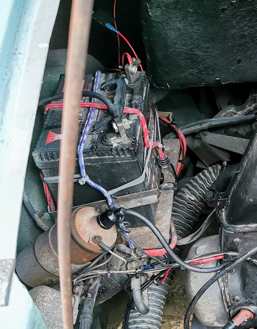

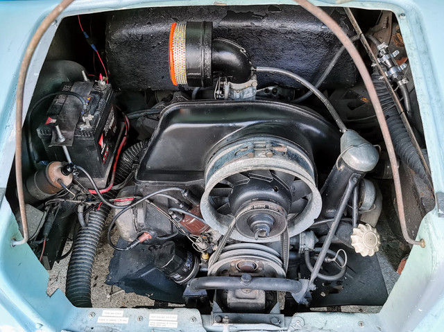

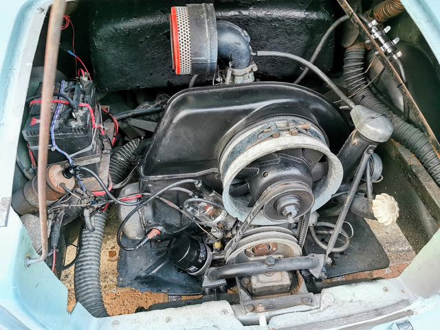

Finally got around to sorting something today on TPA which has been making my teeth itch for over a year now.
Spot the difference.
(Aside from the distributor cap.)
Before:
After:
Yes... finally dealt with this horrific bodgefest.

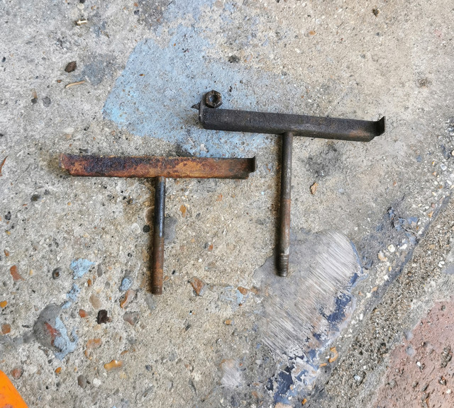

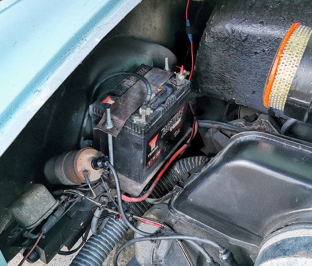

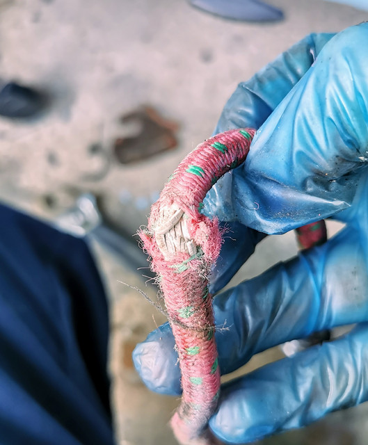

These are the original battery hold downs. Sadly as I was completely unable to find the original form factor battery (or indeed what type it even was), they're basically useless.
Oh, and here's a reminder why bungee cords and cable ties are not a permanent solution.
That had been pinched between the rear wheel tub and the chassis rail and had rubbed about 2/3rds of the way through.

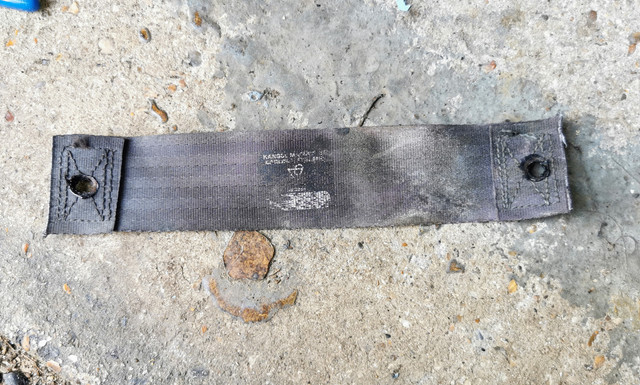

My solution has been to cut a couple of bits of M8 threaded rod to roughly the right length (a little over 6") and fasten a bit of webbing between them - this is a bit of seatbelt originally from KPL I think where the buckles had completely rotted away to nothing.
I heated a metal rod up to red hot before using it as a punch to make two holes. This melts the fibres together and prevents anything from fraying.
Not too worried about that anyway. Ever tried to tear a seatbelt, even if it's already frayed halfway through?
Finished article...
It's tightened up sufficiently that the battery is completely secure. If I have issues with it ovalling the holes out I'll replace it with a strip of angled steel instead - but I'd really rather avoid the need for metal across the top of the battery if I can avoid it given the layout. I might go back and bolt a lip onto the tray though just so there's then *absolutely* no way it could conceivably slide free then. It can't go anywhere the other direction as the wheel tub is in the way. Probably overkill...but I'm a fan of doing what I can to keep Murphy's Law at bay. It's really not a heavy battery either, probably half the weight of your average car one.
I had someone ask me on another forum what the labels on the slam panel were all about - the answer is "me getting fed up of realising I need to consult the manual in the middle of a service one time too many."
Couple of photos from while she was out in the sun today just for good measure too.
Really need to remember to paint that rear wheel arch...I just can't see it from in the garage so keep forgetting there are still white filler spots visible there.
