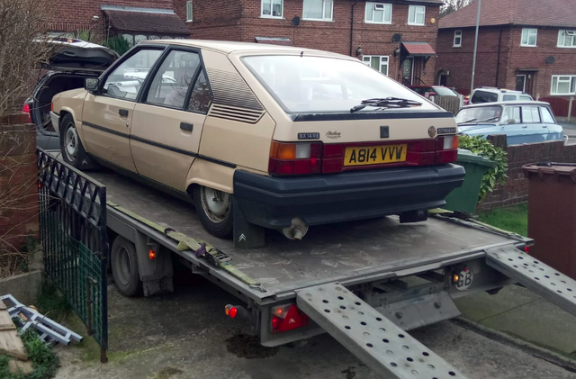

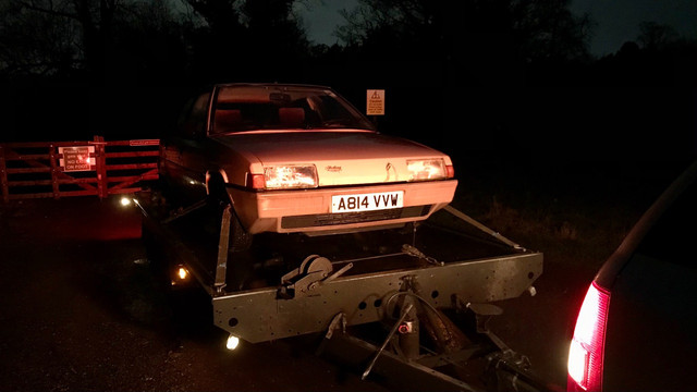

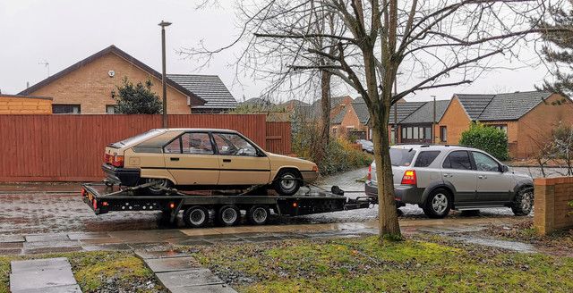

Had a couple of exciting photos today...Late afternoon was the first one showing the car having just been loaded up and sent on its way.
A few hours later it was safely at its overnight halt.
It should be arriving here between 0900 and 1000 tomorrow.

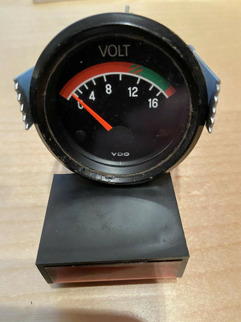

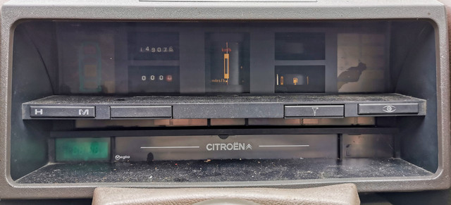

Back on the subject of the Invacar, the final two instruments are now on the way for the dash pod. I wasn't going to bother about this until next month, but the voltmeter ended up going for the grand sum of £3.20 so I was able to get both of them for less than £25 - which is less than most of the older clocks I'd been seen were selling for alone. At least once they're all fitted they will all match reasonably well with the pointers being the same colour, and nothing will look stupid and modern like the plastic tat which I'd previously had in place. That will be really nice to have finished as it's the last really obvious thing which makes the interior look unfinished at the moment.
Voltmeter on two cars recently has saved me from getting into bother when I had issues with the charging system (which didn't bring on the light on the dash!), so I've come to consider it an essential instrument nowadays! Clock is just something which the absence of really irritates me, even though I know it's far from mission critical. One day I might consider swapping it out for oil pressure...but plumbing that in will be a pain so that's a possibility for somewhere down the line. Not worrying about it for now.

Magic :cool: Good to see the BX on its way!

Zelandeth wrote: 17 Feb 2021, 23:31 Had a couple of exciting photos today...Late afternoon was the first one showing the car having just been loaded up and sent on its way.
Not only a pretty rare MK1 BX in the foreground, but you have been photo bombed by an ultra rare Ami 8 Estate in the background!!

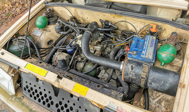

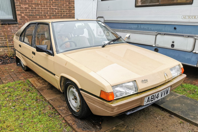

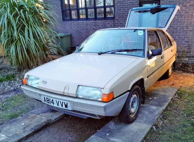

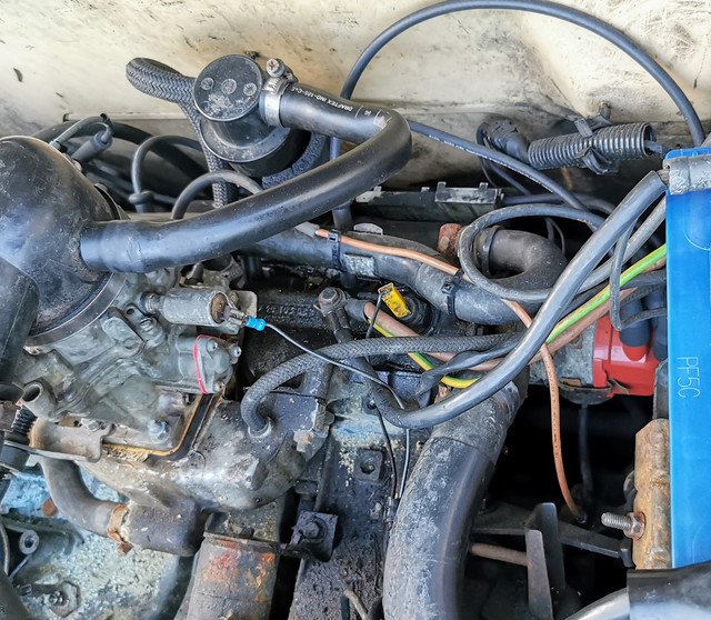

First job for the afternoon was to replace the knackered battery - which meant I needed to have a quick look to see what type I need, giving an opportunity for a 30 second look around the engine bay for issues.
Nice simple looking engine bay.
Things immediately spotted.

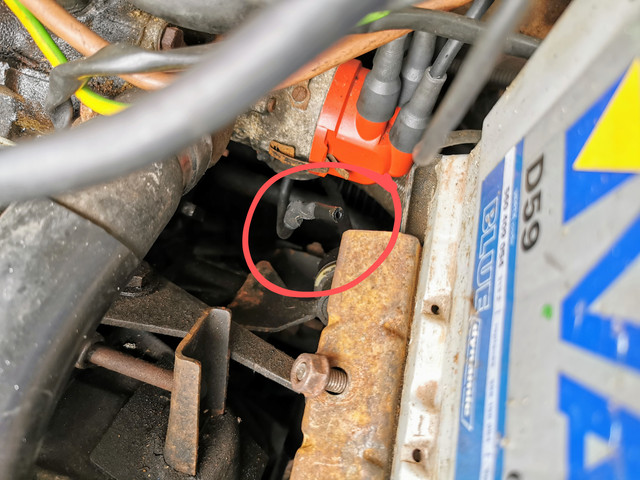

[] Vacuum advance unit on the distributor isn't attached to anything.
[] What looks to be the fuel tank return line isn't attached.

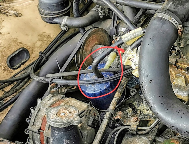

[] Random 5mm pipe flapping around in the breeze which looks like it should attach to the hose stub on the back of the carb which is missing it's hose.
[] Several hose clips are loose.
[] Oil level is quite a bit too high and stinks of fuel.
[] Coolant is low.
Nothing that's making me run away screaming...We had to pause at that point as I had to go to pick up groceries - which involved a run to Costco anyway so adding a battery collection to that run was easy enough.
Fast forward a couple of hours and I was back and could actually take a bit of a better look around.

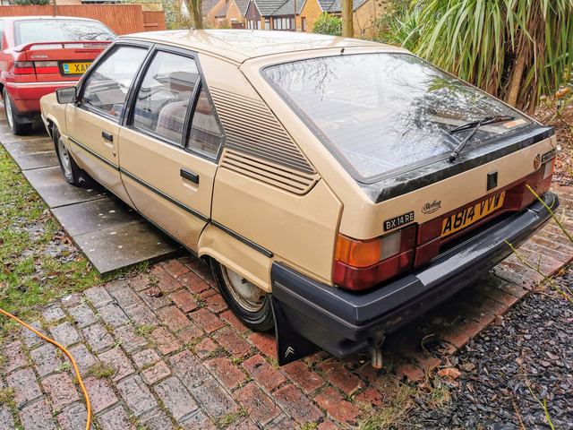

Initial impression: While rough around the edges, I reckon there's the makings of a good car here. A good valet and a set of seat covers would go a long way to making it look better.
The bodywork seems astonishingly free of dents and scrapes for a 150K mile car. Quite likely more than that actually given the exact same mileage is still showing from the previous MOT...

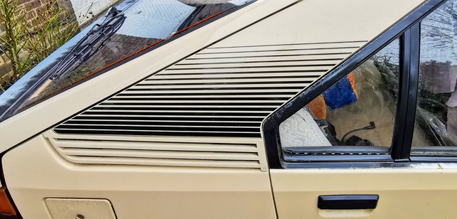

Can you get more definitively 80s than these graphics?

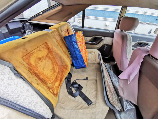

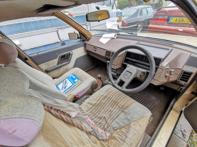

The interior to be honest needs more help than the exterior and is looking a little sad.
Aside from just being generally grubby and dusty in that way all old, disused cars are the single biggest issue seems to be decomposing fabrics. It looks like the seats and door cards all suffer from degradation under UV exposure in the same way as seats on Skoda Estelles do.
Not sure what state the front seats are in under the slip covers currently in place (which are fit only for the bin), but I'm guessing not great. The cover seems to have been completely removed from the upright of the rear seat.
While that looks quite dramatic, the foam doesn't seem to be in too bad shape so re-covering them shouldn't be too difficult.
The cloth on the door cards is clearly going the same way. They're flat though so should be easy enough to restore. The headlining looks in honestly miraculously good shape.

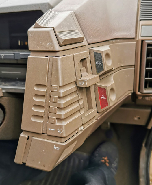

Given the reputation these series 1 cars have for plastics with the structural integrity of cardboard there are surprisingly few things that are obviously broken.
All of the driver controls are present and aside from a few scratchy contacts due to disuse seem to work fine.
Looking forward to actually getting to use these in the real world.

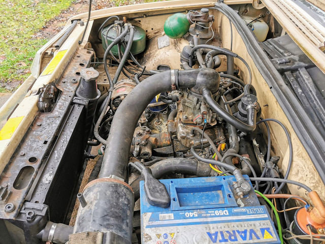

The engine bay is filthy but seemingly pretty clear of the usual maze of wiring hacks I'm kind of used to on cars of this age.

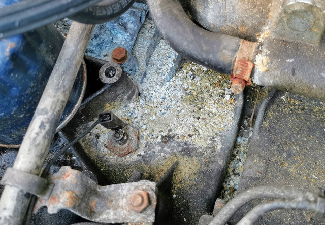

Mmm...crusty...
Cleaning this engine bay is going to be immensely satisfying...

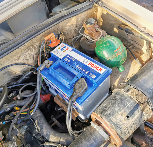

Right, let's actually get some things done. First up, new battery in as the one that came with the car seems to have had it.
New one is annoyingly slightly larger than the plastic tray...so much for their fancy cross reference chart...It'll do just fine though, clamp still secures just fine.

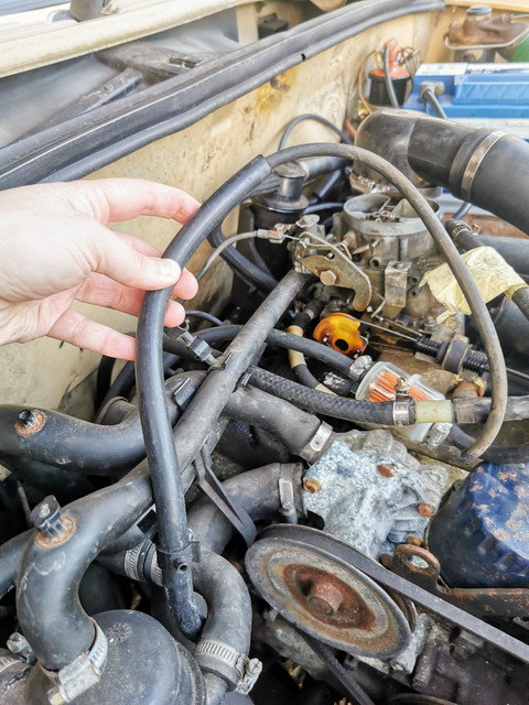

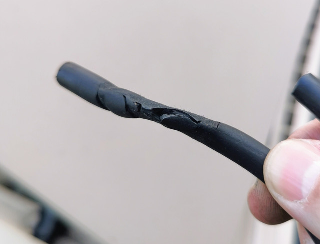

My earlier glance around the engine bay revealed a few things disconnected due to prior investigation into poor running.

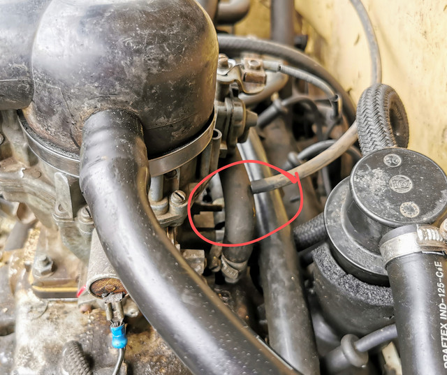

This one I initially thought was a vacuum line.
Turned out that this was actually hooked up to the fuel pump inlet...my guess folks were trying to run the car from a can.
Figuring this out was helpful as it meant I wasn't missing a hook-up point for the connection for the distributor vacuum advance unit, that had me scratching my head a bit initially.
Sadly the line for that was beyond help.
I didn't have nearly enough 3mm pipe in stock to run a whole new line...so being me it was time to improvise!
Two flexible elbows made line I did have, then connect the two with a bit of copper brake line.
Not pretty but will do the job.

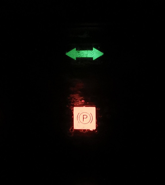

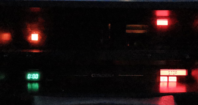

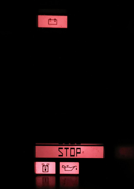

Once it was dark I was able to have a look at how much of the dash lighting works.
Ah.
We have *one* working illumination lamp it looks...above the blanked off space above the fuel gauge. Zip from anything else. Yep...that will need to come apart then!
Speaking of lights that are out, noted that we have no light working in the hazard switch or dash tell tale for the fog lights.
The light in the glove box is working though!
The dash light for the indicators initially wasn't working, but I blinked and it came back to life without requiring any intervention.

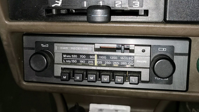

The radio works... though a car with only an AM radio really tells you how long ago this car was made and that it wasn't a high trim level!

Congrats on the new addition Zel - but just one thing - where's the engine? :shock:
A mass of wriggling worms, but no recognisable engine :-D I guess a simpler time....

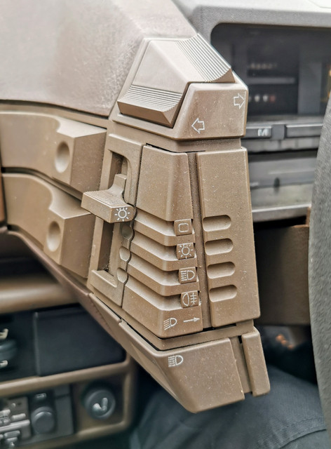

I really love those controls - similar to the satellite pods of the GSA. Oodles of quirkiness that is sadly lacking in today's cars - I do hope you enjoy the restoration, it looks a great BX.
