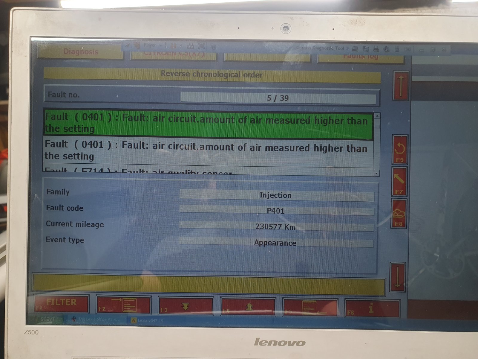

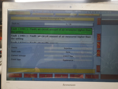

... and it isn't! Stalled at the end of a journey only fault code that comes up is P0401 to do with the egr valve. But this is the fault that comes up ever since I blanked it off and this problem has been occurring prior to that.

This is a Euro4 engine and no EML light comes up when the egr is blanked off

Oh and I've taken note of the mileage (changed to kms while working this out) at the time of stalling and it matches with the fault kms
