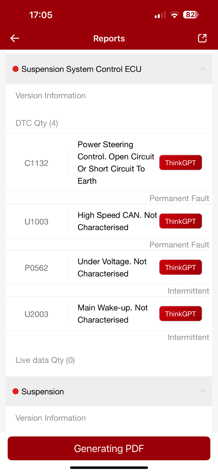

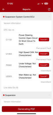

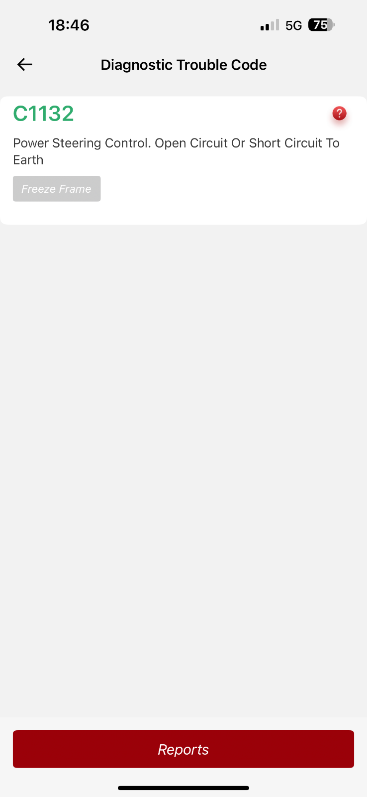

Finally got back under it to investigate today.
Firstly, using the Thinkdiag (couldn’t be bothered with the time to run Diagbox) the CSS module had several fault codes stored. I thought this was the variable steering electro valve (it’s in one of the power steering supply lines) but it’s a three wire component and the wiring schematic shows it’s a two wire component. It doesn’t show any three-pin components in the circuit, except for the height sensors and rear height switch - so what is this item?
(Incidentally I am not the only person to think that was the valve - see HERE )
So I assume it is instead this, which is on the back of the rack. I checked the resistance and it measures around 7 Ohms. That’s measured at the sensor itself (unplugged) and both sides of the connector that sits just above the lower suspension arm rear bracket (the one that I thought I had stretched and potentially damaged when I changed the lower arm). Can anyone please confirm if that is the correct component and if 7 Ohms is ok?

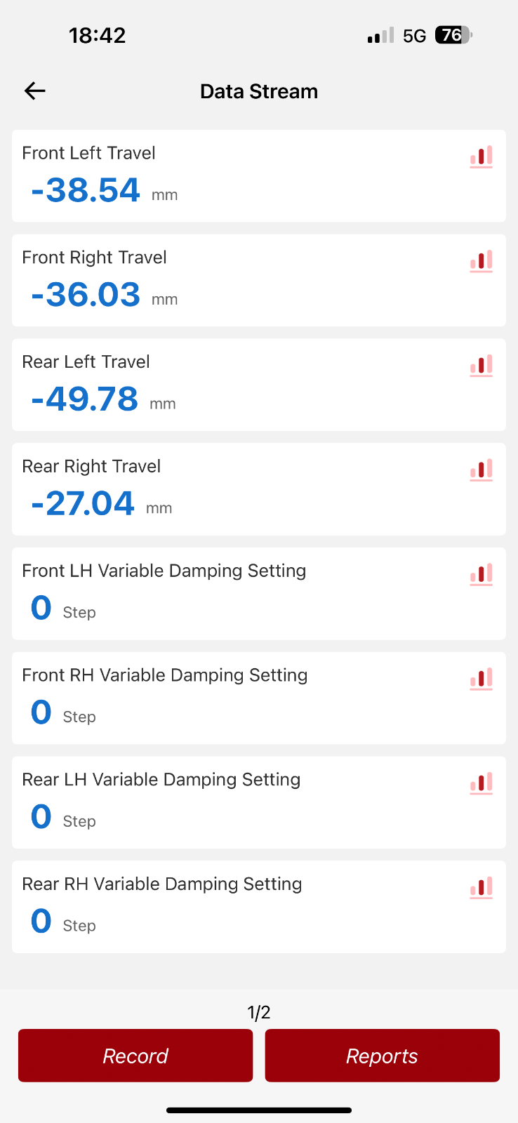

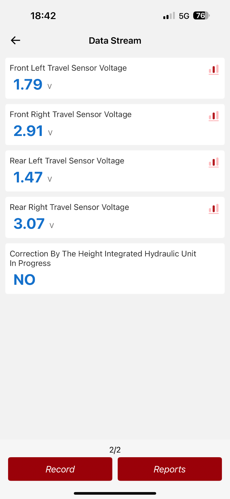

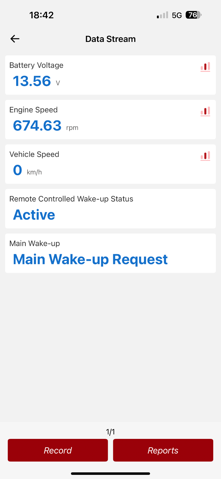

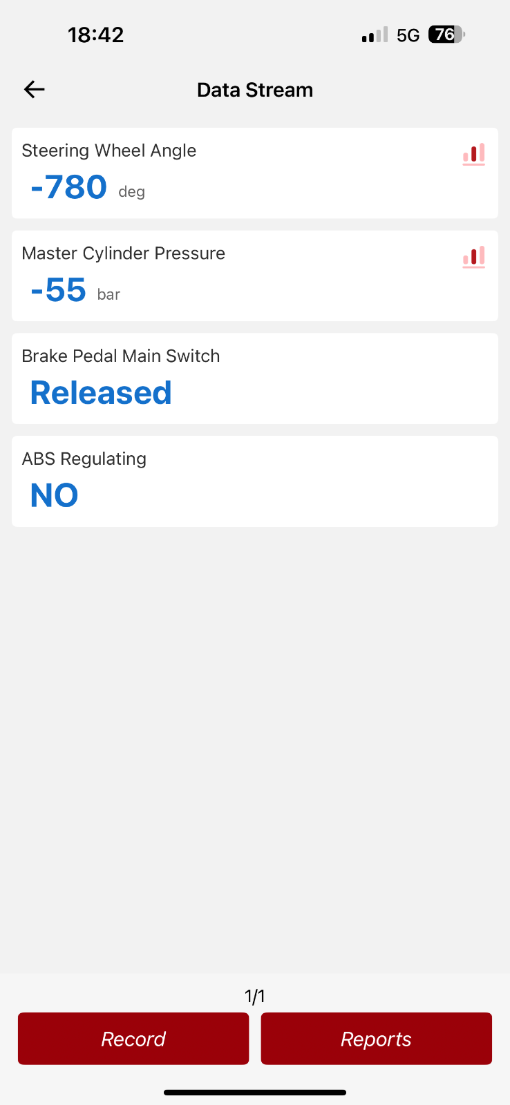

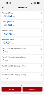

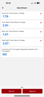

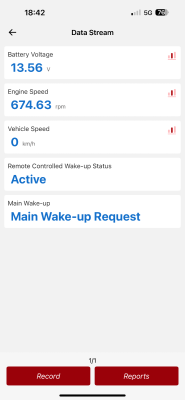

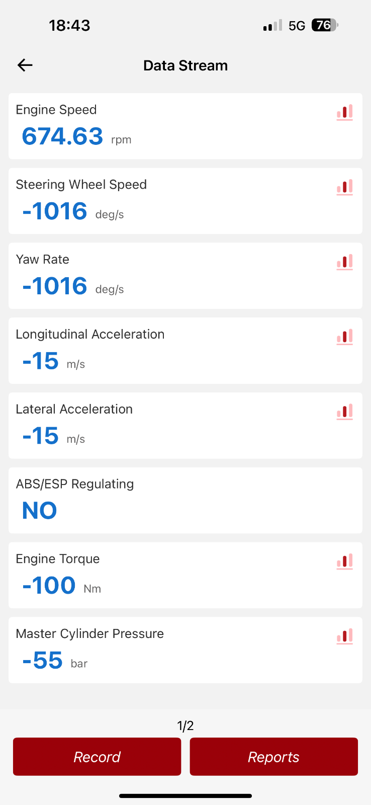

Despite the CSS ECU saying it has no CAN comms and no wake up signal, checking the live data shows it is at least partially working and communicating.
Engine revs and height sensor readings are definitely reading live data, but the steering angle, steering speed and brake release functions didn’t change state.
Does anyone know where the CSS ECU is actually located please? I’d like to check all feeds at the ECU itself and bell out the variable steering valve resistance all the way from the pins there, to see if that shows anything different. Kees posted a pic of the CSS ECU, which if I’m deciphering correctly, suggests it’s in the engine bay, near the fuse box???
After a second code clear it went back to logging on the variable speed valve short/open fault, but no change in what live data it did/didn’t read.

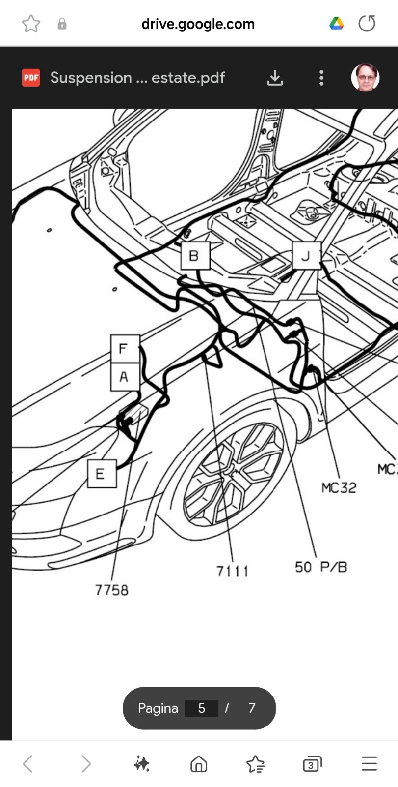

The pile of mush in my skull is struggling to interpret the images in your first post correctly, where is the mystery sensor / connector mounted on the car?
As for the CSS ECU, the PDF I posted a couple of pages ago shows it being somewhere under the bonnet, but the diagram makes it look like it's in the bowels of the car somewhere under the fuse box.

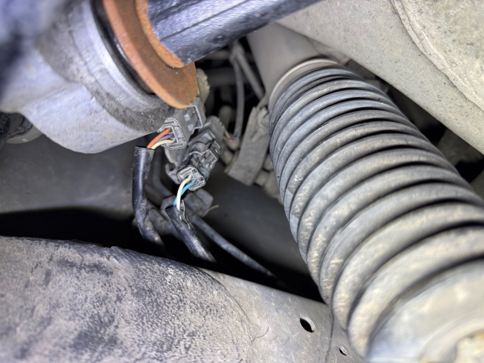

Oh yes, bum - I’d forgotten about that page of the pdf! Thanks. That does seem to confirm the ECU is near the fusebox. Guess I’ll dig that out tomorrow and test from there…
(Nb: neither the wiring schematic, the wiring diagram or the wiring harness drawing show all connectors in the circuit/wiring harness - they all show only a 2pin black connector, at the variable steering valve, but that’s the intermediate connector located by the passenger side suspension arm - the actual connector at the valve, is at the other end of a sub loom from that black connector and is blue in colour.)

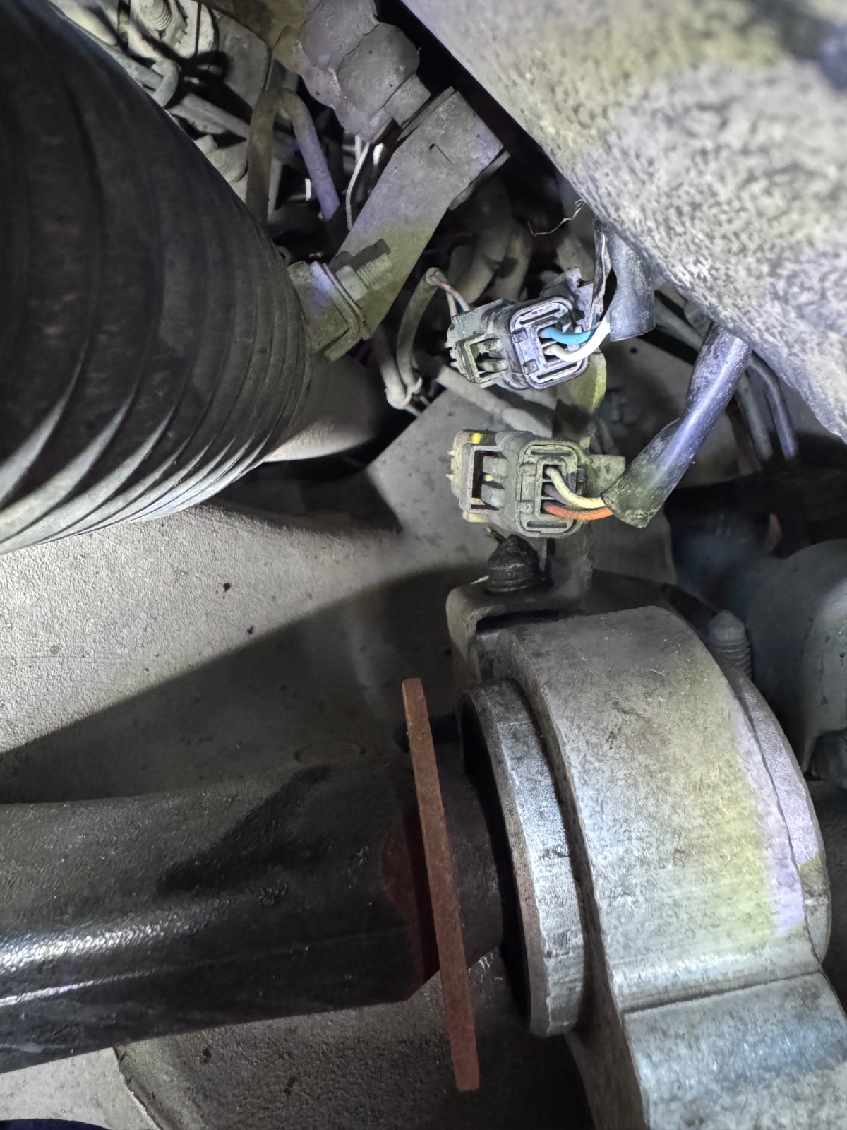

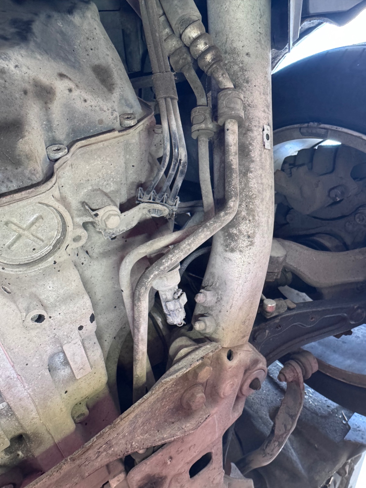

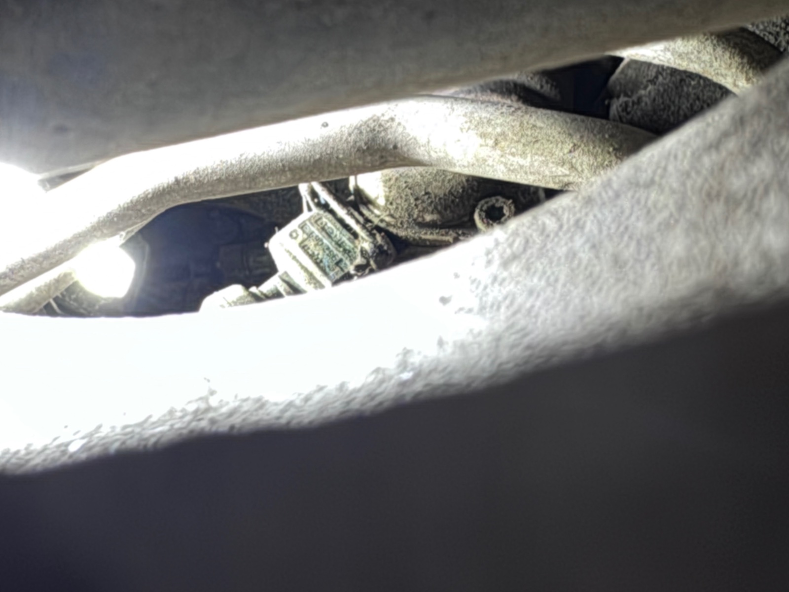

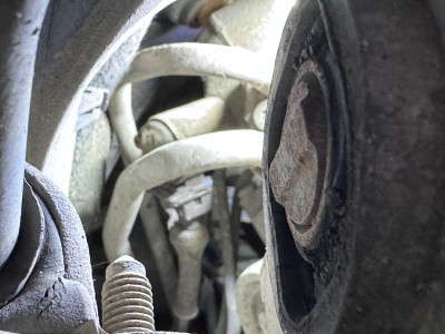

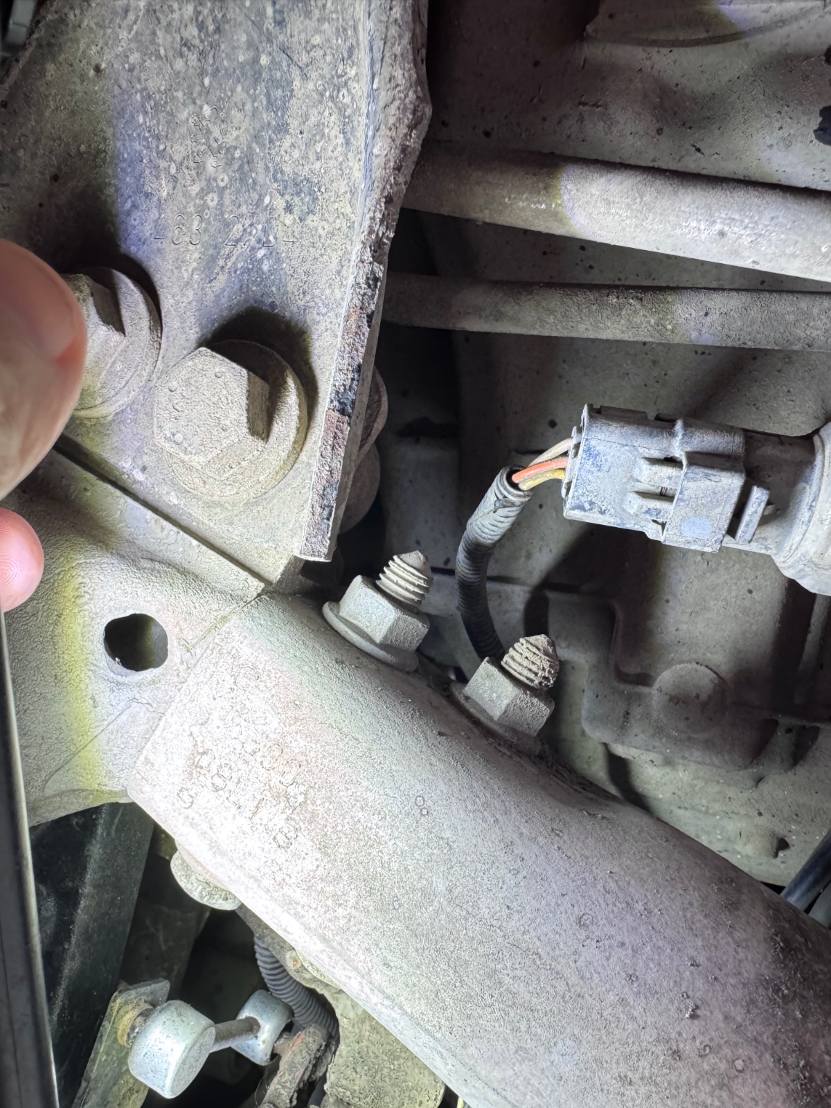

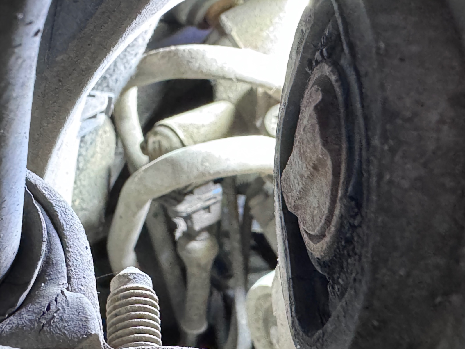

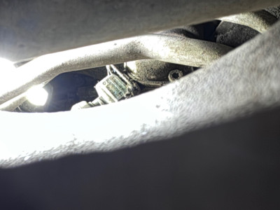

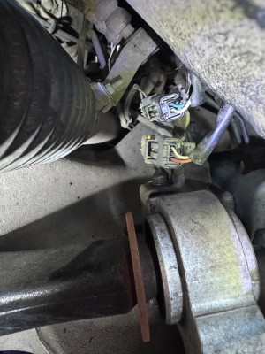

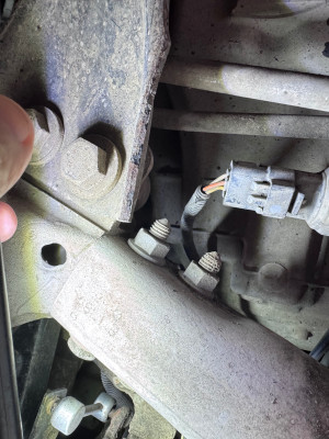

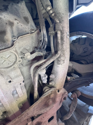

For the pics in the previous post (everything is a nightmare to access and photograph on this car because… well it just is because there’s so much crammed in with that big engine!):
The three wire component is passenger side, under the gearbox next to the aluminium front-rear arms on the front subframe.
The two wire component is on the back of the rack, viewed through the gap between the back of the front subframe and the firewall from underneath, and from the back of the drivers side inner wheel arch.
The two wire intermediate black connector is at the rear of the passenger side inner wheel arch.

So basically this wiring diagram is a bit deceptive. It makes it look as if the plug for 7111 is on a loom that drops down the firewall in the middle of the car. Instead it drops down to the back of the inner wheel well and is held on a bracket there, above the back of the lower suspension arm. There, it connects to a sub-loom that runs across the top of the steering rack to the valve.Kees wrote: 02 May 2025, 20:52
You see, that connector 7111 is in the same wire harness as the wire from the height sensor, maybe there is something wrong, sometimes because of the movement and some corrosion there's the reason for your problem.

Been digging around the electronics portion of the documentation. Found the PS section and holy cow, it's coloured and interactive! Unfortunately the interactivity doesn't translate to the PDFs.
The electrovalve connector is 7111, the 3 pin listed as 1341 is apparently the DPF differential pressure sensor. I'm not sure if this is the mystery connector from your photos. Also no luck finding resistance or expected measurement info for anything as of yet, but I'll keep searching.
