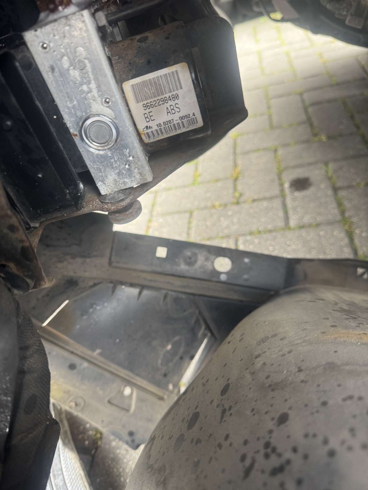

Abs pump
Abs pump
Abs pump

If these numbers match will it be the same one ???

Can anyone say it's definitely this at fault the car was sat without battery during the winter then this all happened

Re: Citroen c2
Unread post by wheeler »
It would be really hard to say 100% without being hands on myself. Assuming you have done the checks correctly then it looks like a failed hydraulic block/pump.

Juliano_1989

Re: Citroen c2

Re: Citroen c2
Certainly the power steering & speedo faults, not so sure about the airbag though, could be unrelated.

Re: Citroen c2
Unread post by Juliano_1989 »
Can I ask why the power sterring wound be related to the abs pump/ecu ???

Re: Citroen c2
The road speed information comes from the ABS, the power steering system needs to see road speed information to operate correctly as the level of steering assistance changes depending on vehicle speed.

Re: Citroen c2
So it's more than likely the abs pump
