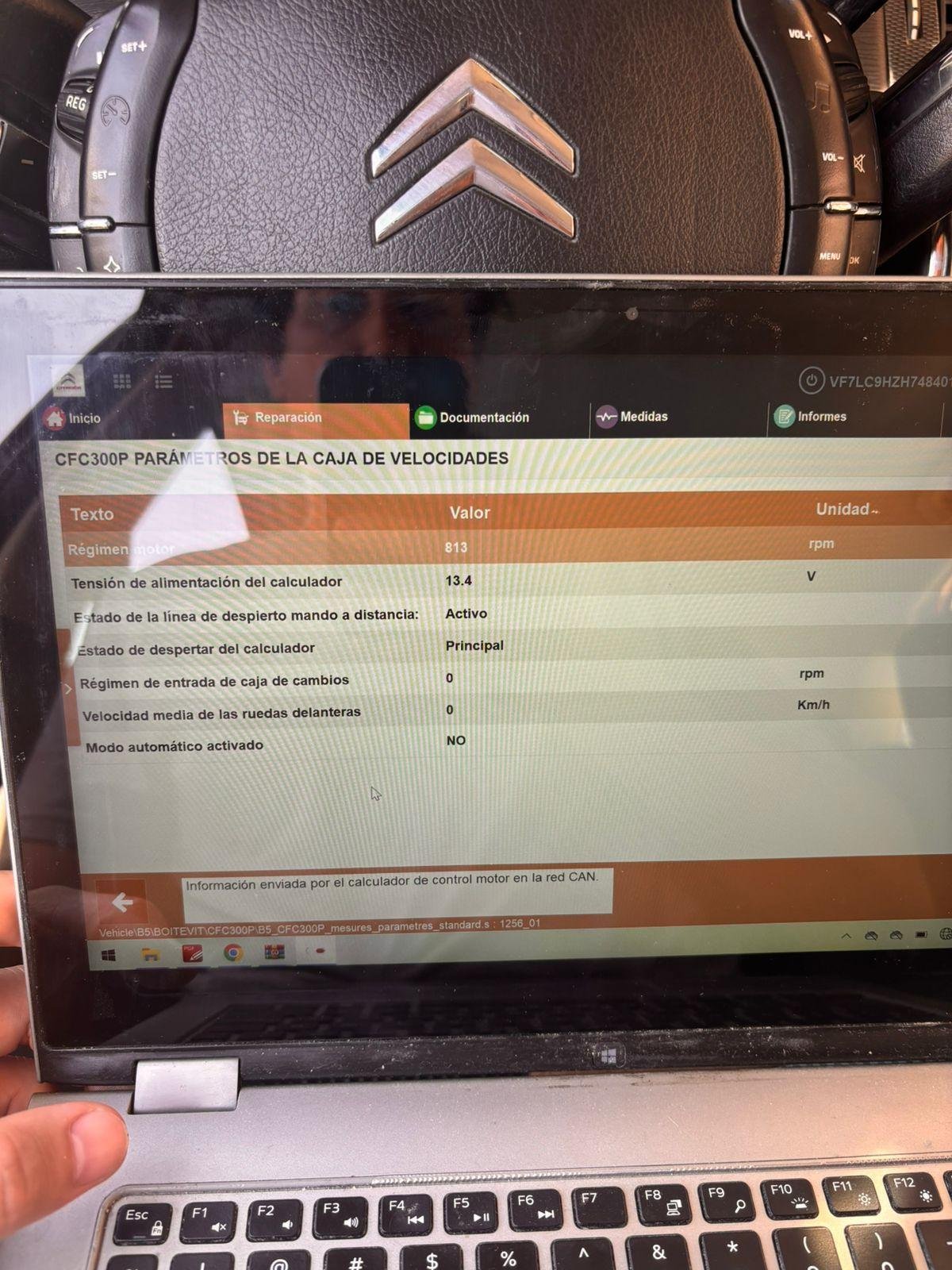

Hi, I've recorded a video yesterday and also noticed something that I don't know if its right: When I check the parameters of the gearbox, the rpm measured by the gearbox sensor shows some rpm when I turn on the car, but then it quickly goes to 0, and shows no revs until I put the car in auto and move it. Is that behavior right?kalm007 wrote: 08 Aug 2025, 20:57 Yes, Yes I understand. I talked about this problem. If you press fully throttle there will cause this problem ,that the "clutching process" a little bit slow. But I do not understand why the clutch is slipping when you press the fully throttle.
I am very curiosity.
Another conclusion is that the car behaves has it is always departing in 1st gear: It does not cut the throttle, and it release the clutch slow (just as if it was in 1st gear).
In the video https://drive.google.com/file/d/1n7FP8 ... p=drivesdkyou will se how it departs fine from 0km/h until it engages the 2nd gear. you will notice that the gear is engaged quickly, but the clutch release is veeery slow, that's why it makes the clutch slip a lot. (keep in mind that the clutch is brand new). Also you will notice that the throttle is not cut during the gear change..Any thoughts?

I can’t check the pressure live if you remember, my ecu does not allow me to see that. I’ve changed the pressure accumulator because I used to have the P0868 error code, but I that is now solved, and to be honest I dont hear the pump working a lot, it’s activated every 60 seconds or something.. to be honest I don’t know what else can I check..

Yes I remember. Can you take a picture what the problem is when you would like to open the transmission menu?
ramirofiso
- Posts: 37
- Joined: 24 Jun 2025, 10:30
Re: Citroen Grand C4 Picasso 2012 MCP6 error
I can open the transmission menu and select a lot of different measurements, but it does not let me select the hydraulic pressure measurement. I will add a picture of the error tomorrow, but basically it says something like “your ecu does not allow to show this parameter”
