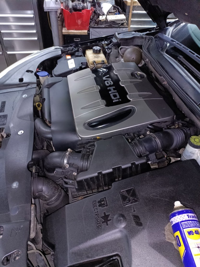

It's a shame the underside is so crusty as I even keep the engine bay gleaming...
...and that was me just about to set to cleaning it up :-D
