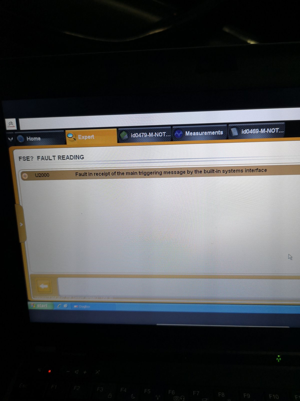

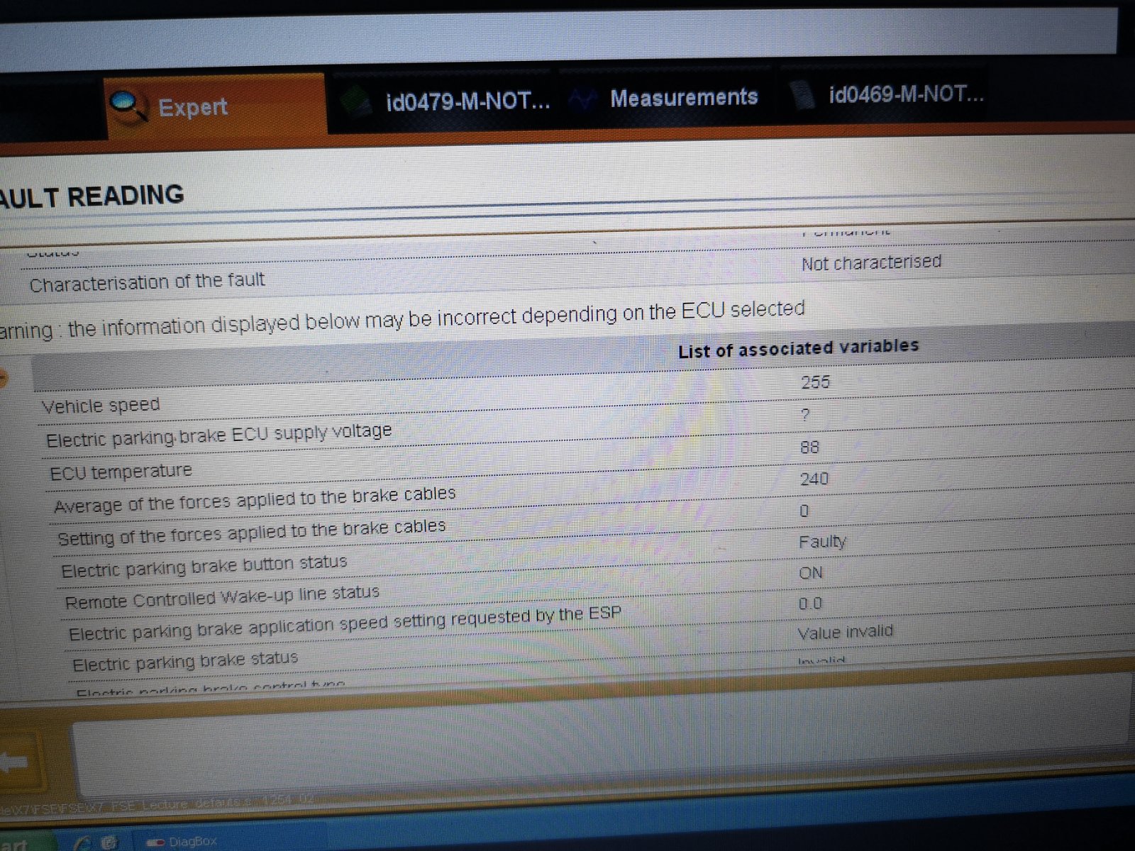

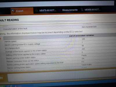

These are my fault codes. Managed to delete most except these. They are probably permanent codes. There can't be cleared with a drive cycle as fault trigger after removal of car keys or turning the ignition off.
Wonder is it the permanent codes that triggers the error? Will a simple remap to delete the permanent codes solve it?

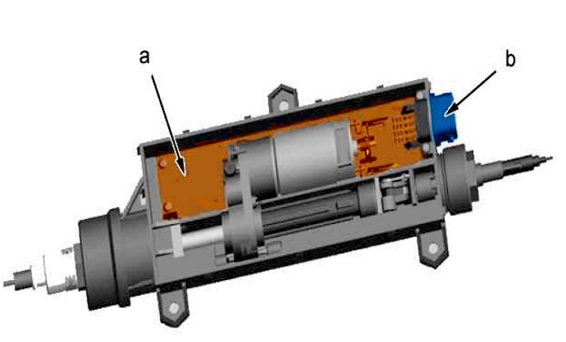

Don't shoot the messenger guys, I don't work for Citroen, but I'm just telling you that in all cases of this issue I know of, the replacement parts have not been bought from official sources where this problem is happening. As you can see the EPB ECU shown at 'a' which is a slave to the ESP ECU elsewhere in the vehicle, is integrated into the electric parking brake assembly; these components cannot be separated.
They are made by Continental Teves
So it may well be that these are clones and may not 100% compatible if they don't have the correct programming / circuitry. Take the Chinese Lexia Clones that most of use have to use - better than nothing, but they are not originals despite all the fake labels. .... and I doubt any Citroen technician would really be able to tell you if it was a fake or an original to be honest they are not trained investigators - only to fit the parts and probably just rely on the label
AinurC5X7
- Posts: 35
- Joined: 07 Sep 2023, 12:39
- x 2
Re: Citroen C5 2.0i 16v auto al4 handbrake problem
Love the diagram and explanation! Don't dare to shoot the messenger! I looked up the ECU details of the parkbrake on diagbox, and interestingly, its identified as from Teves.
