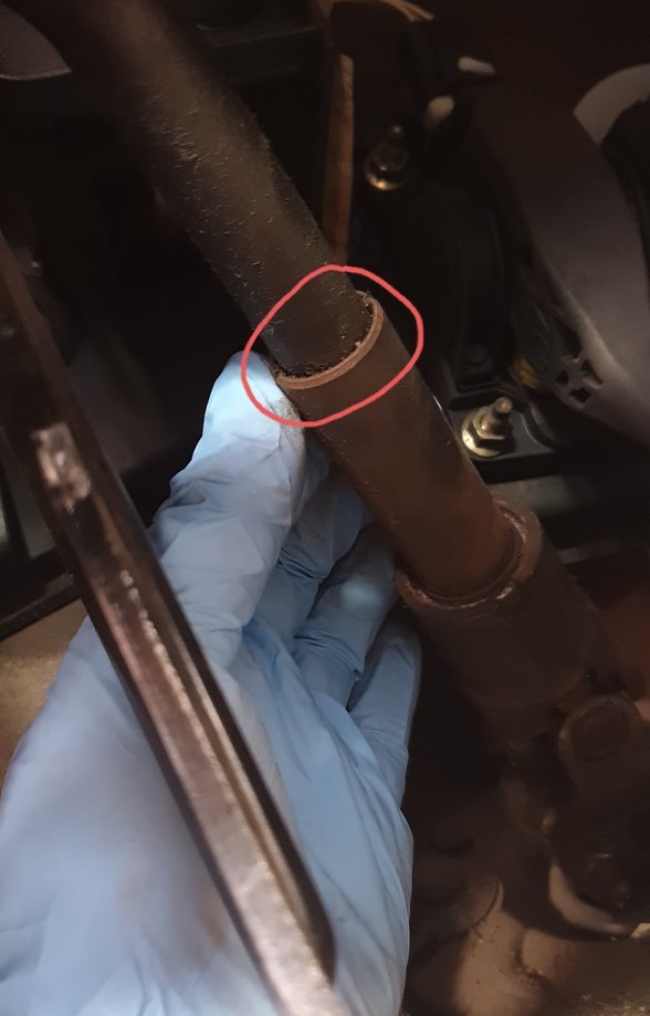

Mine was ok, it was Just the vacuum tube that was broken , and that throws away a lot of bad codes when the valve wants to open at near 2000 rpm , as the vacuum is lost in the entire system.MattBLancs wrote: 11 Jan 2023, 11:54 Ah, good images, will have a look at mine soon and report back.
You've triggered a thought, remember reading on the 406 Coupe forum that a member was struggling to find a replacement actuator - think that may well have been swirl flap actuator (138bhp 2.2 available in the Coupe too)
Seems to be a known problem on these engines. Access to that tube is terrible. Lucky me that my hands barely fit there while i'm laid on top of the engine
On the place i usually buy parts , they could get me one actuator for around 80€ if i well remember... Good that wasnt needed.

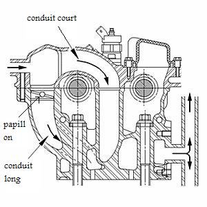

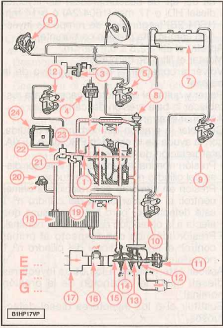

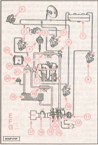

This is another view from what the valve does for better understanding: And here we can see the vacuum lines and valves on the 2.2 hdi. It helped me a bit to follow all and better understand how it works It's in spanish , but i'm adding also this , as it can be useful for someone in the need:

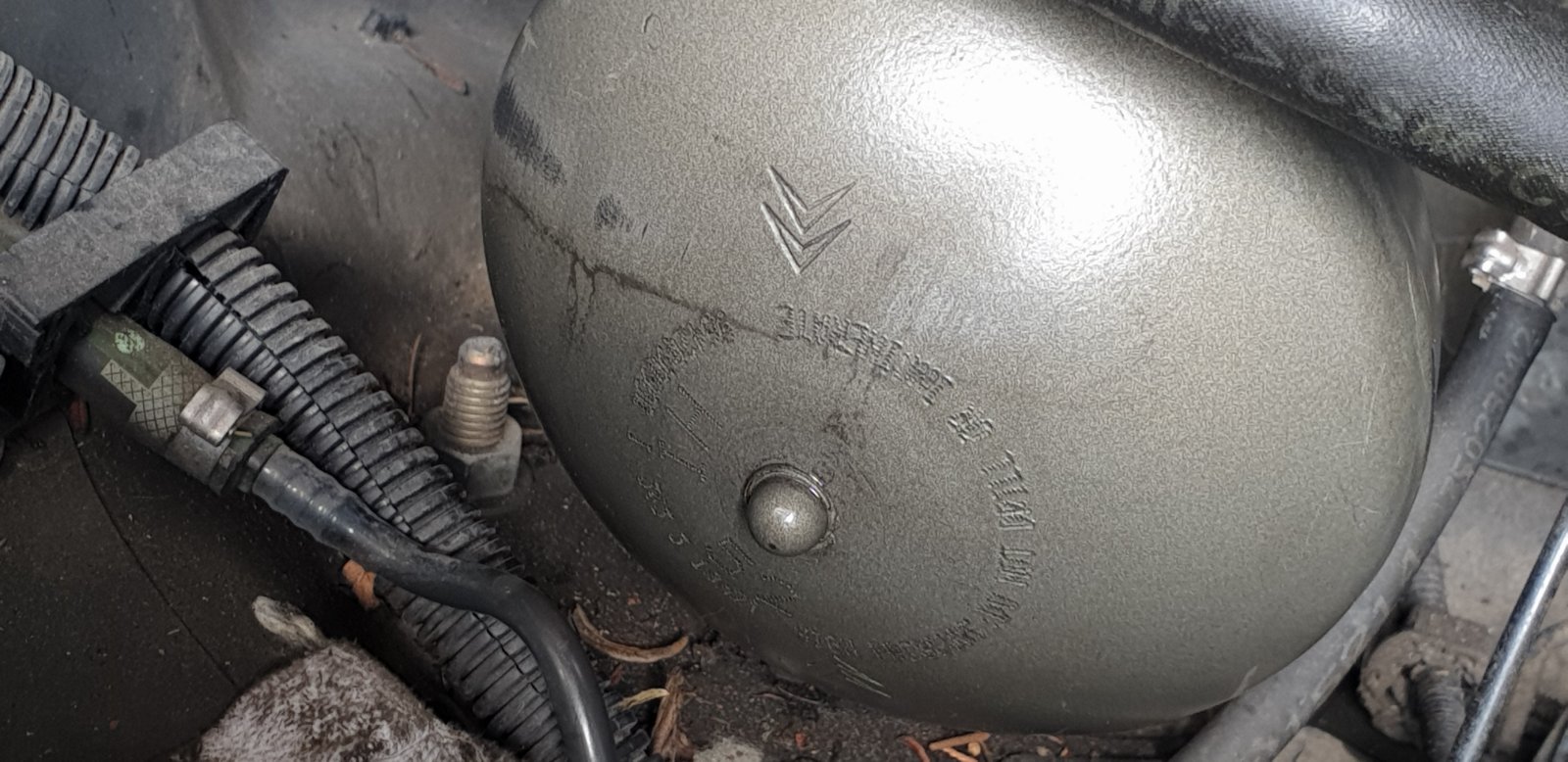

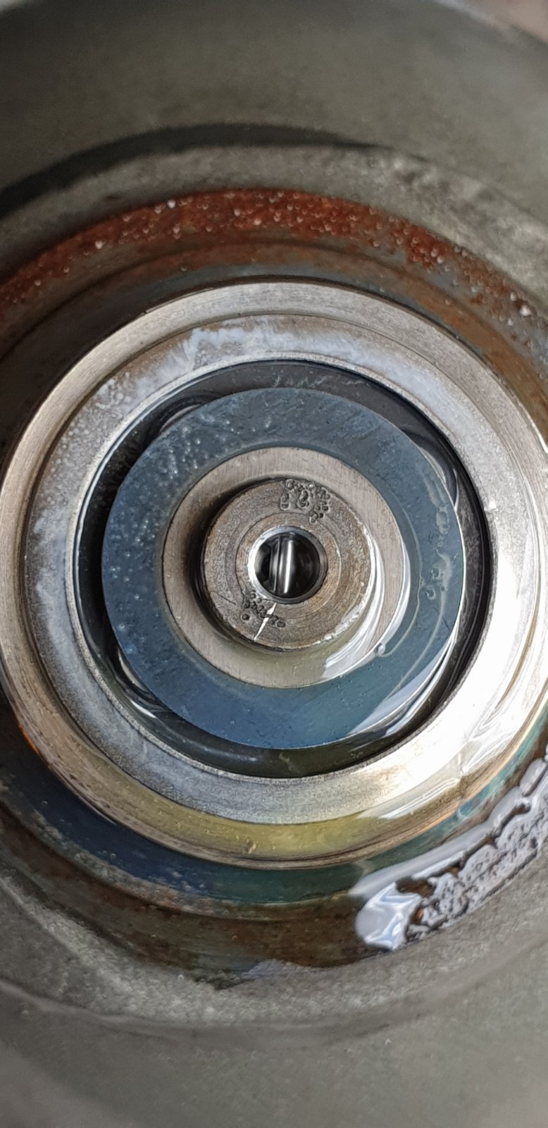

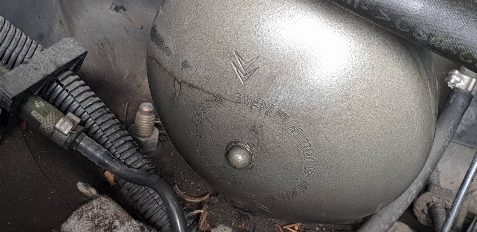

Today i took one of the spheres out and... It was like this. Anyone have seen one like this? Its an H3+ and it is one sphere from the front (52 Bar)
Should i open a topic regarding to it? Or should i look for a great one i saw recently about spheres and put this image there?

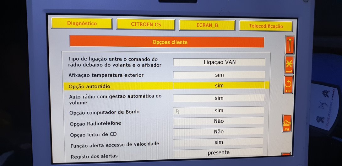

On the side that "Dont need to spend money" is the assembly of the Alpine radio (Already had it on the 2.0) , that will allow me to have hands free cellphone communication , USB , CD, Aux and Bluetooth Audio. Maybe in the future i put also the PXA (DSP) some amplifiers and a Subwoofer - Not a priority for now. Basic sound with the speakers i had in the 2.0 is quite good enough.
However... I realized that some wiring is almost broken on the doors , so sometimes sound from door disappears while closing it. Hope is not too hard to put new cables to the door. (Bypass the others)

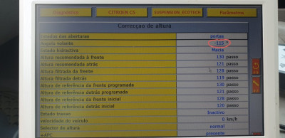

Also want to do the procedure to regulate proper heights both in front and rear (Suspect they are not totally right)
Then a bit more cleaning & detailing on the interior (Exterior , i already took good care , polishing & waxing) , to the 2.2 reach "proper condition"
Have a few doubts on things i saw on Lexia , but maybe it's better i close this post , and add another "reply" on it. It's already too big

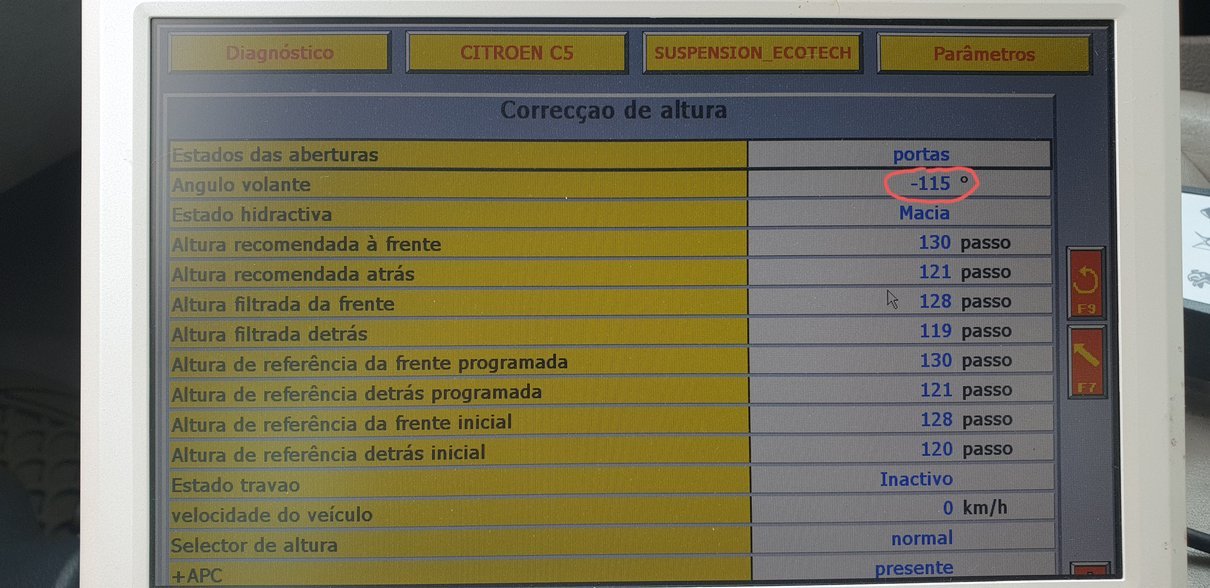

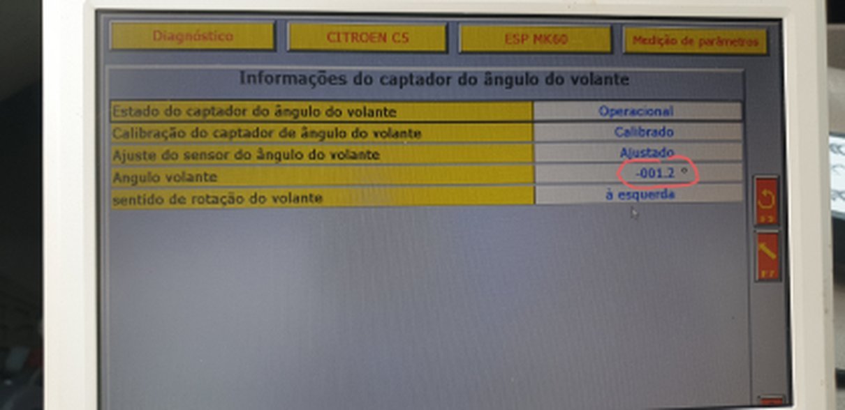

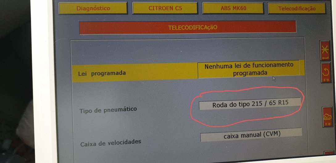

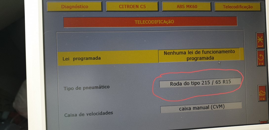

This is a bit more "Visual" topic. Let's see how it goes:
Any thoughts on heights ? Does something seems off here? Need to do the correct procedure. Didn't touch there yet.

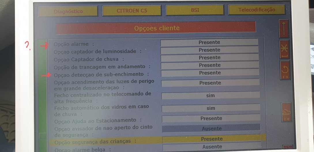

Let's see if this format works well to put the right questions regarding to my initial findings & doubts on Lexia.
Sorry that it is in Portuguese. Feel free to ask in case you dont understand what something means.

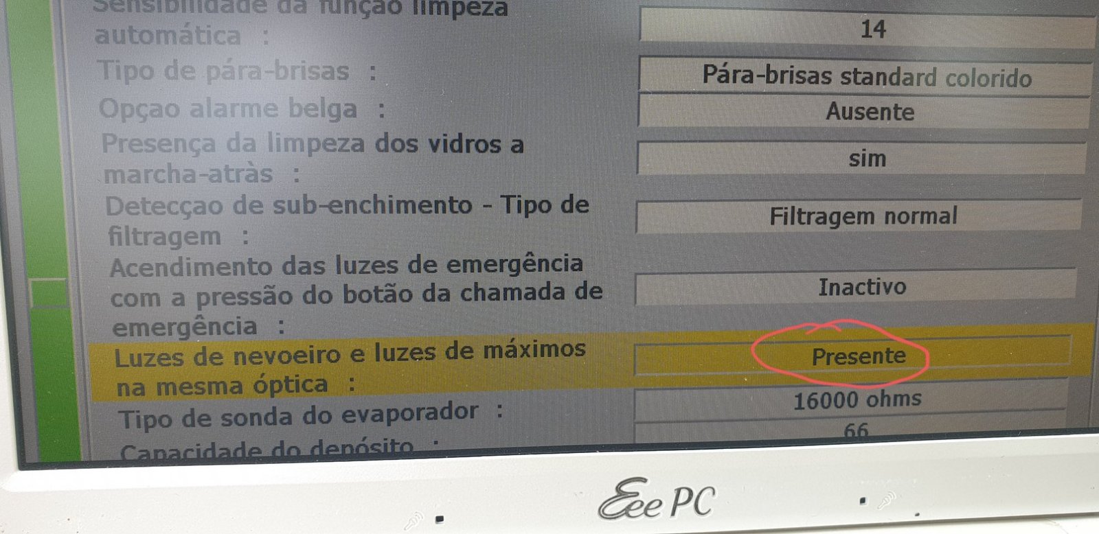

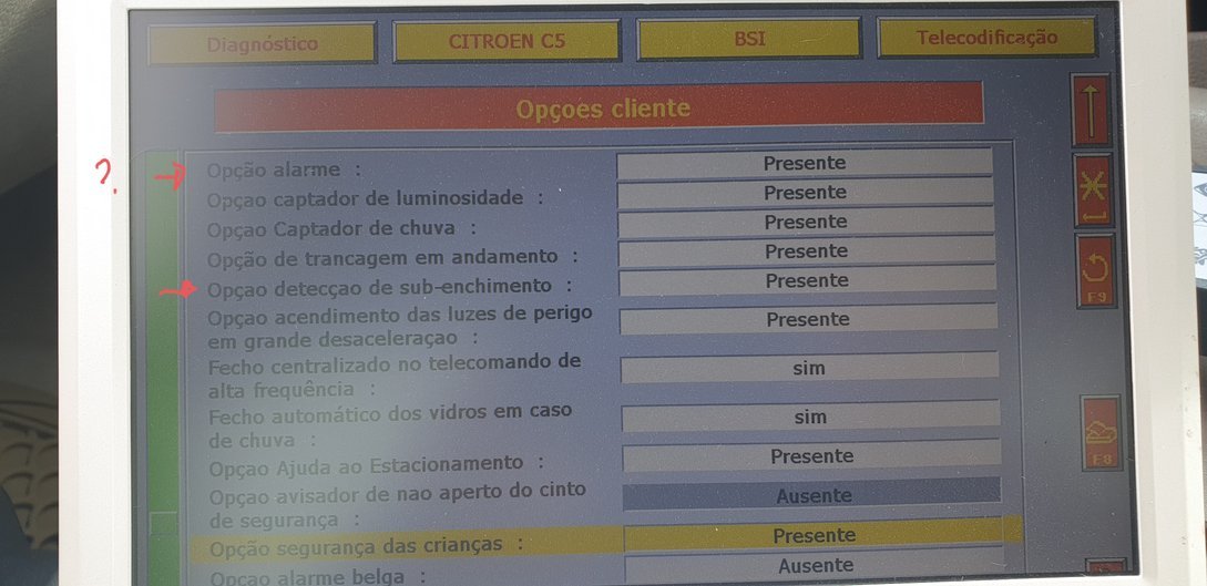

A bit more "play" with Lexia , and a bit more km driven on the car.
Disabled the alarm , as it was not working (Will have a deeper look on that and put it back to work if possible)
Tire Pressure Management is disabled also , so no more annoying noise every time i start my journey.
So far, and what i will take care in the next few days is the noise on the trail arm bearings , and i have the feeling that the braking is not right... Have the feeling that is more biased to the rear brakes. Unsure if it is contamination on the front braking pads / discs (discs look quite clean now , but they weren't) or the "strength divisor" from front to rear (Unsure about the name for it in English) that may be not working well. Where is that part located on Mk1 C5's?
