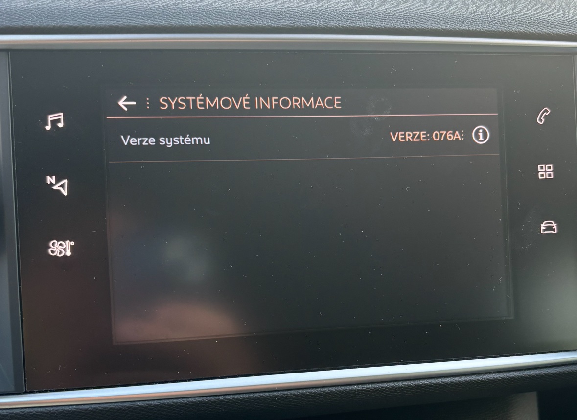

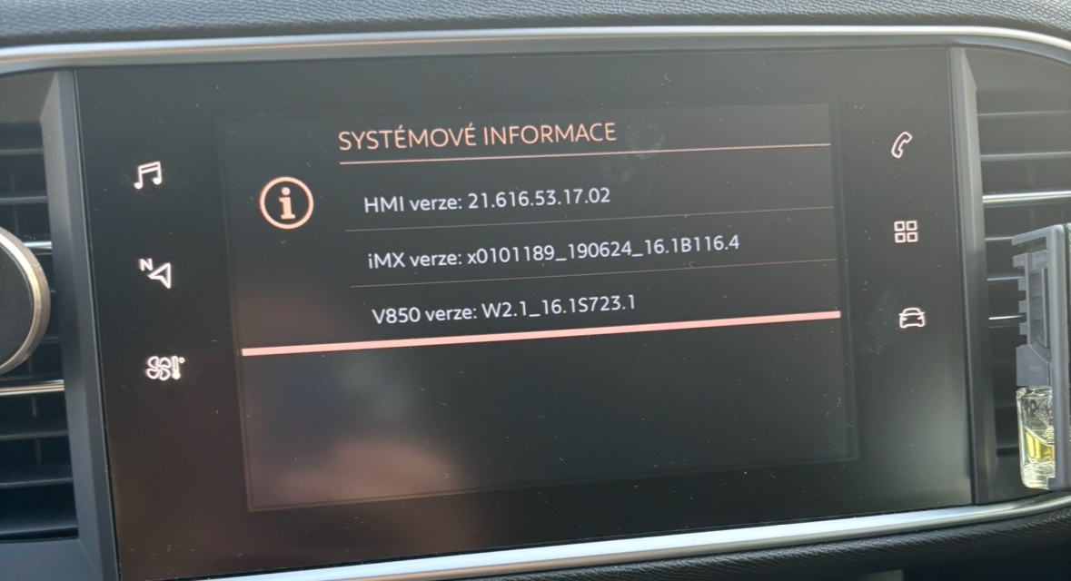

Instead of create a new topic i would like to ask you guys if there is some posibility to get a carplay on this radio

Both photos are completely black for me.

Sorry u edit them to smaller one.

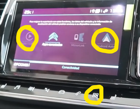

Ok so you have a Connected Analogue Mono Radio, so if CarPlay or AA is not already available when plugged into the USB port and pressing the button as show, then it's not available. Your specifications state 'Without Mirror Link', so without this, it's unlikely you will get it. You may need the colour RCC to get this or the NAC system.

Given those versions, it's a very old RCC Wave 2 system, probably this one:
Code: Select all
  "updateType": "rcc-firmware",
  "updateVersion": "0_12F_15.7A133.5",
  "updateProvider": "BOSCH_CAR_MULTIMEDIA",
  "updateId": "005315191477041014",
  "updateDate": "2016/10/21 11:37:44",
  "updateStatus": {
    "code": "DEL",
    "label": "Supprime du serveur"
In the previous menu screen, you should see a "System version: vvvx", where "vvv" is the version number (probably 12F), and "x" a letter from A to D, the hardware capabilities/revision. Only the C and D versions support Apple CarPlay and Google Android Auto (what PSA/Stellantis calls MirrorScreen):
RCCOnly AM/FMAlso DAB
No MirrorScreenAB
With MirrorScreenCD
