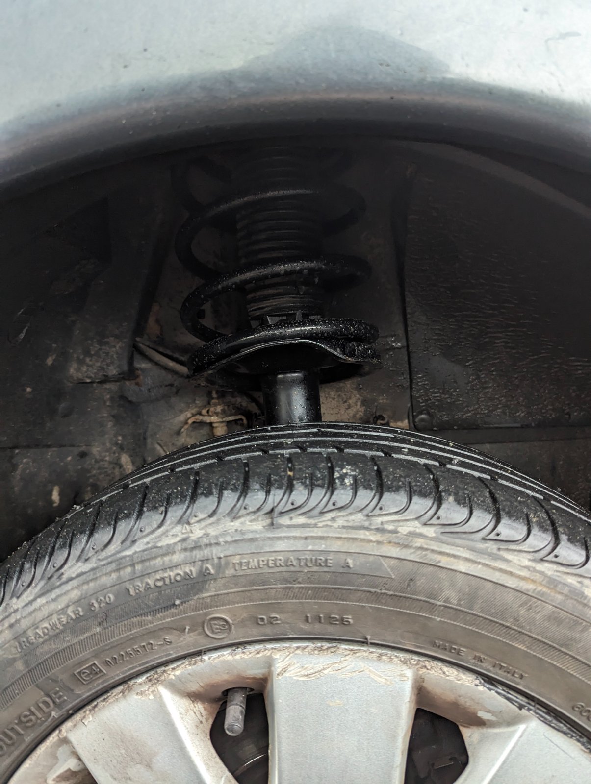

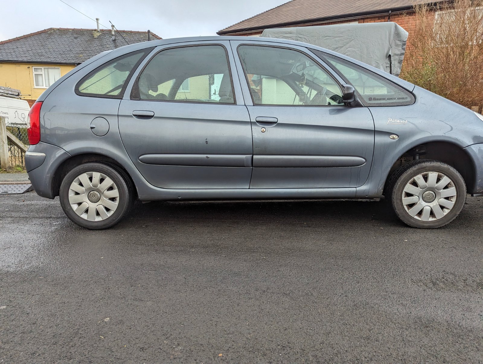

Just wondering if someone could post the part numbers for the springs and shocks just had mine done and the cars well high at the front

The springs set the height, were aftermarket ones used instead of Citroen ? Citroen ones have coloured bands on them to identify the different ones, do you know the colours of the removed springs ? You will need to provide your VIN so the correct ones can be looked up for your car.

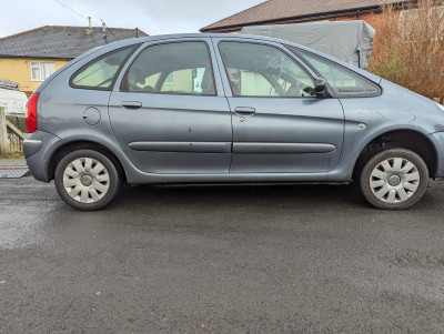

Just had the car back today and still it's sitting too high mechanic has used the right OEM number apparently I'm at a loss as to what is wrong

Did you use a Citroen dealer to fit the springs and did they use springs supplied by Citroen ? If pattern ones bought against the Citroen part number they could be anything.

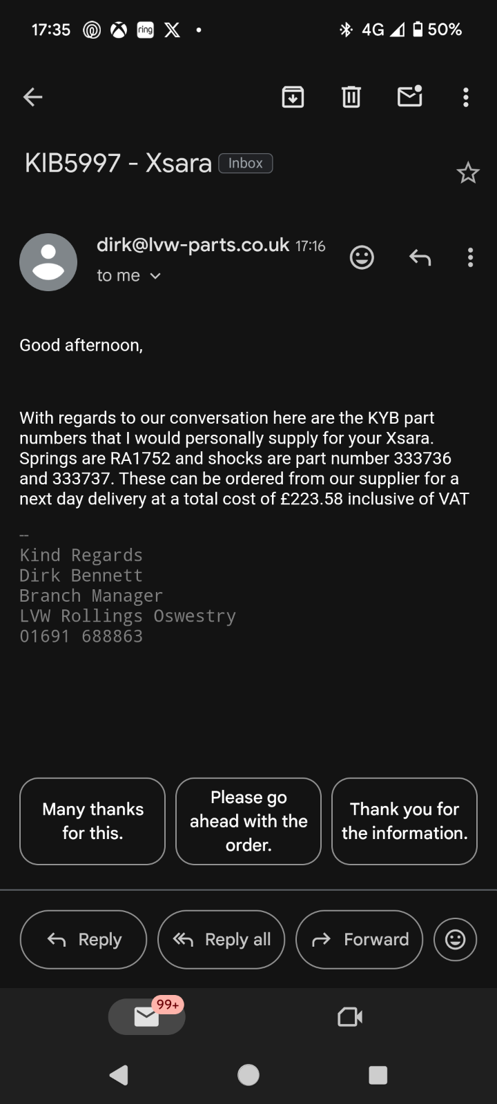

No I didnt Citroen do not make springs or shocks for this car now. These are the parts that are now being put on is that correct? We've cross referenced them on the Citroen website

I don't know where you are getting your information, but shocks and struts are still available from Citroen for the 1.6 HDi 92. Your issue is probably incorrect part numbers from aftermarket suppliers as is evident from the photos. Your problem may be that if you have bought them yourself, but they have been fitted by somebody else, you're going to have to pay again to have them removed and the correct ones refitted once you've bought the correct ones.

If you look on the autodoc website they supply aftermarket springs for the 1.6 hdi Picasso of various lengths from 418 to 439 mm so you can see the importance of getting the right ones. The shock absorbers do not set the height though so you should be able to keep these but the bounce may not be the same as with Citroen parts. If you still have the old springs and they are not broken you could refit them. https://www.autodoc.co.uk/car-parts/coi ... 10-1-6-hdi
The RA1752 springs seem to be 327 mm long https://www.partsinmotion.co.uk/car-par ... 752-detail , fortunately they appear to be low cost springs. Once on the car though the car height will depend on the strength of the springs. The shock absorbers appear to be about £56 each so with about £25 for each spring you appear to have paid around £60 too much in total compared to you quoted price.
