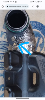

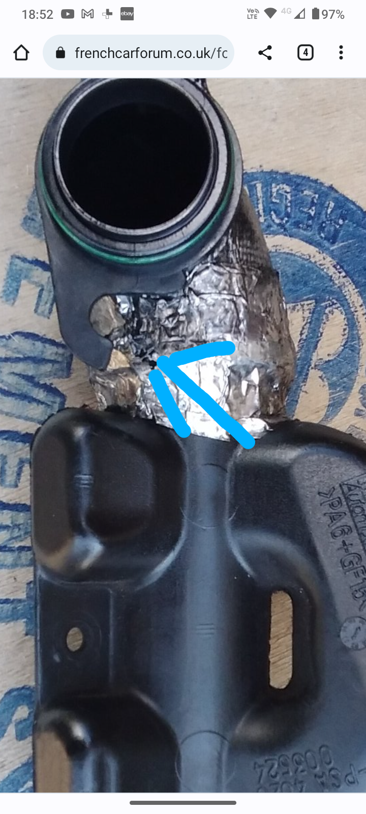

FOUND OUT WHERE THE WHOOSH NOISE COMES FROM
So driving today about 2 miles to go till home , WHOOSH .. and i mean a big WHOOSH !
Pulled over popped the bonnet this pipe in the photo was almost out of the turbo the bolt housing plastic had all broken and the bolt was lose the bonnet copped some nice fine mist of oil stuff so i drove back home 25mph for the last 2 miles refitted washers bolt and new nut plus 2 cable ties for extra support , went for a run all good again, so I'm needing this pipe which I've seen for £55 new on ebay .

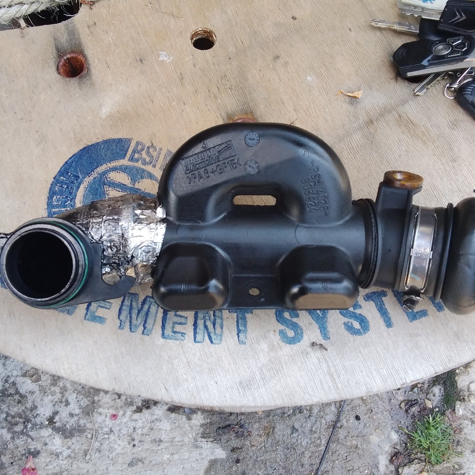

Re: Oil catch can time.
Do you mean this bit?
It's like that as standard.
Should be a wierd bolt: integrated washer, shallow 10mm hex head, on the turbo that secures it. You back it off a couple of turns (remove the one opposite - off the top of that image - completely) hose clip off, pop rubber mount (sat on ball on heat shield bolt) then have to rotate this piece around the axis of the turbo outlet to decouple from this weird bolt
No the other side , this photo was taken the other week when it was off the car, its the one that the bolt goes through.

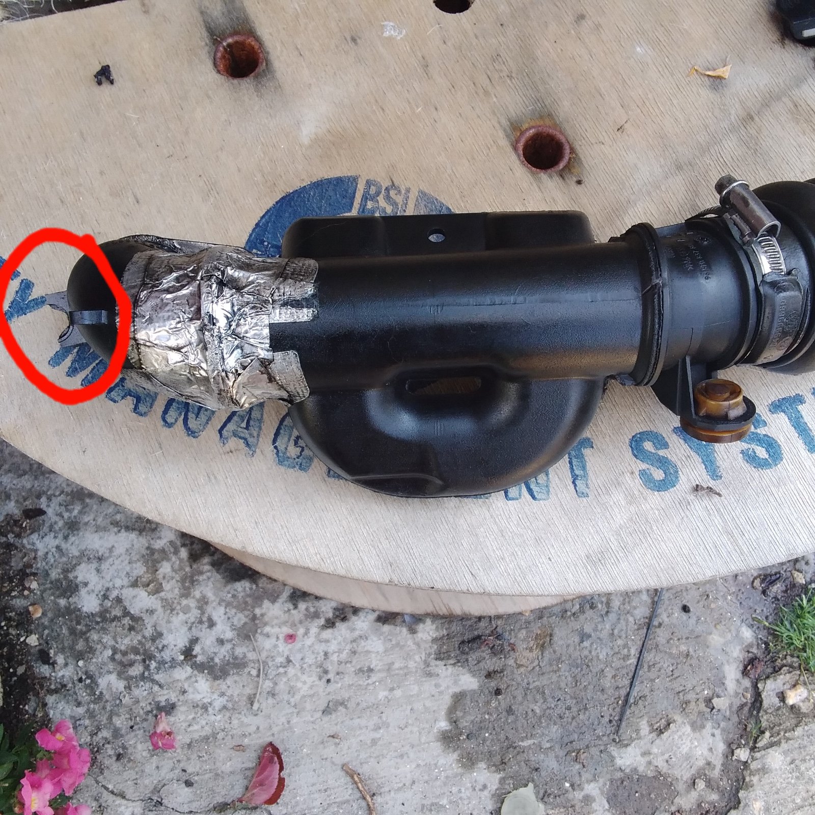

& heres the one i meant to post up
Husky.
Ah yep, that's definitely broken!
How odd for that to give up all of a sudden.
It was cracked when i first got the car last year i guess it was just a matter of time, I've a question regarding the wastegate adjustment on the turbo how or when would you know if it needed adjustment at all ?
