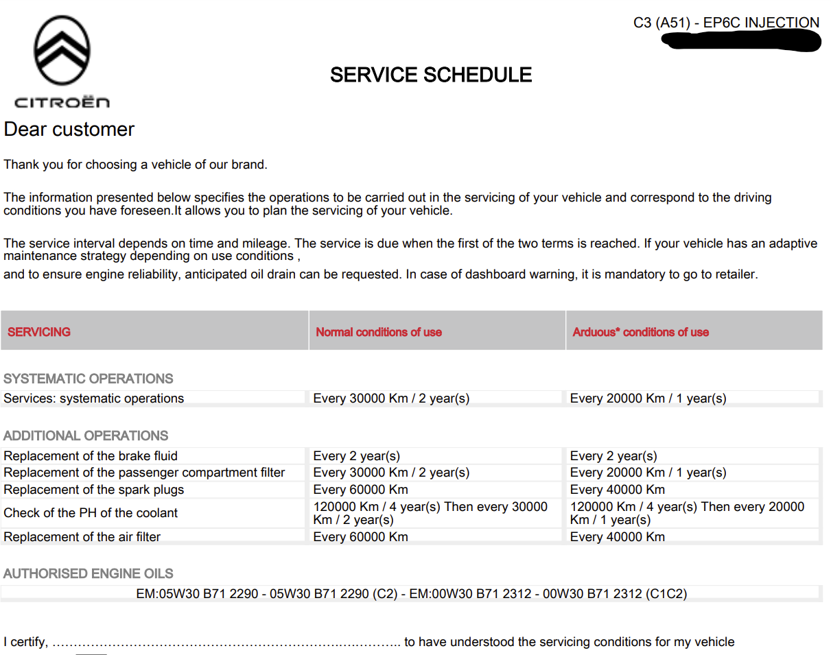

Yes you have a C3 (A51)abyj wrote: 21 Feb 2025, 02:43Could you help me with info on this VIN: VF7**************[VIN obfuscated, can be read by forum staff]. I believe it is also an A51... I'm new to the Citroen brand.PaulC5 wrote: 02 Jan 2025, 11:37 I would not bother with the Haynes 2002 manual, the car is a lot different to yours. The type of grill on the front will show if it is an A51 facelift (phase 2) - compare it to the car pictures on the link I gave. As well as the RTA manuals, if you can get a dvd copy of the Citroen service box this covers all you will need to know to look after your car - have a look on ebay. I would go for the paper (blue cover) copy of the RTA one, whilst in French, the diagrams are good and give torque settings.
I see the Haynes is available (online autofix https://haynes.com/en-gb/citroen/c3/200 ... rol-355679), is the RTA better, or because it's paper? And should I get the DVD as well? Are these available as pdf downloads? My french isn't great...
They are the same. RTA (Revue Technique Automotive) bought Haynes in 2020, so just use the Haynes website for a manual - it will already be in English but will be from RTA.
If you require a build sheet, let me know and I'll provide one for you.

Re: How to identify what model engine is in your Citroen
Thanks Marc, could you share the factory build sheet for this car when you get a moment?
Sorry, going off topic now with the service manual questions, I was initially interested in the engine of this car (the build sheet will answer that and more!). Is the DVD not necessary if I get the online haynes manual as far as you know? With my other non-french car, I have a service sheet that details every component of the car that should be checked at each service, according to the manufacturer, e.g. A or B service every x thousand kms or 1 year. Is this a separate download somewhere?
- x 6945
I can provide you with a factory build sheet, that specifies the build equipment at factory (see below) and I can provide you with the service schedule for your vehicle with the main info:
Build Sheet:
Click to Zoom)
Service Schedule
Note: there's no timing info as you have a timing chain, not a belt.
Build Sheet:
Click to Zoom)
| Vehicle Characteristics | |
| Vehicle family | C3 (A51) |
| AS/RP N° | 12282 CA 2 0593 |
| Warranty Start Date | 31/08/2010 |
| Engine serial number | 10 FHBF 0882891 |
| BER | e2*2007/46*0003*05 |
| P4A | 9665949299 |
| General Information | |
| PRODUCT TYPE | PASSENGER CAR |
| COMMERCIAL MARQUE/COMPONENT TYPE | CITROEN |
| VEHICLE FAMILY | C3 (A51) |
| SILHOUETTE | 5 DOOR SALOON |
| TRIM LEVEL | MEDIUM HIGH |
| ENGINE | EP6C INJECTION |
| TRANSMISSION | 4-SPEED AUTOMATIC GEARBOX |
| PAINT TYPE | METALLIC PAINTWORK |
| BODY COLOUR | EXL - PAINT OBSIDIAN BLACK |
| INTERIOR TRIM TYPE | VELOUR KARL G112 + OMNI F920 ’3N’ |
| UPHOLSTERY COLOUR | "FY" |
| GEARBOX (CHARACTERISTICS) | Auto gearbox AL4 |
| ENGINE (TYPE) | EP TYPE ENGINE |
| OTHER BADGE, " MISC. " | WITHOUT FULLER BADGE |
| BADGE | FAMILY BADGE |
| SPEEDOMETER DRIVE | SPEEDOMETER RATIO 21 X NO |
| Fuel Supply-Engine | |
| FUEL SUPPLY | INJECTION PRIM |
| DIESEL FILTER WATER DETECTOR | WITHOUT DIESEL FILTER WATER DETECTOR |
| FUEL | UNLEADED PETROL 95 QUALITY A/B/E/E+ |
| EMISSIONS STANDARD (ENGINE) | EURO 5 L6 UPPER ENGINE EMISSION CONTROL |
| CAPACITY | 1600 CM3 |
| CATALYTIC CONVERTER | 3-COMPONENT RHODIUM+PLATINUM FILTER CATALYSER |
| OIL COOLER | WATER/OIL EXCHANGER ON GEARBOX |
| OPTIMISATION OF VEHICLE’S CONSUMPTION | NORMAL FUEL CONSUMPTION OPTIMISATION |
| COOLING MOTOR | RADIATOR TH : 18 - 21 DM2 BRAZED ALUMINIUM |
| CRANKCASE GAS CIRCUIT HEATING | W/O HEATER CASING GAS CIRCUIT |
| POWER VARIATION (ENGINE) | PUISSANCE 88 KW 160 NM |
| VALVE PER CYLINDER | 4 |
| EOBD SELF-DIAGNOSIS SYSTEM | "EOBD" AUTO-DIAGNOSTIC WITHOUT ACCELEROMETER |
| DEVICE (ANTIPOLLUTION) | WITHOUT ANTI-POLLUTION DEVICE |
| VEHICLE TECHNICAL DEPOLLUTION | TECHNICAL VEHICLE EMISSION CONTROL EURO 5 |
