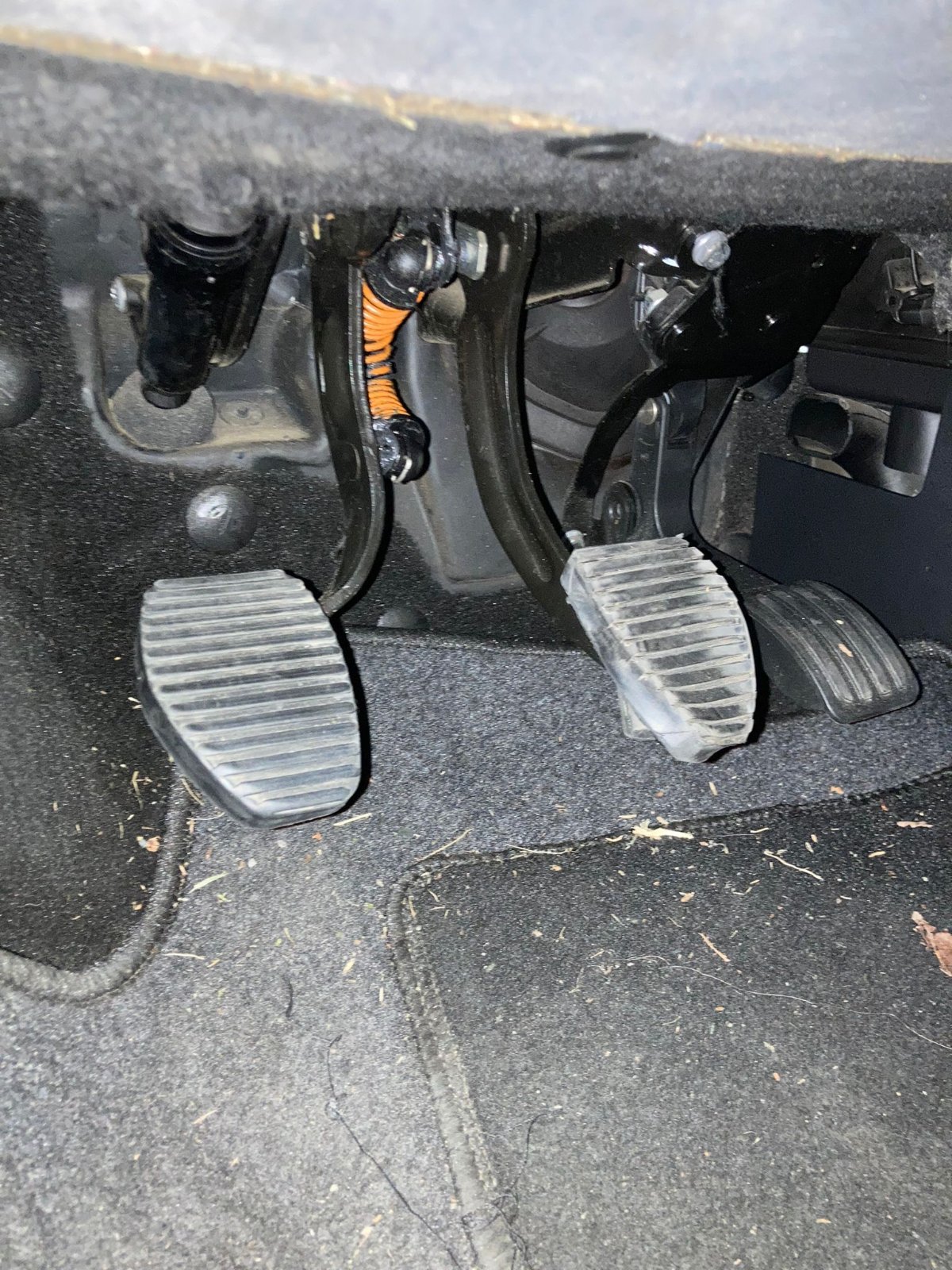

Well that's odd. I'd say to crack like that it's fatigue - the offset nature of the ball joint relative to the pedal flexing that section (minutely) with every operation. Ultimately a crack has propagated across the bracket untill there was insufficient steel left to resist the forces (i.e. the bit left then bent)
I'd have said fatigue failure was normally unusual, so perhaps a contributing factor - e.g. poor machining of you particular pedal - lead to a stress propagation point and started the crack.
Not something I would have thought to check for, and clearly not visible before disassembly on any of the photos loaded previously.
Matt
Matt

We replaced the master and slave clutch cylinder while we were at it. Obviously with no pedal we can't yet bleed it - and have ordered the part for the car model.

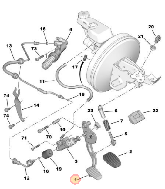

But we are mystified how the spring actually returns the clutch pedal to the starting position - the spring pushes the two pivots apart - not pulls them together.
It's quite different to the configuration that Rp0thejester has - with his the master cylinder is on the same side as the spring - with ours the master is on the opposite side (further away from the brake) and his bracket looks further back towards the engine and makes sense - but we'll see in a few days when the new pedal gets here. Here's hoping...
Again thanks to everyone for the help.

If it's the same as mine (C5 X7) then it goes "over top dead centre" and so pushes up only at the very top of its travel (ie when the pedal is nearly at the top it pulls it up) but for most of its movement it it helping push it down. With my failure the pedal would shoot down to the floor once about quarter of the way into its travel (and same even with the hydraulics disconnected - movement all coming from this spring)
Matt
Matt

Well folks... we finally got it done - put the new pedal in and bled the system until it couldn't be bled anymore and its a totally different feel to the clutch now with the spring operating as it should - as MattBLancs wrote above the spring actually pulls the pedal UP for a very short portion of its travel - otherwise it pushes the pedal DOWN. So now the clutch pedal has the feel of constant resistance throughout its entire range of motion - which I suppose some people might see as a positive.
However bottom line is that gear change is now super smooth and we hope and believe that the job is done - HUGE THANKYOU to the forum members who helped out!
