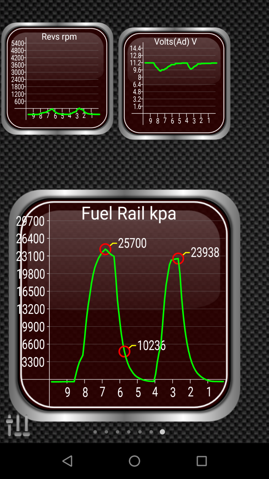

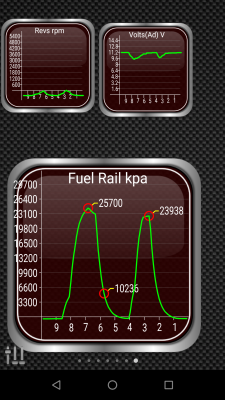

Ok, pretty picture first:
Screenshot of Torque App during a start attempt (X2, hence the two peaks)
Above is from the Torque App on my phone - wondered if a smart phone and eBay OBD2 adapter would have a shorter refresh rate than the (old) Toughbook and Diagbox.
Helpfully the app has a stab at labelling the magnitude of the peaks. Does anyone know what I should be seeing as a minimum fuel pressure?
Diagbox, under Fuel Circuit Information, under Standard Parameter Measurement, under Injection ECU section,
States "Reference Fuel Pressure" and a figure of 0251 Bars. Does this suggest 25700 kPa ( = 257 bar) is above the minimum threshold hence ok for running?
Have the usual fraction of a second "cough" momentary running still.

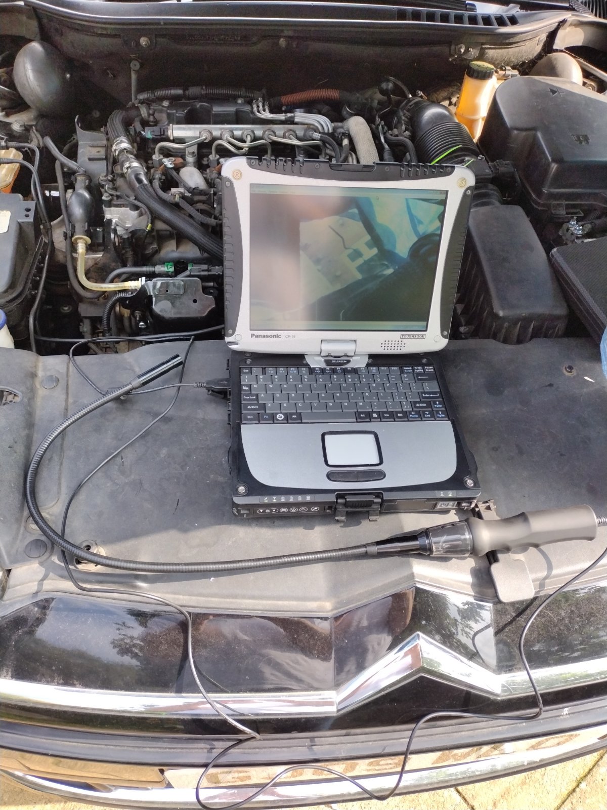

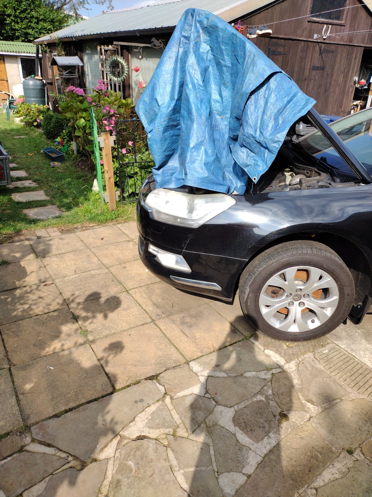

Tarp, to give a chance of actually seeing the screen in bright sunshine!
Cheap borescope and the old Toughbook
Those of a nervous disposition my be relieved to hear that having had overnight to think about it, I have very firmly decided that this shall remain true to its intended purpose - a borescope - and so the images that follow are of the car's internals rather than my own! :rofl2:

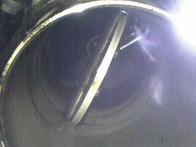

Anti shudder valve = open
Engine and ignition off at present. Anti shudder valve open.

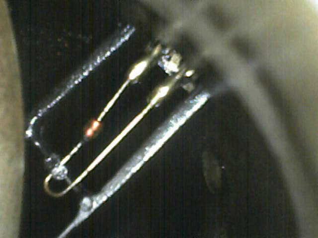

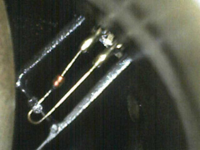

Beyond valve is IAT sensor
Here's the inlet air temperature sensor visible beyond the valve. Beyond that we approach the EGR connection and so all turns black and grimy. Not easy to get any meaningful imagery from that point onwards. Instigates a desire to remove the inlet and clean it out, but that's another day's job when I've nowt else to do.

Hmmmm, to bottom out the strangler theory, now had some help available to turn the key. So I manned the borescope whilst it was being turned over.
Valve doesn't move, stays fully open when ignition turned on and when engine turned over. Even following a "cough" valve still doesn't move (hypothesis: cough insufficient to class as "engine running" hence no need to shut the valve when letting go of the key)

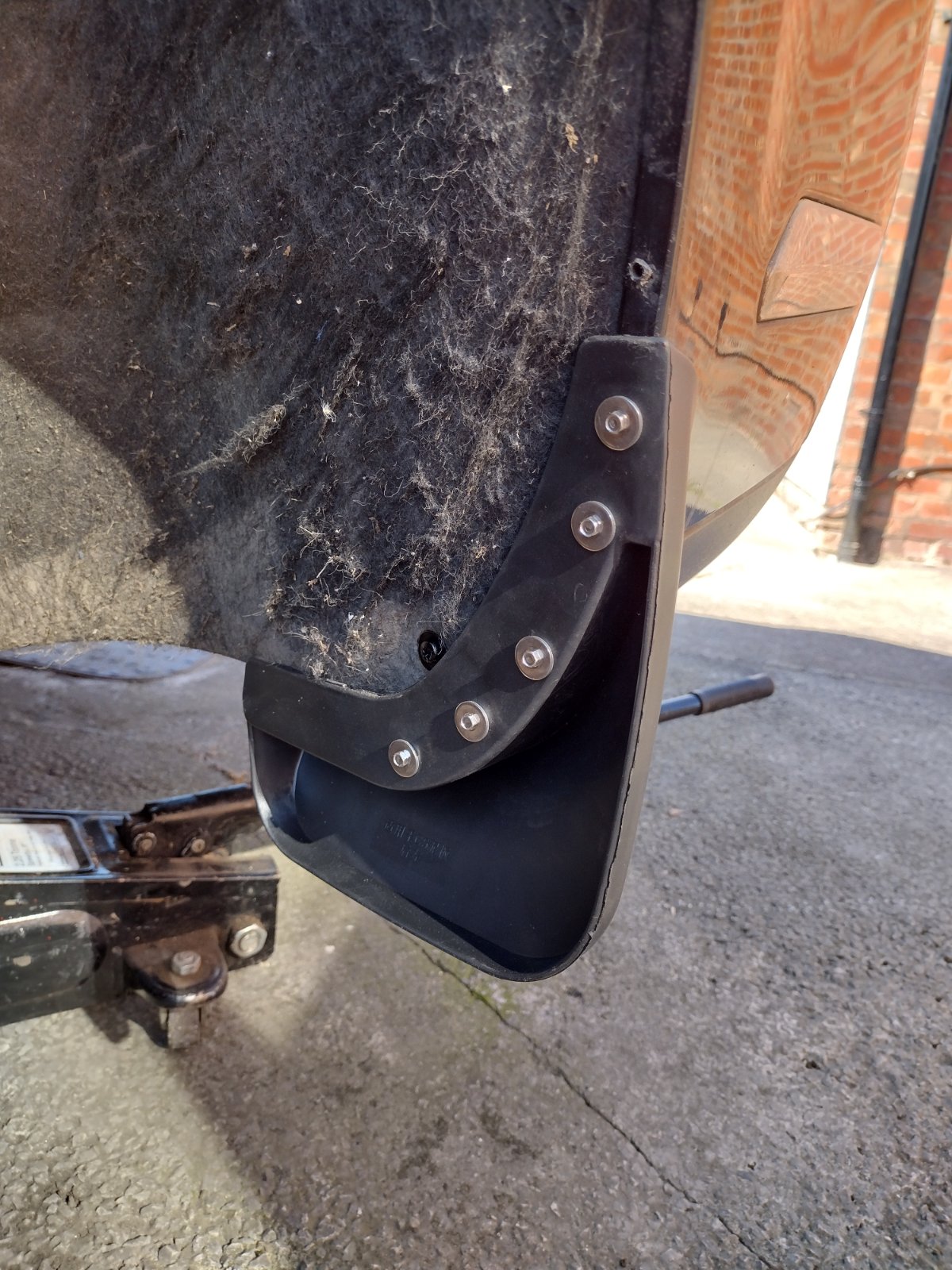

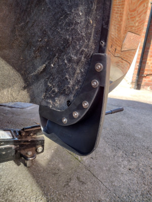

Maybe a little overboard with the fixings, but is only into the plastic
Cheap stainless hex head self tappers, M4 stainless penny washers, cardboard template and a tendancy to over complicate things....

I hope that's the rear of the car, if its the front they gunna blow right off
Posts: 5355
Joined: 25 Apr 2022, 09:03
x 2361
Re: C5 X7 no start (or only runs for fraction of a second)
Unread post by MattBLancs »

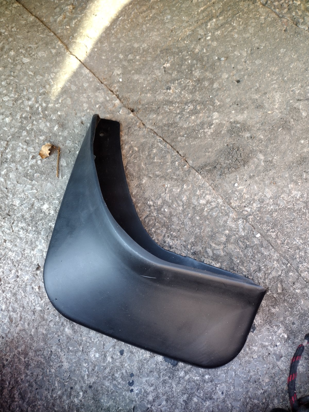

Yes, rear mudflaps pictured. The old one (original fitment from new judging by the date stamp in the plastic) is quite a bit taller. That sat on just 3 fixings - two into the plastic edge of the bumper (as per the new ones, but different fixing positions - one of the redundant holes is visible above the new flap) and a third on the underside of the bumper. New ones omit this one.
Front ones are two fixings, shared position with wheel arch liner (which has the female plastic fitting that receives the screw) and also passed through the end of the plastic sill cover.
The third fixing of the old flap = into the underside of the sill cover.
New ones have a third fixing on top edge of the flap - same plane as the other two. This would require a new hole drilling into the steel wing, which I don't fancy doing really. There's only a tiny edge of the steel - if there was more to play with I'd fit a Rivnut and a set screw.
Obviously at the moment is little chance of them being blown off as don't think I can get much speed up pushing it by hand! :-D
