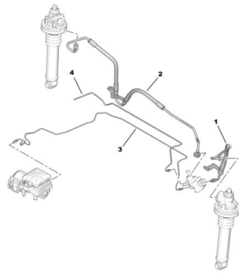

As for the pipes - this is the front supply piping, but unfortunately pipe (3) part: 5270VQ is no longer available from Citroen.
If it's pipe (4) 5270VT, this is available at present £35.03 inc. VAT.

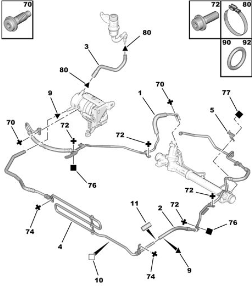

Hi Marc, sorry it's the pipe for the PAS. It runs to or from the PAS pump back along the RH side above the subframe and takes a dip under the RH driveshaft to then join the steering rack at the pinion. It is a pipe that has flexible sections and steel sections and it's a larger diameter pipe, at least 10mm. It has a lot of surface rust on the metal sections and someone has completely coated this with sealant right back to the steering rack. I think that actually helped increase its life. It doesnt however look too long for this world!
It actually seems like a feed to the pinion or a return back to the PAS pump which is huge by the way ha

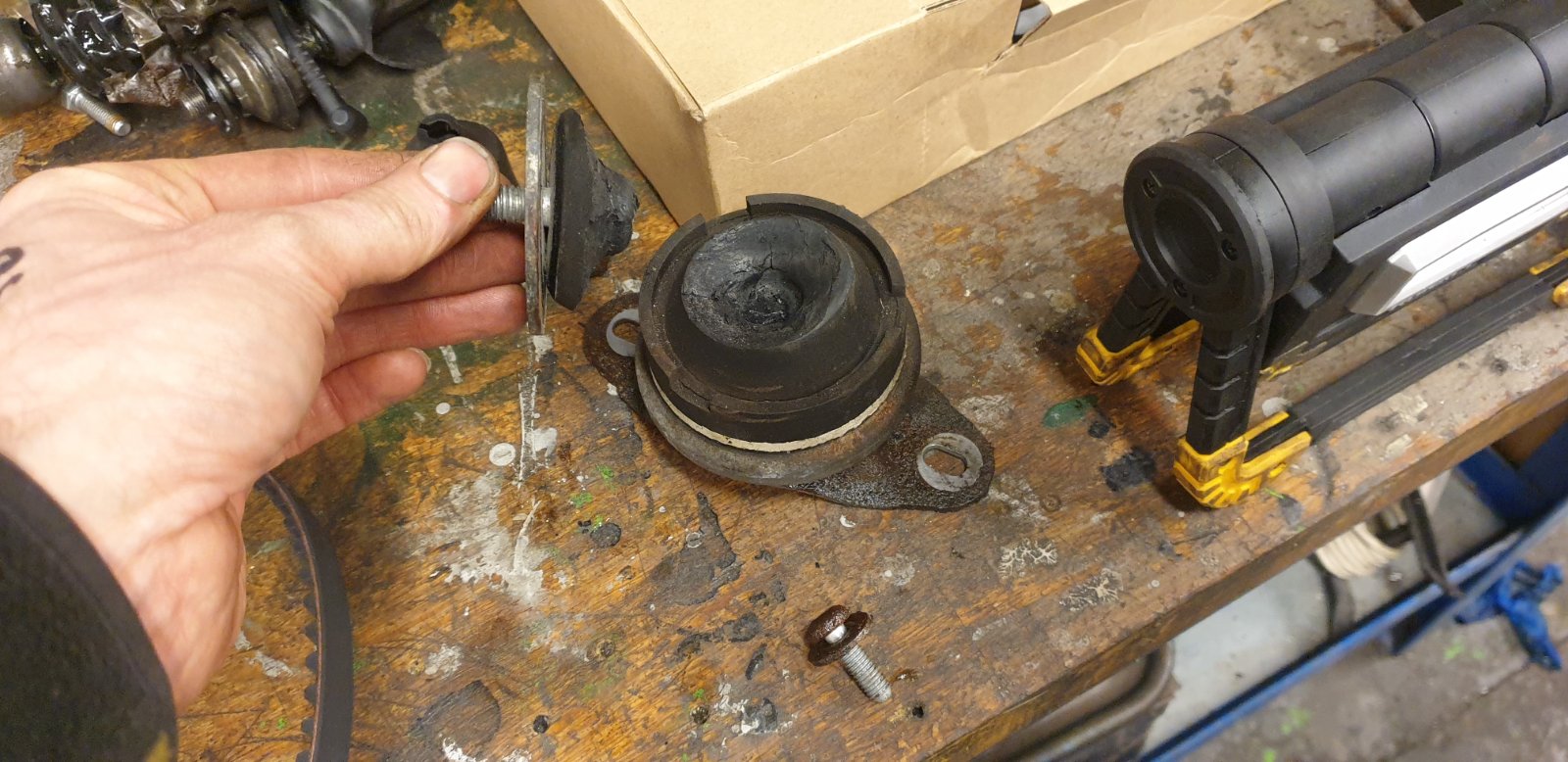

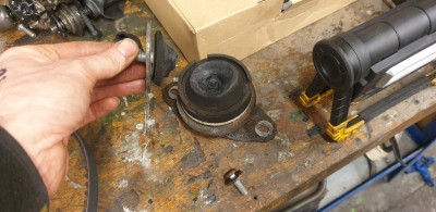

Here's a shot of the RH engine mount as I discovered it...

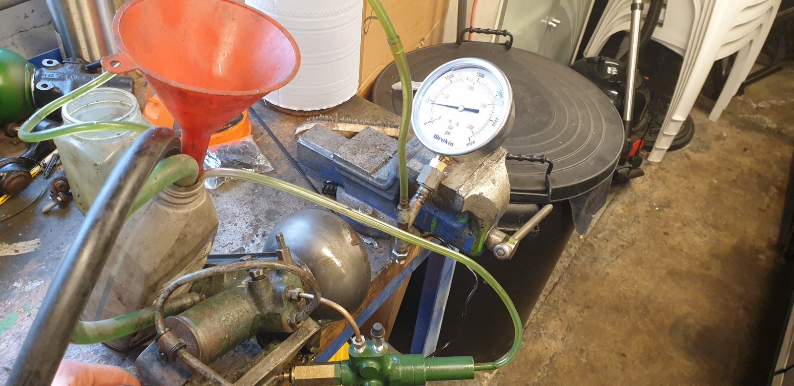

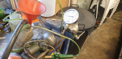

I had the RH front sphere off to allow better access for the cambelt job and today I decided to see if this sphere (which actually rattles when I shake it) has any pressure left in it. I got all excited when I spotted the Citroen logos on them. Oh! genuine spheres! Ah, they'll be the factory fit ones then.... sphere tester and it shows that the sphere has 25 bar remaining out of (I believe) 50. So it has lost half its pressure in about 13 years.
Looks like I'm going to have to change the lot

Good grief what an arrangement! I think it is item 1. in the drawing. Is it usual for parts to be unavailable for such a recent car?GiveMeABreak wrote: 12 Dec 2021, 20:27 Let me know which one - BUT:
Items (10 & (2) are no longer available Graeme.

That pipe number 10 is ridiculous! what's that all about? I think I was looking at parts of that while underneath doing a closer inspection. The mind boggles as to why they chose to route these low down through each wheel arch... and make them out of terrible steel. Maybe everything in the C5 steering is supposed to dissolve. I hope the steering wheel doesn't dissolve, I like it, it's cool the fixed center does not get old!

Do we know anything about these pipes? are these the pressure feed and return to the steering pinion? I wonder if they can be remade. I replaced the front L and R 10mm suspension pipes for the xantia and apart from the end union nuts being broken the full length, 10mm steel pipe and crimped flex sections is similar to these. I wonder if bits can be spliced together. If the pressure used isn't as high as in the suspension for example.
Ah, who knows. I wonder if new steel sections could be brazen in or something.
Cripes, I wonder if there are any of these pipes in breakers.
