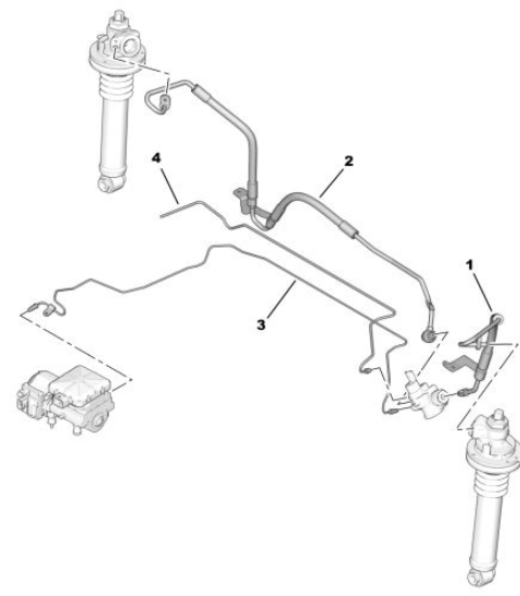

As for the pipes - this is the front supply piping, but unfortunately pipe (3) part: 5270VQ is no longer available from Citroen.
If it's pipe (4) 5270VT, this is available at present £35.03 inc. VAT.
