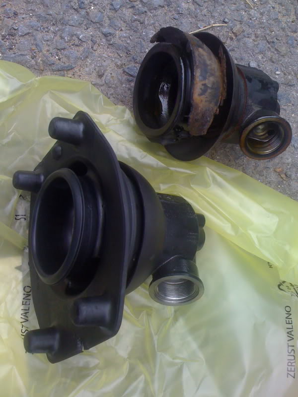

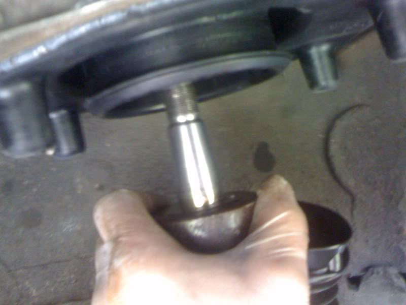

The gaiter fits over a ring that is part of the strut top mount:

xantia_v6 wrote: 18 Nov 2021, 18:52 The gaiter fits over a ring that is part of the strut top mount:
Oh dear! Then it seems that black rubber down stand on the mount has totally failed!!!!
How do Kingas ones match the originals. Are they exact would you happen to know?

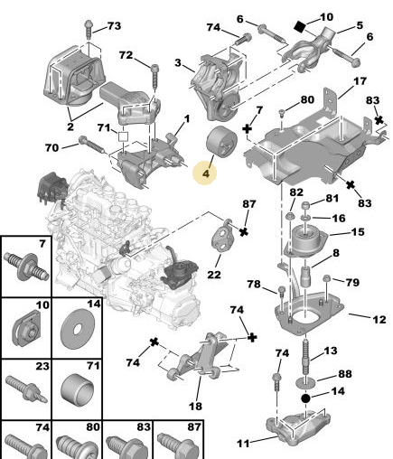

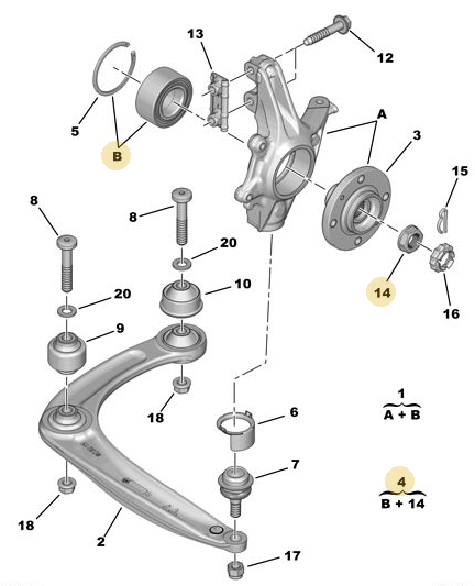

GiveMeABreak wrote: 14 Jun 2021, 18:43 Ok
Wheel Hub Bearing
if Item (4) which is (B + (14)), which is the Front Hub Bearing, then part 1606623580 (£118.51)
Cheaper PSA alternative Part No: 1623948880 @ £41.60
Engine Mount
Item (4) part no: 180944 @ £51.02
If anything else, let me know Colin.
What model would this cover ? Reason i ask , ive done 2 bearings on my 206cc 1.6hdi both have failed
Might be fake parts having a issue at the mo with ebay seller, whats the correct torque setting for the main hub nut im seeing on the net 96nm up to 350nm, ive got a slight vibration when slowing down not brakes either there all new.

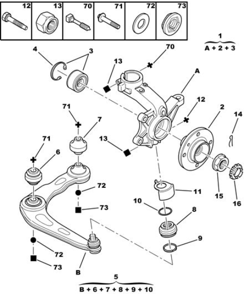

Hi, its the front hub nut torque im after. 36MM Nut , very conflicting on the net about the torque
:-D
x 6946
Re: Citroen and Peugeot Parts Requests
Here you go:
The Wheel Hub (2) is part: 330785
The Hub Bearing (3) is
OEM Original: 335016 £144.01
Peugeot Approved Cheaper alternative: 1681934780 £27.23
Prices as of today from Peugeot inc. VAT.
The Driveshaft Nut is (M24X150) 32.5 da.Nm

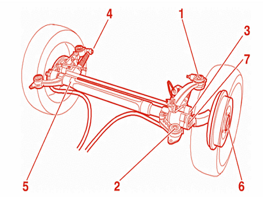

Have you anythimg about the rear hub ? Mine has the magnetic ring with bearing fitted all in one part numbers and the torque of the bearing hub nut too, dont think mine are tight enough on the rear.
:-D
x 6946
Here's the torque settings for the rear suspension
ReferenceDesignationdaNm
(1)Rear flexible mounting to body fastening11
(2)Front flexible mounting to body fastening11
(3)Torsion bar (Face and threads greased )2.0
(4)Rear shock absorber fastening to yoke (Face and threads greased )7.0
(5)Rear shock absorber fastening to arm15
(6)Rear hub fastener (Face and threads greased )20
(7)Anti-roll bar lever bolt3.5
