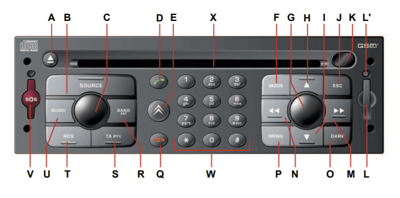

Right, ignore my last post! This is Traffic Announcements. It can be extremely annoying on earlier systems, so...
With the car running and the system operational, press the TA / PTY button once to turn this OFF. The button is shown below as 'S' on the diagram:
Please tell me this has fixed the issue Peter.

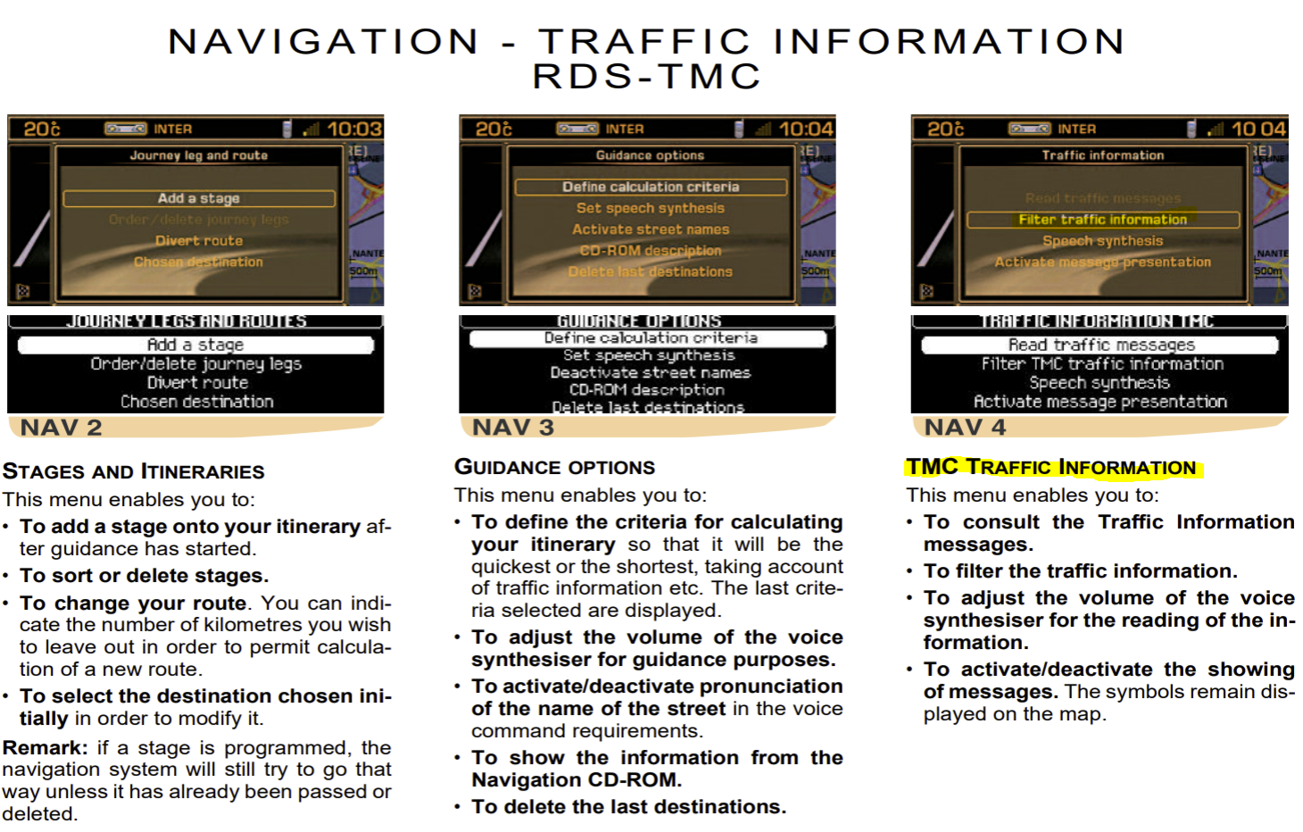

Ok, so next get to the navigation menu and look for this option in the manual:
Click Image to Zoom
This is where you set the filters and turn on or off the message display and set the station for TMC and the filters. The third screen specifically.
This is the only other thing it can be - the filter that is currently set is probably too wide an area and is therefore bringing up messages from all over the area instead of on a per route basis. You should adjust the filter to limit the information to a small area around the vehicle. You should have several options to select the geographic filters.
You can also find the setting to turn off the message display.

You are a genius Marc. The problem was largely down to my stupidity in not knowing there was a traffic information menu. I had difficulty selecting it as every time I tried the traffic info covered it up, I kept deleting it until I had a long enough window to access it. I found amongst other things a couple of tick boxes regarding the storing of info, I unticked them and it all dissapeared.
