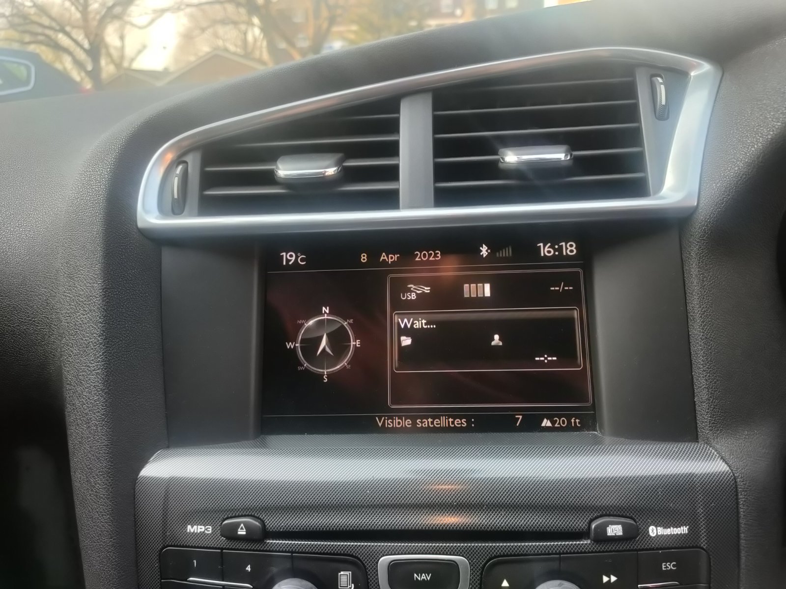

Not sure if this going well or not but this is what screen is showing

Re: Firmware/Map update advice needed
Well no luck after 55 minutes still the same so decided to switch off.
Everything working as it was so absolutely nothing has happened.
I must be doing something wrong but what i do not know

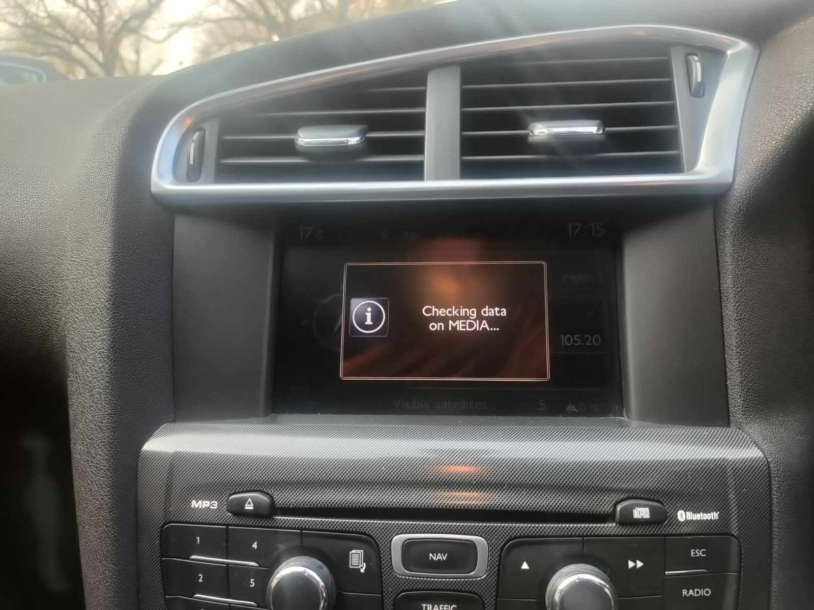

Ok I have some sort of success gone back to see what i had done in the various previous attempts and decided i messed up as usual
Sometimes i got checking data on media( Media corrupt ) others just logo and blank screen as if it was rebooting and then the above Wait screen.
So went for a higher firmware 2.37 download and the Wait screen was from that attempt. Decided to check USB and had the main folder containing the files on it so moved all files out formatted USB and put just the files and not the folder on it.
