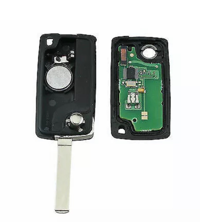

What shape of key is it, Mike? Do you know if the immobiliser chip is on the board or in a separate capsule? If they are separate you might be able to get a key from ebay (or the scrap yard), transfer the CL board over, and get it paired to the C3.

Hell Razor5543 wrote: 14 Feb 2021, 07:35 What shape of key is it, Mike? Do you know if the immobiliser chip is on the board or in a separate capsule? If they are separate you might be able to get a key from ebay (or the scrap yard), transfer the CL board over, and get it paired to the C3.
It’s one of these, removable electronics..
Posts: 14314
x 3296
Re: Replacement Key Info Required
But that little coil in the top left looks like the immobiliser chip, so probably not transferable after it has been coded to a vehicle. Drat!

Does anybody know if the immobiliser chip is separate (possibly in the head of the pivoting part) or if it is on the circuit board?
